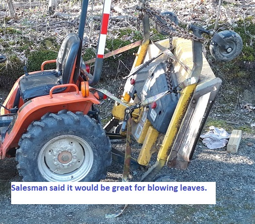

I don't worry too much about the brand, just the quality of the implement & the best match for the tractor, 2nd hand often works out better value than new when seeking HD (as the saying goes they sure don't build them like they used to):
- run a no name brand 3ft bush hog that's about 30yrs old on a almost new Kubota BX23s (as good as the BX is I think the bush hog will still outlast it, thanks to annual coating of Penetrol to preserve the steel)
- as per photo run this 7ft defunct brand bush hog purchased c.20yrs ago 2nd hand on this tractor, the implement is super heavy duty weighs upwards of 1.3ton with chain guards fitted.Both heavy duty & used to their limits, but will still be going strong for at least another 30yrs...
/ Rotary cutter preference #74
Look at that little ripper! (y) :cool:
