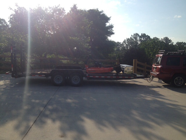

And while it's not the greatest here's a pic of the new "toy":
They're longer than I thought..... With the tractor, FEL and brush hog my 18' + 2' trailer is going to be filled up quick.
