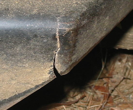

I agree with you. I don't think it has to do with the float position or lack thereof. It's the high push point from the PT to the deck. A better explanation is like pushing a grocery cart. It goes along well on a flat hard surface. Once the going gets tough (ie: imagine pushing a grocery cart through beach sand), the overturning load gets high. With the bushhog, when the going gets tough (pushing through heavy brush etc), the PT pushes to meet this resistance. The overturning load will heavily load the front castors, and deck structure in between the push point and the castors.

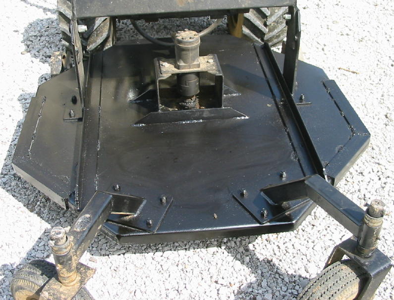

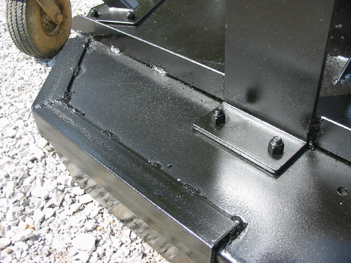

It looks like the welder understood the load points and placed the stiffners in the right locations. Let us know how this holds up after time.

I have looked carefully at my rotary cutter and thought about Duane's analysis. I think he is exactly right about the bending/cracking problem. The high connect point provides a powerful lever arm for bending the deck when you try to push the rotary cutter into saplings, bushes, etc. Terry at Power Trac commented to me that the rotary cutter deck does not carry much weight and that is true. However, if you multiply a typical pushing force (mowing saplings, etc.) times the distance from the attach plate connect point to the connect point on the deck, you will find that the deck has a large bending torque applied to it. To make matters worse pt has the connection to the deck near the center where the deck is not as stiff as on the edges. (The finish mower has a shorter lever arm and has the connections to the deck near the edges where the deck is stiffer. ) A possible fix by Power Trac would be to lower the height of the attach plate connection and move the connections on the deck itself out near the edges. For those of us with the existing 4 ft rotary cutter, we either have to be very careful about pushing into saplings, brush, etc., or else add some kind of reinforcement to the deck such as angle iron bracing. I appreciate all the thought and comments from the pt forum folks on this problem. I will let you know how my "ruggedized" rotary cutter holds up. Ken in Mississippi

i think a brace from each side of the bracket at the highest point on each side where you attach to. down to the square tubing on the front caster wheels would stop the flex.

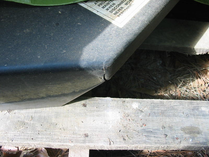

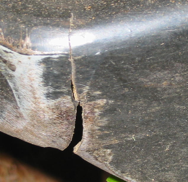

After seeing your cracks, I ran some numbers. The maximum moment created in the deck from the maximum push capability and the high attachment point is close to the allowable for the material in a static case. Add the dynamics of impact and operation, well you demonstrated what happens. My quess is that the flexing cracked your side skirt, and once you lost this vertical stiffner, your deck bent. The front to back angles add alot of stiffness (as well as Johara1s braces). If you are using your machine in heavy stuff on rough ground, it would be wise to add stiffness, or frequently inspect the side skirts for cracking.
