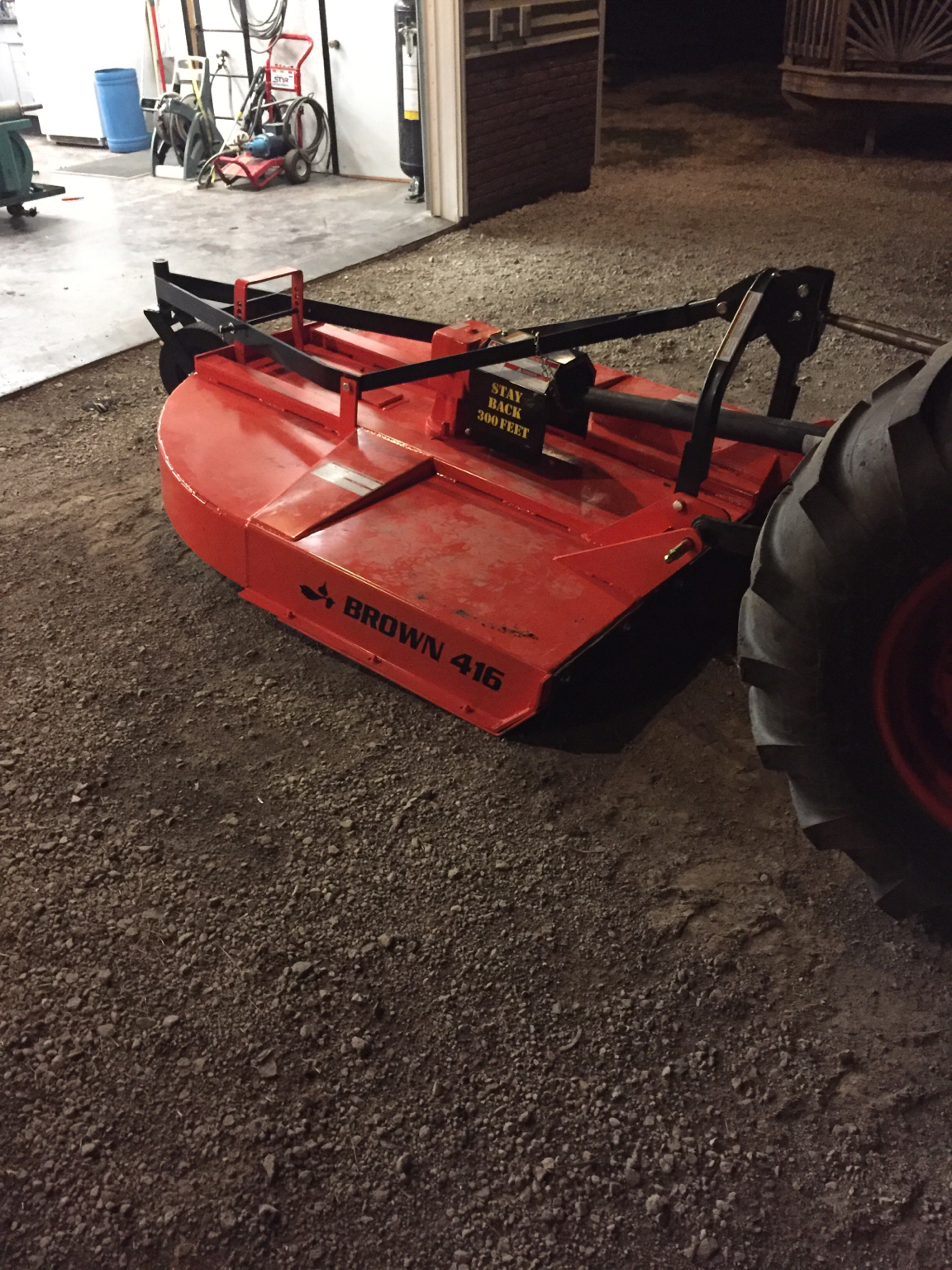

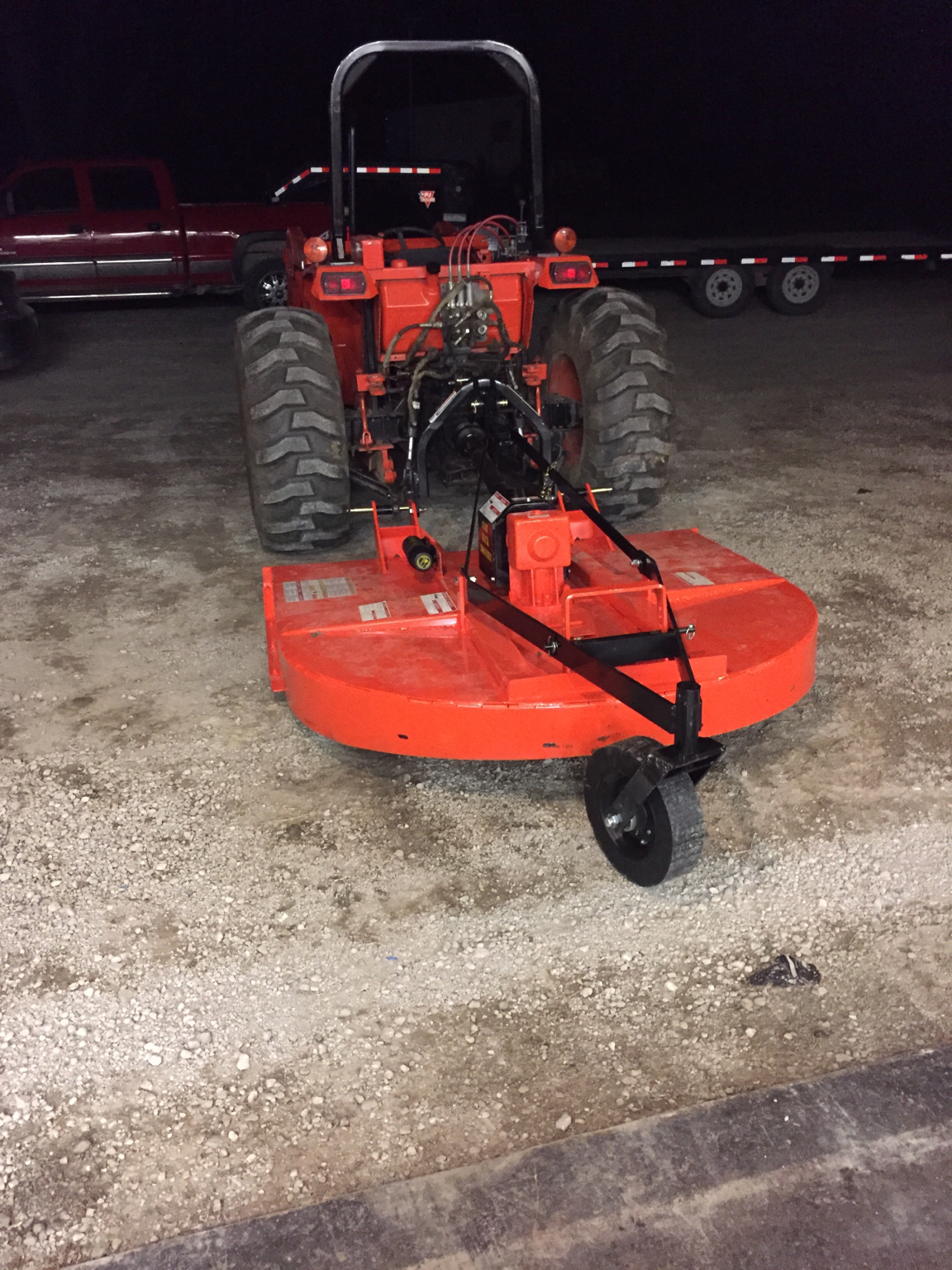

Got my new Brown 416 cutter last week. This thing is a beast! It hasn't stopped raining here in Iowa since it came in, so I haven't used it much yet. I did run it a little Friday afternoon at my dads place and I was mowing over 3/4" to 1-1/4" saplings and bushes and it didn't shake or stumble a bit. Can't wait to get it over to my hunting property to really give it a work out. Thanks everyone for the advise, I'm really glad I went with the heavier duty cutter and also glad I stuck with the 6' cutter instead of the 7'. My tractor may have turned the 7' cutter, but I doubt it would have lifted it. The 6' cutter is a load (1200lbs).

Congrats on the new tool. Hope you get many, many years of service from it. Definitely looks well built!!!!!
   / Rotary Cutter Advise #27
Love the looks of those Browns. Nice choice. You doing chains or rubber guard on it?

The way I read the Brown website the brown 416 is a pto 1000 rpm machine. Is your tractor 1000 rpm at pto? The 540 rpm machines are double the price.
I guess it doesn't come right and say 540 pto on the website, but it does have a 1:1.5 gear box ratio which puts the blade speed at 15,260 ft/min with 540 pto. That puts it right around the same blade speed as the bush hog and land pride comparable models.
