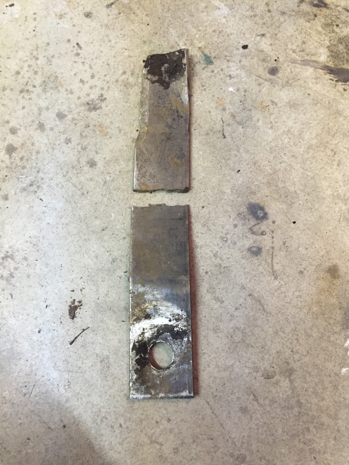

I absolutely love it. I don't have any complaints, it's well built and keeps on working, I really beat on it pretty bad too and use it for more than it's designed.
I don't know how much different it is than the other makes of similar build though, I imagine they are all very similar, but I really do like the Brown company.
I can't say how a 7' would work as I've never used one, but I don't think it would be as good as the 6' as far as physical size goes. The 6' is a good match and very heavy, I might be a little concerned about stresses on my top link with more weight sticking farther back. Not to mention it would be a lot less maneuverable, not an issue with fields, but in the woods it's a hinderance.
I'd actually like a heavy duty 5' model like
The 600 series but the smallest they make is a 6'.
The only problems I've had is I've bent the sheet metal in the back from backing in to large diameter saplings too aggressively. I put a chain on it and pull it back out to "normal" with the other end of the chain wrapped around a tree.
Also, I broke a blade on my last job with it last fall. They were the original blades and the mower is pretty old, so I wasn't too surprised. I bolted the new blades on and finished the job.
I absolutely recommend the Brown cutters. Someday I hope to have a Brown Tree Saw, just waiting for the right job to come along!

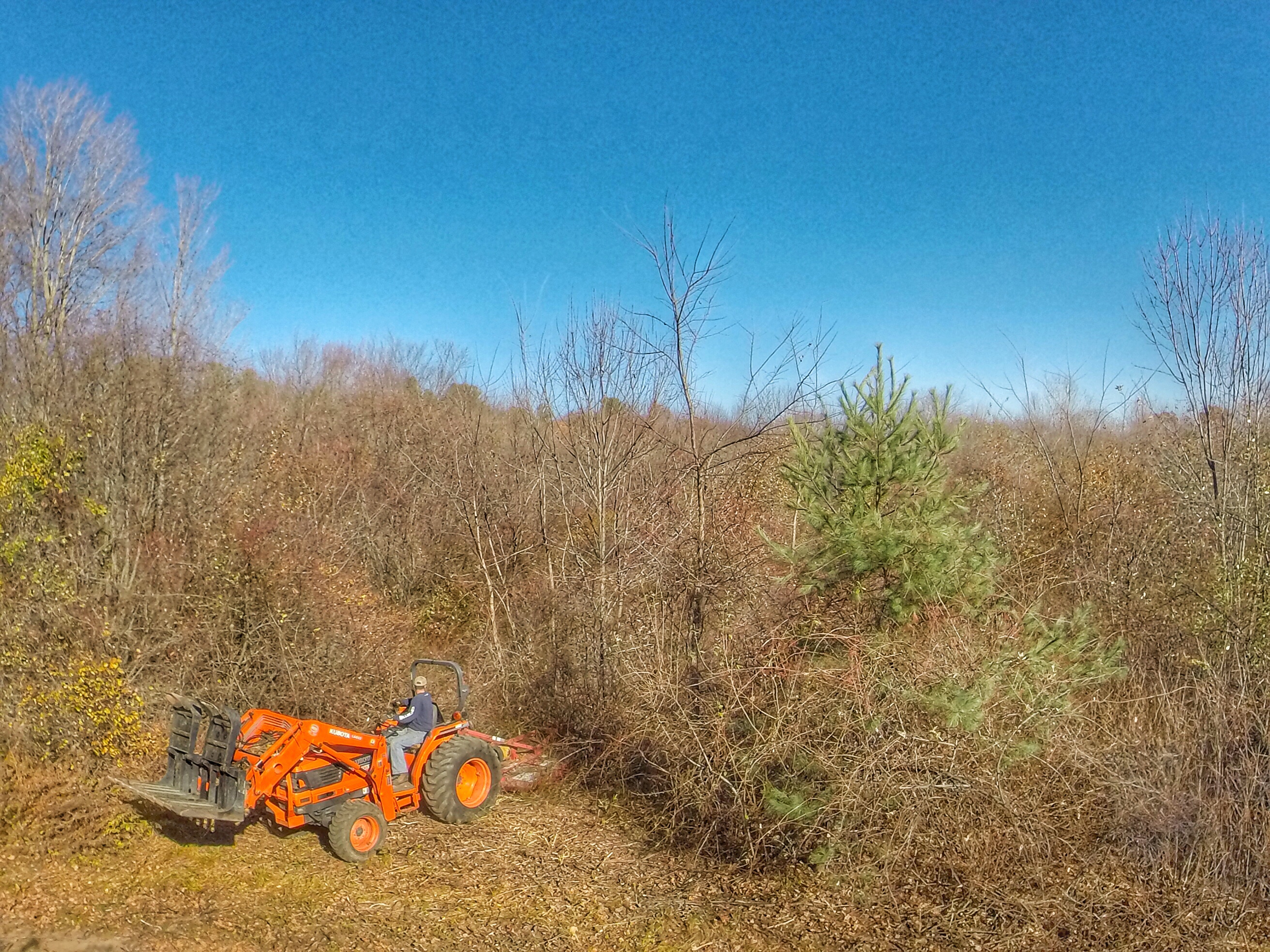

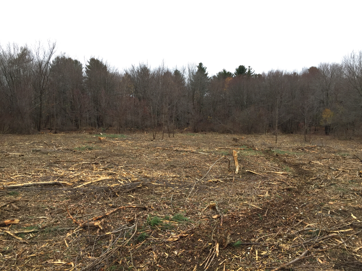

How did you get that cleaned up without stubbing a tire? I believe my tractor got a flat with just me looking at the picture. Similar to what I used my cutter for the last couple years.
