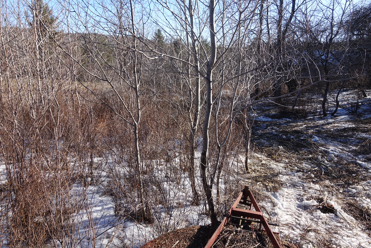

Here's another thought. Many cutters will state "Capacity: 3" diameter" or whatever. Because the blade is enclosed under the deck, you must get the 3" diameter material under the deck where the blade is spinning. Do you think this means the cutter can hack up a piece of tree trunk or a branch 3 inches in diameter just laying on the ground? Or does this mean the cutter has a frame, hitch and deck strong enough for you to plow over a 3" sapling, bend it over, shear it off at ground level and shred it into small pieces?
Think of the process this way: You are backing the cutter into a mess of brush and saplings one of which is 3" in diameter. The top edge of the rotary cutter is 10" off the ground. Imagine the amount of force you'd have to apply to a tree this size 10" off the dirt to get it to bend over sufficiently to get it into the cut zone. First off your tractor has to have the guts to apply the proper amount of force, the cutter has to be heavy enough to not just rise up the trunk and skin off some bark, and the blades and blade carrier have to have enough momentum or inertia (stored up energy) to hack the tree off and shred the remains.
I run a 5' King Kutter that is about 30 years old with the Farmall C and can safely and easily attack 1 1/2"-2" saplings, oak, sassafras, wild honeysuckle. Anything bigger when I back over it, the cutter rides up the trunk and more or less pops it partially out of the ground. I can drive over them forwards as well due to the 24" ground clearance and the fact that the massive rear axle housing will bend them over sufficiently so they will glide under the front edge of the cutter and be shredded.
Bottom line is get something with enough beef so your tractor won't tear it up when attacking large brush.

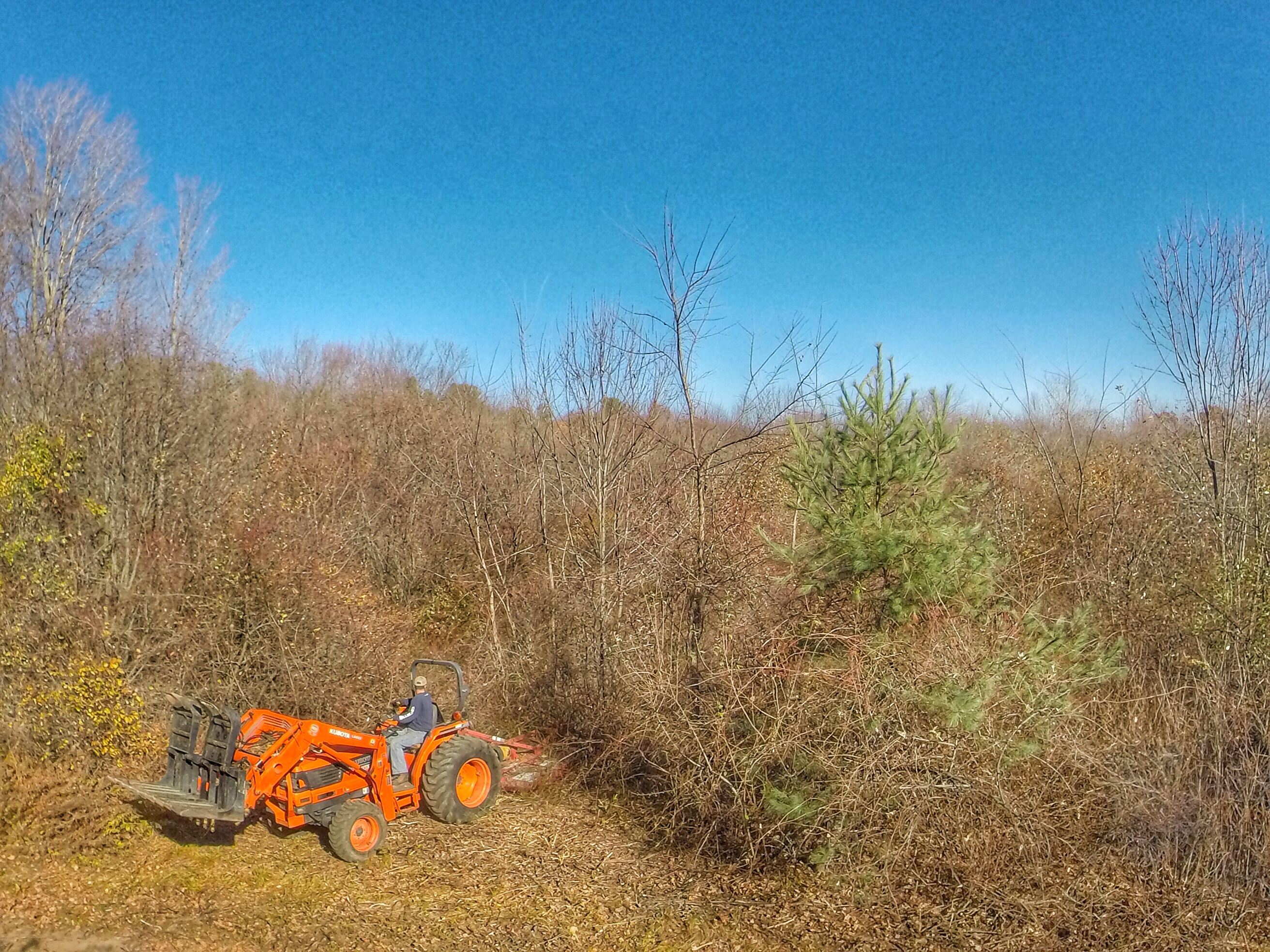

The biggest difference you'll see 'power' wise, is that the medium duty cutters like the BH26 and RCR2672, will take more of your PTO power to GET them turning. Once the blades are spinning, it won't make such a difference regarding needing more PTO power to run the medium duty over the light duty. There isn't a direct relationship between power required on the heavier cutter though. The heavier cutters have more mass in their blades, which translates to more force and momentum when hitting something large, so although a lighter blade will spin easier, it will also slow down easier when hitting something, where the heavier blade will want to continue spinning and use momentum to shatter through a sapling.
Power wise, you will have no problem at all with the medium duty cutter. The biggest difference you'll see is that the medium duty cutters will actually last, and not bend and crumple when getting into heavy brush. I had a light duty cutter and very quickly bent and mangled it very easy with my mere 39PTP hp. I upgraded to a medium duty Brown 472 cutter, similar to the other medium duty ones you are looking at, and although not bullet proof, they will easily take down heavier brush all day long.
I don't use my rotary mower at all for nice field mowing, it's all heavy brush and field reclamation work. As mentioned, the light duty mowers will not stand up to that.
With 42PTO HP you will easily operate either of the mowers you asked about.

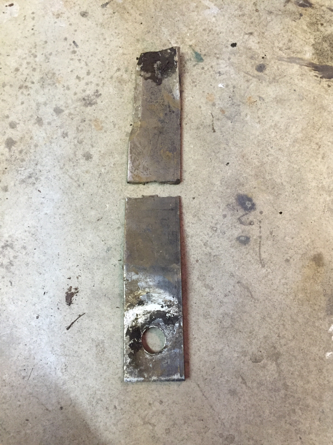

I have a similar tractor(L4240 Kubota)and a six ft.Landpride RCF 2072,I would not run over 3-4" trees to cut with my machine.You can't back into them either,it will just lift the cutter.Unless you amour up your under-carriage you are asking for damage.Cutter has been good(broke one blade on a rock),make sure your slip clutch is serviced every year.
