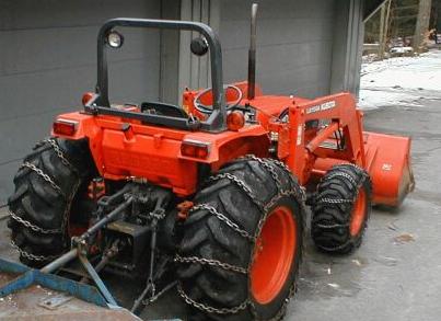

At the risk of the wrath of the safety police, the rigid one could be shortened enough to go in your doors. I did that to mine years ago and it was still way better than none, and also better than a folding one left down, which I'll bet happens often. Besides a shorter ROPS makes the tractor look fast.:laughing:
Yeooow, that does look nice.."she says my tractor looks sexxy"?
As long as the ROPS is a few inches above the operator's head, it'll probably be safe enough.
As far as "and also better than a folding one left down, which I'll bet happens often"...yep...just look at a number of pictures posted on TBN.
