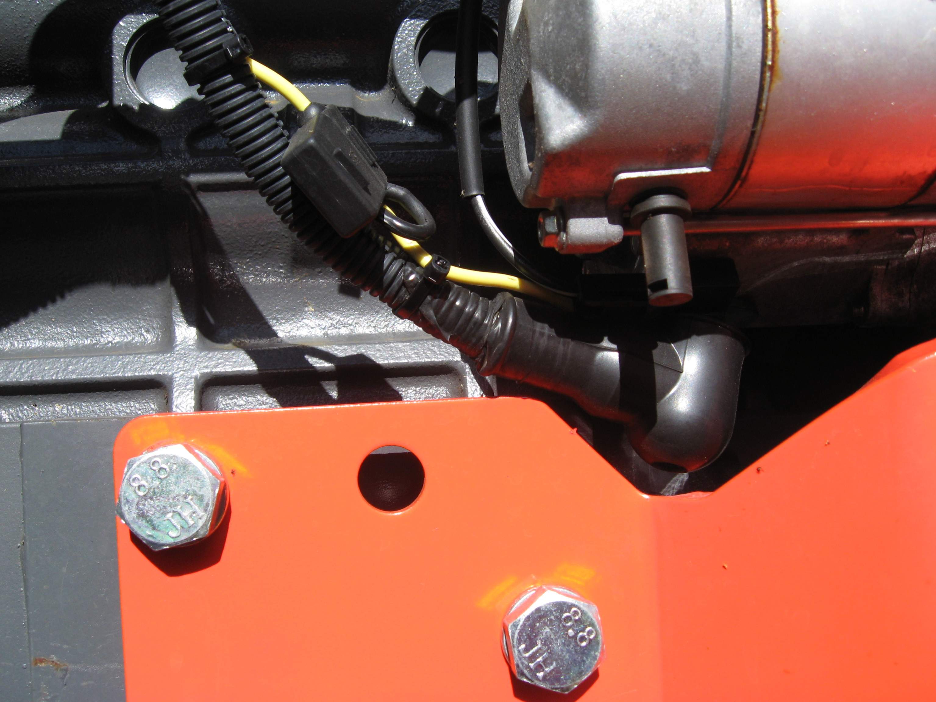

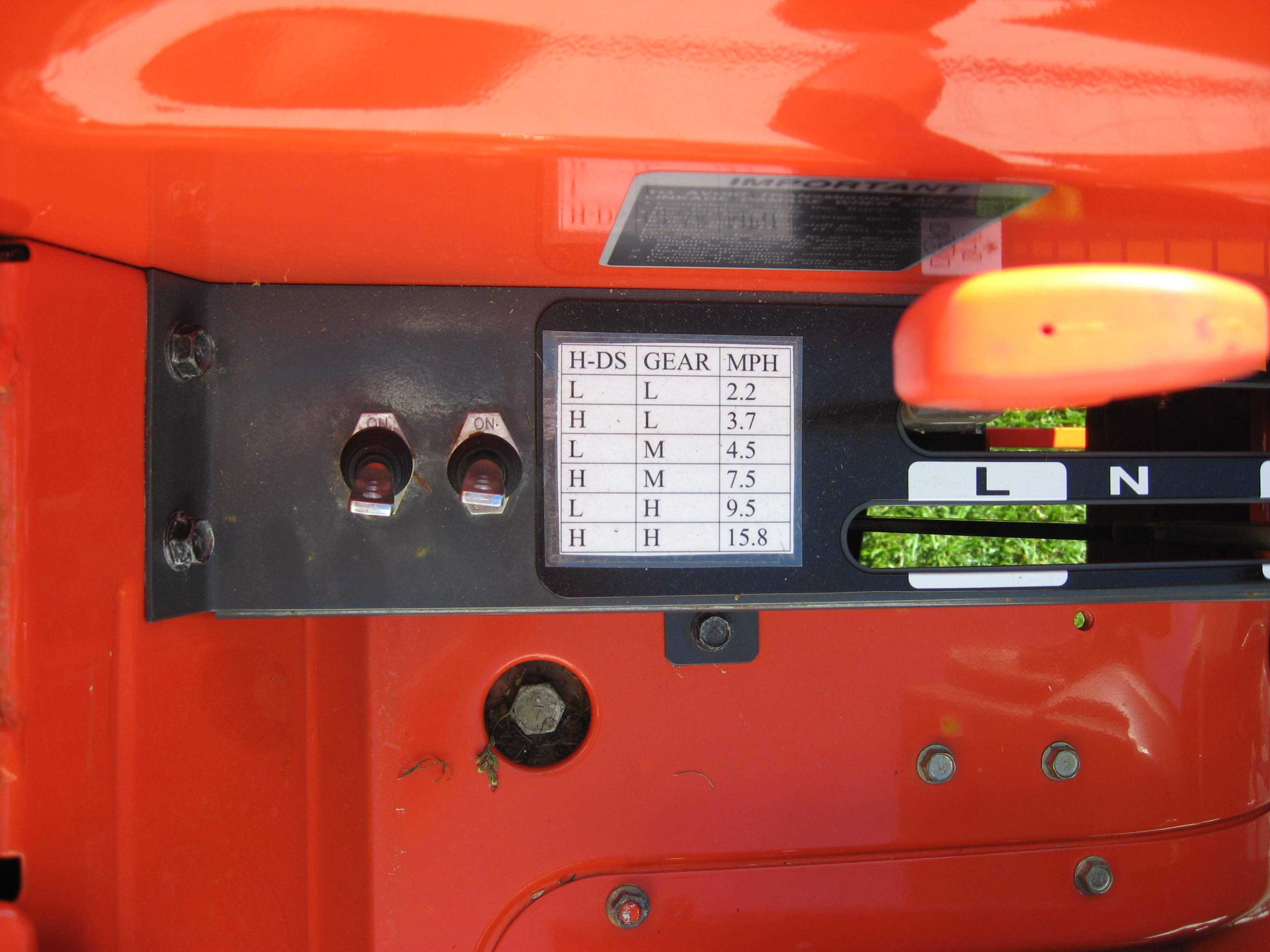

I can off the starter with an inline fuse, then followed the harness to back of tractor. Philip.

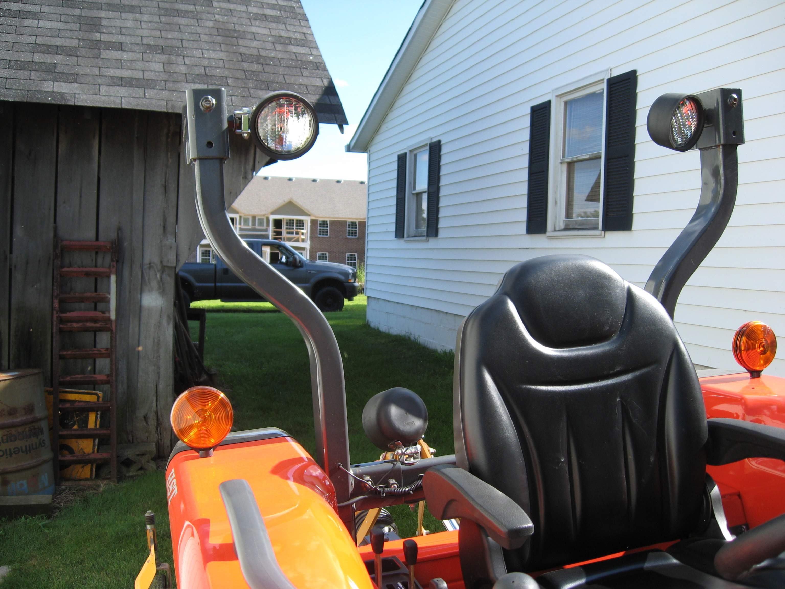

[/IMG]
[/IMG]
I was about to run a wire from the battery to some works lights untill i started looking around on this thread. Thanks for the heads up on the auxiliary terminals under the fender. I took some pics of where it is. I had to undo some electrical tape first.
The second pic is just a test to see when they power on. Which is when ever the key is on unless you put a switch in. I am going to look for the LED lights this week with hopefully a 360 mount.

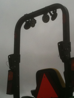

Hi Guys,
I got them through NAPA. They're Grote 63821-5. They come with mounting brackets. I did the unthinkable and drilled mounting holes in my ROPS. I considered all types of mounting locations - vertical part of ROPS, outside ROPS, inside ROPS, etc. I read everyone's experience and opinions here, and decided on hanging them under the horizontal section of the ROPS. The upside of this spot is the protection offered when bashing through the trees, the downside is a bit (very little) of glare when looking over your shoulder.
I'm very happy with them. Only downside I see is price (~150$ each), but in all honesty the savings in durability, and the not worrying about amperage draw, comes close to making up for it.
I did two forward, and two back.
It's dark out now, I'll take a couple pics.....
This is the only one of any meaning...
Daylight pics to follow.
-Jer.

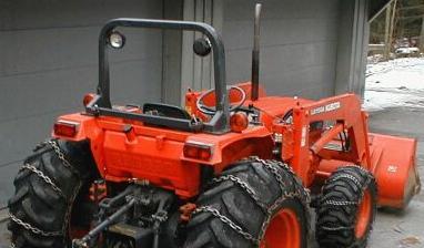

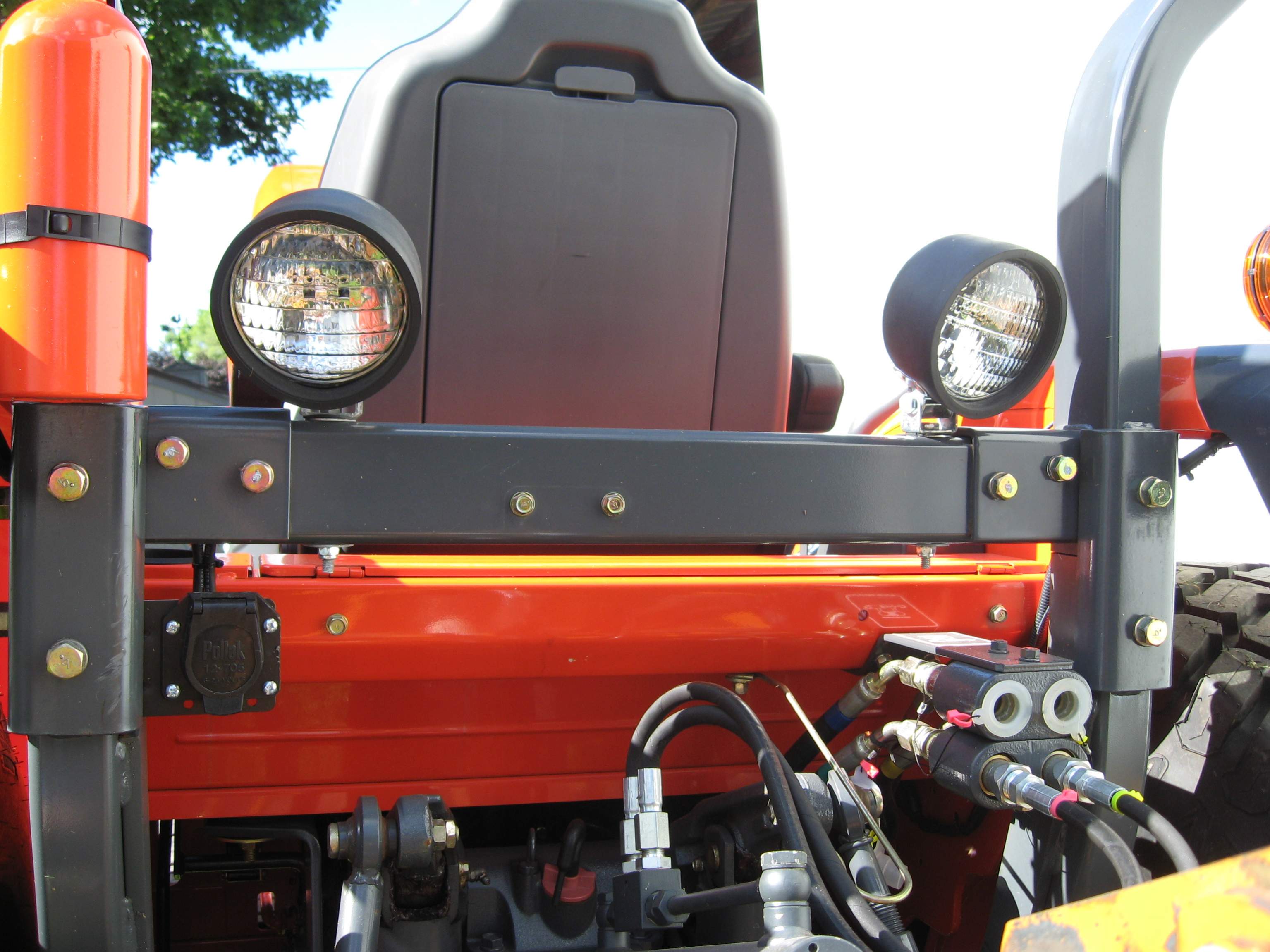

Drilled and tapped for the bolts and put the wires inside too so limbs can't rip them off. Light wire was fused - but not on the key.
/ ROPS work light power source? #18
My wires are in the ROPS too, for as long as possible.

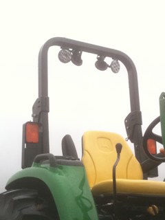

Here's a daylight shot of the lights, and my rig al loaded up it's way to the hydraulics shop for it's new circuits....
