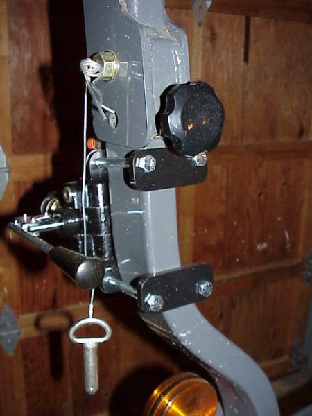

The BX Series have a anti rattle knob that you tighten after you put the pins in. This eliminates all rattles. My was so tight going up and down, I never had to use them. They are good to hand your hat on though..... /forums/images/graemlins/grin.gif /forums/images/graemlins/grin.gif
/ ROPS Pins #20
My Kioti CK20 has the same knob at each pin. It's a nice feature to have. G
