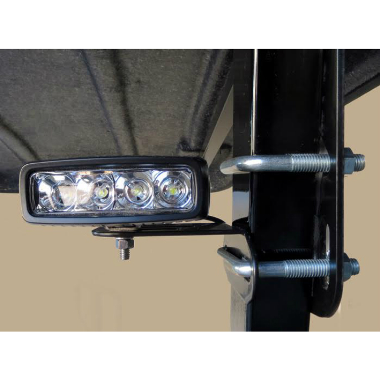

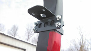

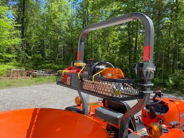

I'm all for ROPs and the safety they provide when it's ever needed. However, cutting into them or welding to them could compromise their strength. There is much hardware out there to just clamp things in place on the ROPs with u/-bolts and plates. The plates are the items used to mount things.
IF you ever resell the machine and the ROPs were found defective, it's an open issue of legal matters your not going to be happy with. Keep them "as-is" and just get mounts or make the bolt+plate mounts yourself.
100% correct. If you weld on or modify the ROPS in any way, your tractor becomes unsaleable or not being able to trade it in. It's yours forever. If you sell it privately and the new owner has a roll over and the ROPS fails, you are wide open for a PI lawsuit.

After the original owner sells the machine... they are entirely out of the picture...
For a person to do what you suggest after signing a waiver acknowledging safety equipment modifications they are not only liable they are stupid...!

So there are no brackets welded on OEM ROPS for mounting points, lights, hinges, etc.?

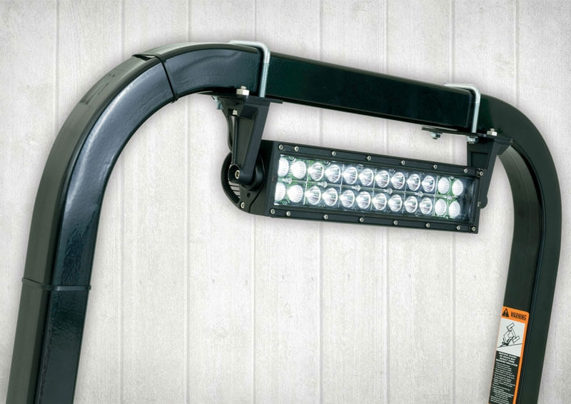

There are various clamp on brackets.
/ ROPS modification #34
Bear in mind that a design consideration of a ROPS will be head strike. Avoid attaching anything (including by bolting) which introduces any feature which you would not want to hit your head on (sharp corners on brackets). I'm not saying not to bolt stuff on, just think about your head hitting it. I've hit my head on my (factory original) ROPS on my excavator a few times when I have bounced it, even with the seatbelt on, and it can hurt! Happily, nothing sharp there! Consider padding if in doubt.

I don't know why people are automatically assuming there is no temper to the metal used on a ROPS. Most of the steel used on automobiles is tempered today, so don't bet on it.
As far as factory welding and hole drilling goes, it's simple. The ROPS was tested, and certified in that configuration. So, it's known that those things do not cause issues. Yes, you can argue a hole drilled in a particular place, or a small weld will have no affect on the integrity. And, it's likely that it won't. However, for legal purposes, you have to re-certify it to prove that. Which is not practical.
