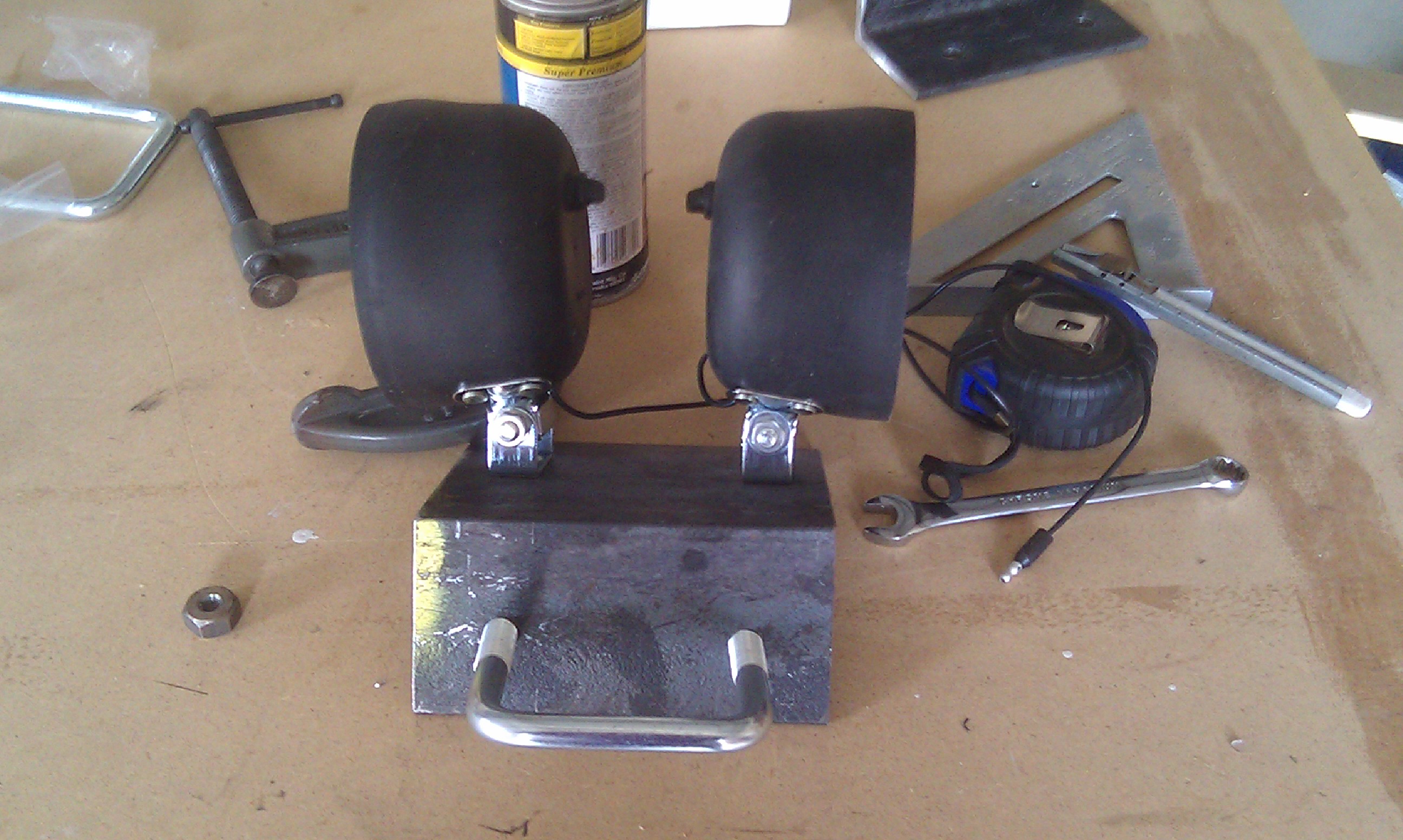

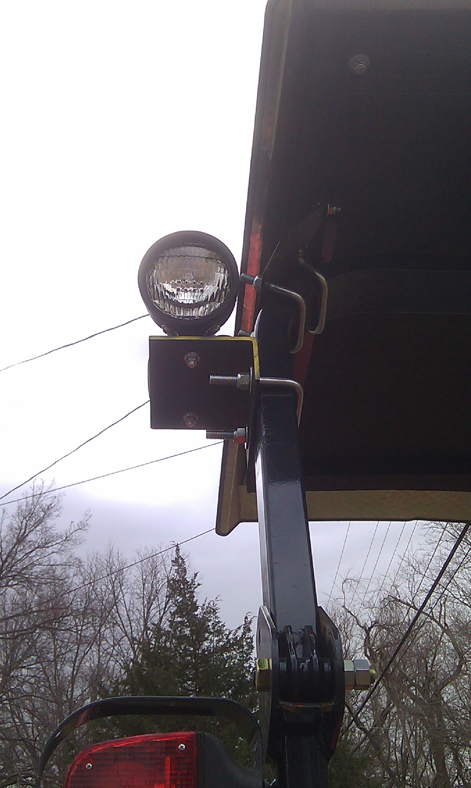

I just made a pair if then for $14.00, and you can make then for more than 1 light. I'm not knocking yours but, making them yourself make for a good day when your bored with cabin fever. david
/ Rops light's in or out #16
forgot the pics
