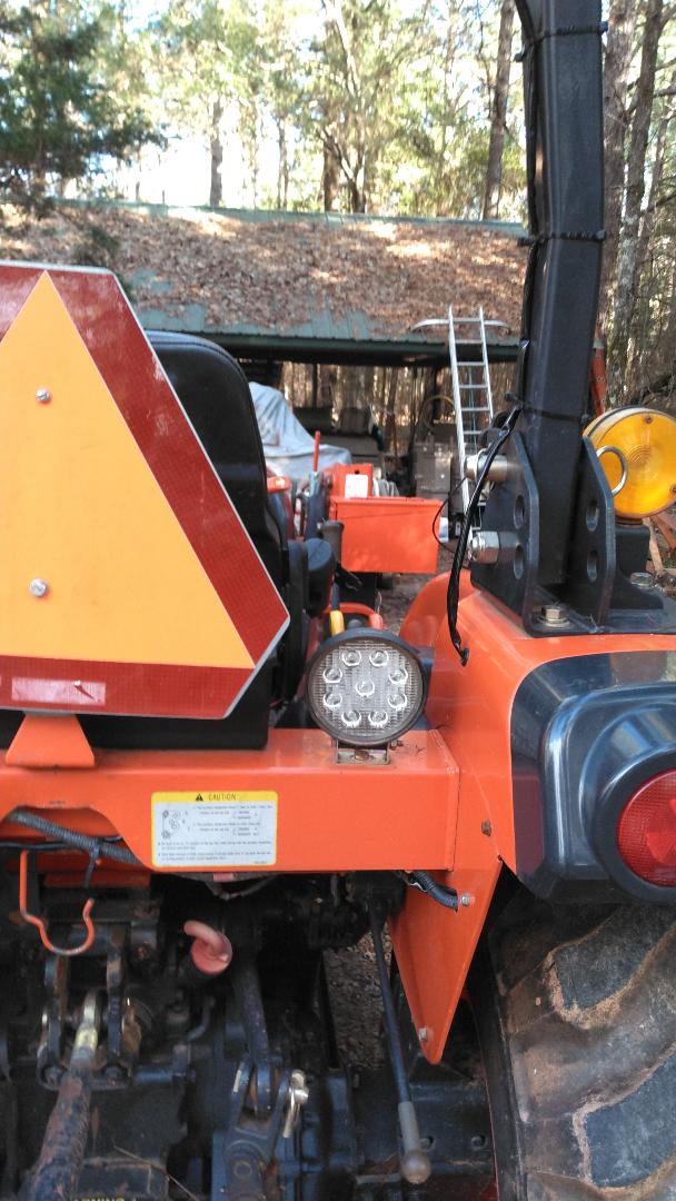

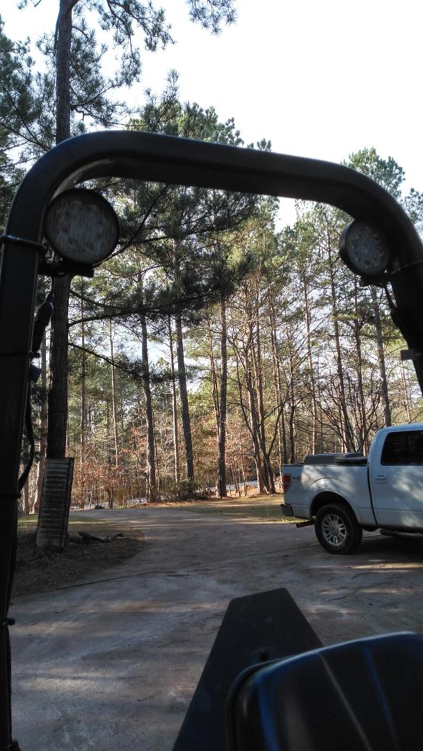

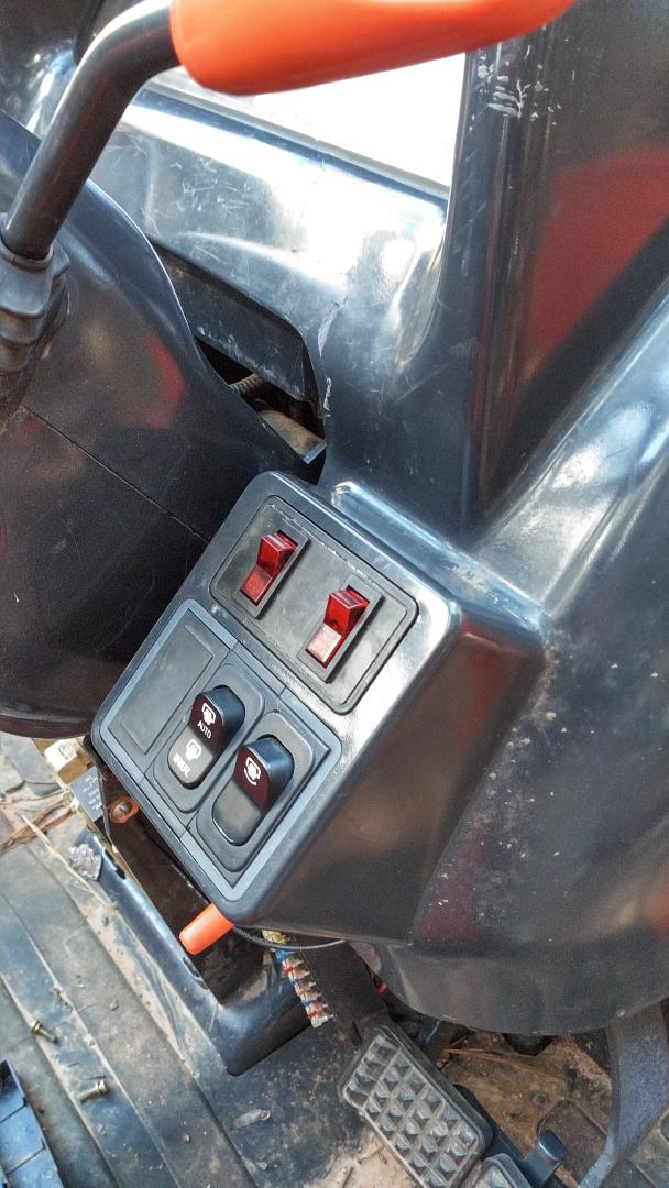

The ROP light switch is wires through the spare fuse in the fuse block. The work light is wired through the work light fuse in the fuse block. I think the Kioti factory work light has the switch on the light itself.

Nice set up for the lights. Did you use a relay setup or just tap into the factory wiring?
/ ROP lights and work light addition
ROP lights are on their own circuit through a relay mounted under the steering column. Work light is direct wired to a switch through factory work light wiring. A factory installed work light is direct wired.
