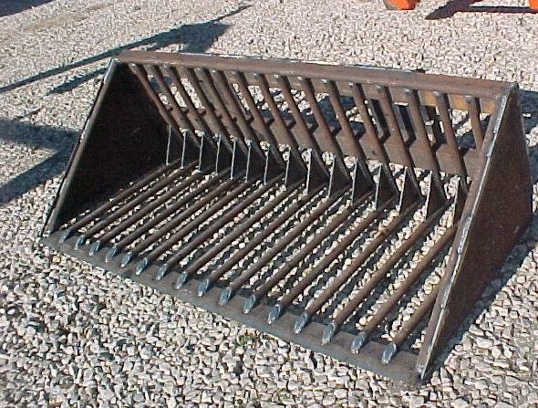

I built a rock bucket, There is 3" between the pipes. I used 1 1/4" OD, 1/4" wall pipe, The loader bit is 3/4 x 4". There was a lot of welding on this project. I used my ESAB 250 AMP wire welder. I have several pic's to show off a little.

   / Root/rock Bucket
#2
   / Root/rock Bucket
Front
   / Root/rock Bucket

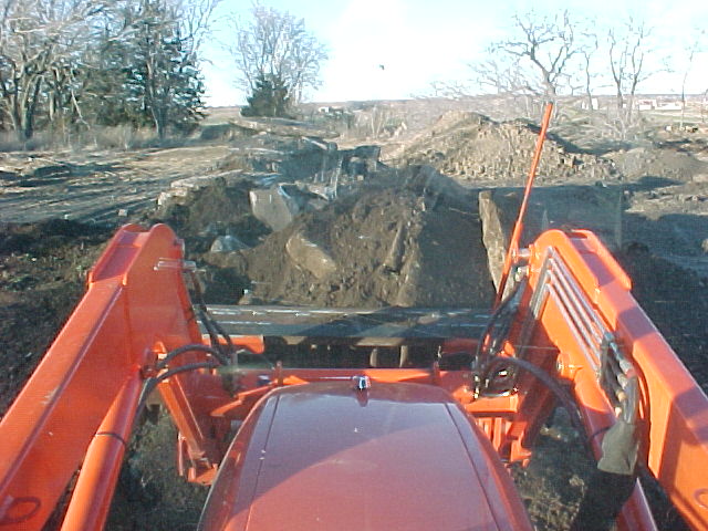

Now for the test, here is a pile of dirt and rock and concrete. I needed to save the dirt and haul off the crap.

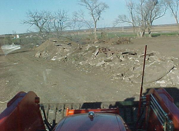

   / Root/rock Bucket
The pile of crap I am working on.
