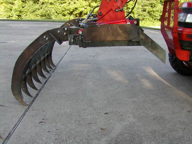

JJ,
Are the curves on the 16 & 18' shanks the same? In the photos, it looks like the 16's sweep forward a bit more.
Dave

/ Root Rake/ Grapple combo #25
JJ, I was wondering if your grapple could be used to rake in this position.
/ Root Rake/ Grapple combo #26
You could adapt a york rake for back grooming hills and berms like I did. It worked great!

/ Root Rake/ Grapple combo #28
JJ- Just had to bring this post 'to the top' for several reasons. (1) A fellow poster brought it to my attention, (2) AgriSupply March flyer came today! SCARIFIER SHANK 17.88'' 4 HOLE - Agri Supply , and (3) I'm looking at a 2002 Jeep hitch setting beside my garage, just lookin' for new duty! Great idea using these rake-tines in such a fashion! With all the grapple 'talk' on the board, and lazer cut steel etc., I thought this deserved another look. I'm wondering if one could further adapt your design to have the ability to swap the 'grapple' portion to a stock bucket, along with your root-rake fabrication. Thanks again for your contributions! ~Scotty

Hello Scotty,
If you mean to keep the grapple and replace the bottom tines with a bucket, sure , that would work. Since then I have collected about 7 more hitches. What are you trying to do, make a mini bucket with grapple?
Did they have a good deal on those shanks.
