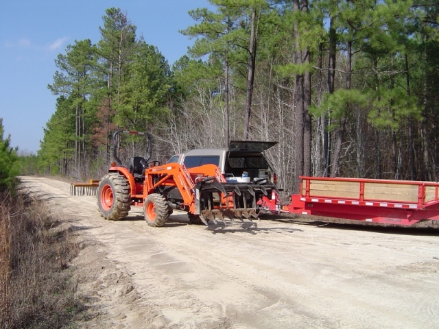

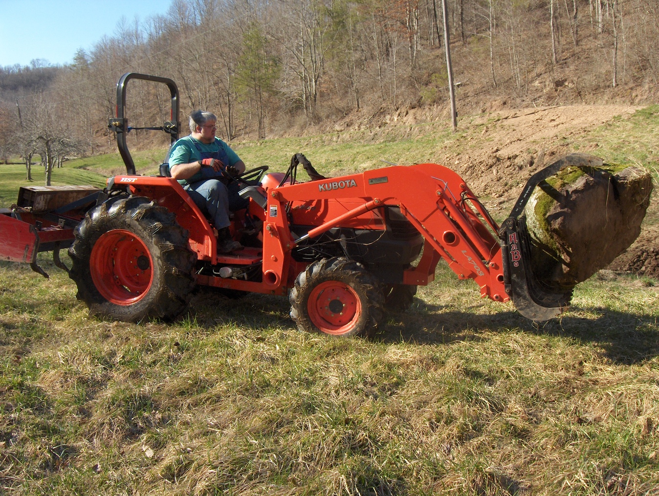

You might also look at Anbo grapples. They are more expensive but they are great grapples. This type has the ability to reach over and rake back but it does not work well in laying items across the lower tines. This grapple weighs about 340# and I say about because I don't know if they count the hose and fittings. The Anbo Grapples are made of a highly abrasion resistant steel that is supposed to be 2 times stronger than T-1 steel. I haven't so much as bent anything on the thing.

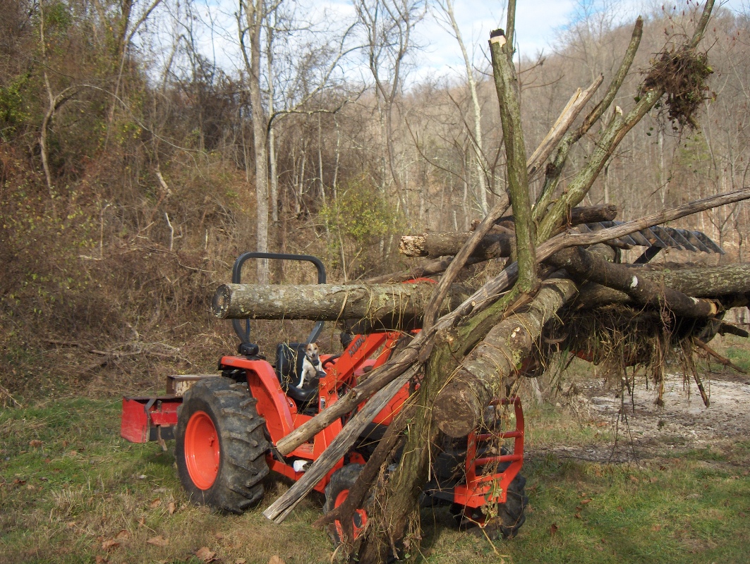

I have a WR Long light duty grapple and have been very satisfied with it.
However...I never could get my dog to wear a seat belt long enough to do a clearing job like Randall's Jack Russell, (in the second pic).
