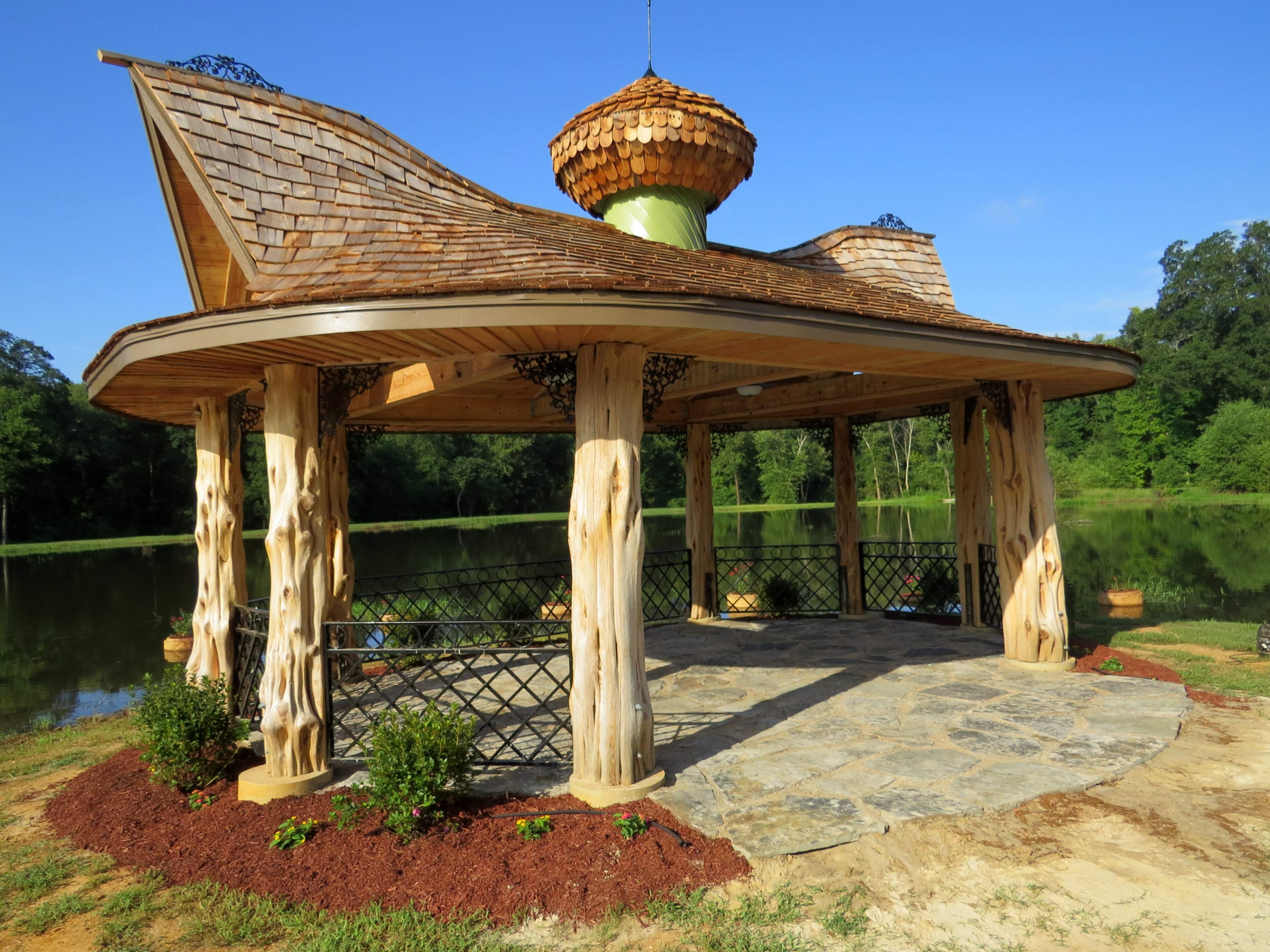

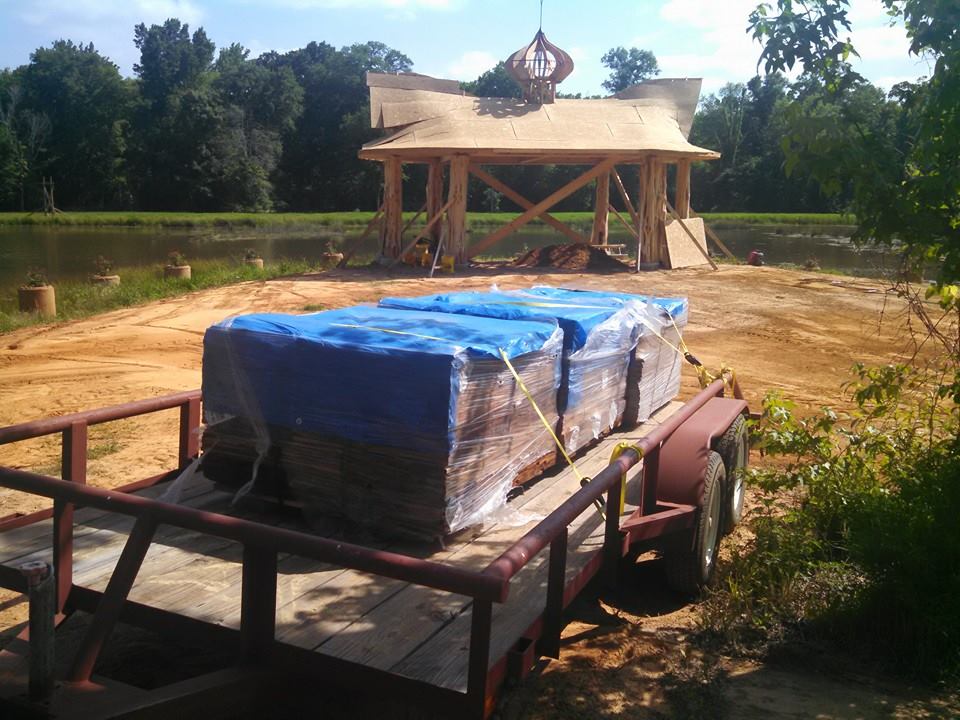

Lowes carried cedar shingles here. Or I should say one of them does. There are three Lowes within half an hour of me and it seems like just before I started building my wedding gazebo, they had a couple bundles on the shelves. I looked around and could not find anybody else who had them, or who said they had a reliable source to order them, so I ordered 8 squares from Lowes. Normally I wouldn't use cedar shingles for a roof, but in this case, they where the only thing I could find that I liked the look of, and in this case, looks where the most important part of the job!!!

Eddie, that looks great. I've always felt that a good carpenter can build things other than a square box.
