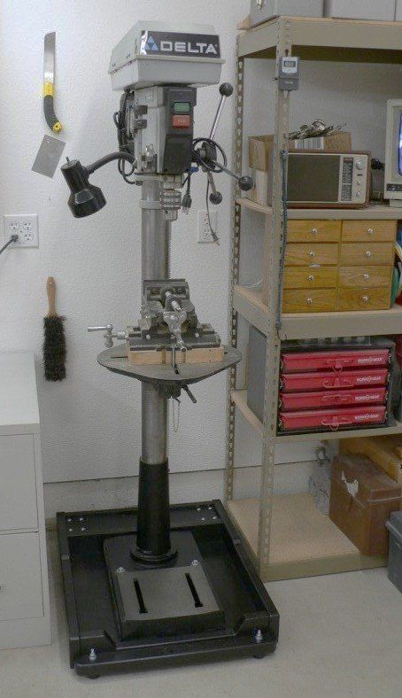

Has anyone seem such a thing?
I have very little room in my shop and have recently developed a little alcove perfect for my floor mounted drill press to reside. But no room to tilt it and walk it out, when I wish to use it. Which is OFTEN!
Does anyone make a base with wheels that lower and raise? Using compressed air would be great.
Just thinking, would an air cusion work? Basically a hovercraft!

How about just installing it on a base with small casters? That's how I move my generator around.. Bought it at tractor supply for $20..
   / Rolling and Arresting Floor Mounted Drill Press Base.
Not great for something that (in use) has to be stable and solid AND is top heavy!
   / Rolling and Arresting Floor Mounted Drill Press Base. #4
Yeah, not for something that top heavy.
Can't help you OP, mine is bolted to the concrete floor.
   / Rolling and Arresting Floor Mounted Drill Press Base. #5
Ya didn't think of the weight on top..
I would kind of like to try the air cusion, just don't know how big to make it. I don't really like the idea of blowing dust around though.

Just a quick search.. Have no idea if they work well or not..

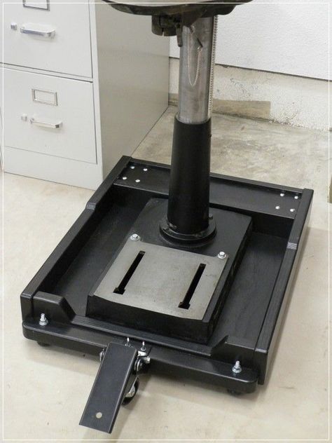

Curious if there is anything special to the last one. I realize that I am limited to parking space in my little alcove. I can't go much bigger than the original base.
Castors often have levers as brakes, but are there none with levers to raise and lower them?
   / Rolling and Arresting Floor Mounted Drill Press Base. #9
Looks like it has fixed wheels in the back and a caster that flips up and down in the front. Then the front corners have rubber "feet" so they don't move.
Aaron Z
VERY interesting. That could be easy to do. I don't know how they activate their front castor but a jack type lever could easily accomplish that. Could even put a D handle on it, pull it forward lowering the single castor and pull the thing out.
