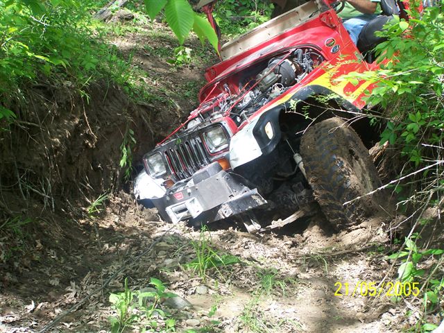

I agree to a point, I just did some really hard side pulls on my jeep last weekend and the roller kept it where I wanted it but then again I am using an old Warn 8274 on a jeep with a 150 feet of cable, saved my azz. I was in a sticky situation.
Where I disagree is waiting until the end of the day to re spool. I try to do a hand respool after every pull. Don't want it bound for the next one. But I was using my junk pretty hard.

I guess if you only plan to use it once, then respool after every pull. These two pulls were within fifteen minutes of each other so no respooling was done. I only respool during a run if my cable is bunched on one end and the next pull is in the same direction and I'm gonna pile up cable until it starts dragging on the winch frame.
Also, I'm not sure one of those winch spool guides will work without a guide pulley in front of the drum keeping the pull centered on the drum. On a tow truck that is possible and the cable is always being pulled straight off the drum. On a Jeep or a tractor mounted winch that wouldn't always be the case.

Yeah, the first pic looks about right if it were goinig down hill and the pull was up hill and the line was perpindicular to the jeep. Guess you use your YJ pretty hard as well! Nice Jeep BTW but where is the hood?
I use mine while I run, the line is fast but somtimes not as fast as my jeep, so it tends to get a little wierd on the drum as I move forward. It will bunch up as you know, what ever takes a couple of minutes to fix.
