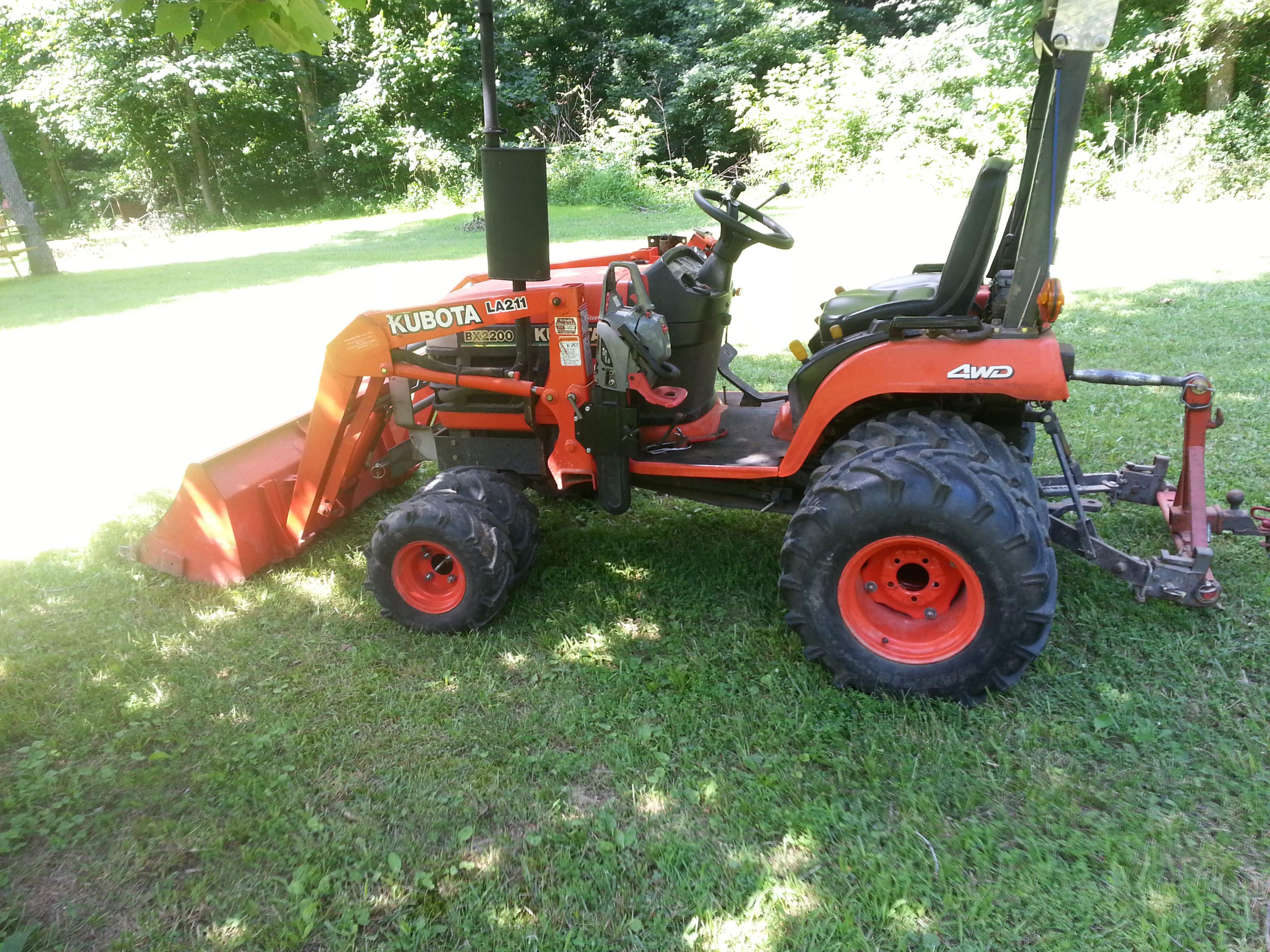

Nor mine!:laughing: I to laid mine (BX25) on it's side while not even moving but I only did it one time. Did have a few close calls other times. Got so close one time that I had to gingerly reach back and push the BH leg to go down on the down hill side to stabilize it and then swing the BH bucket around to the high side and pull my backend around to up the hill side. Started to jump off but didn't have KTAC Insurance. :D
