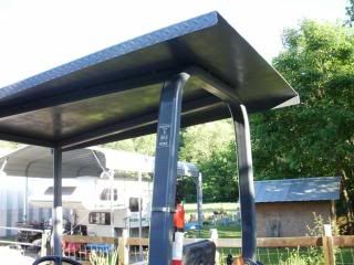

Canopy Roll cage & new steel roof for my DK40SE

Armour plate? Hmmmm......... if I can get "aholt" of some kevlar & ceramic panels I can at least make it bullet proof:D
I think all tractors should come standard with a belly pan. Any time I am doing any light grubbing I find sticks & branches jammed under & around all sorts of delicate stuff around the vunerable underbelly. I did destroy my radiator fan while backing up, jamming a sapling into it from the backside. I have knocked off hydro lines to the fel, unplugged electric connections and ripped of one of the engine side sheilds. All this was very easy to do and yes I was trying to be carefull, but it happens in the woods.

Here is my plan: get a big section of cardboard & make a template of the belly pan cut out. Once it is fine tuned, I can take it to the place that cut & did the break on the roof edges and have them cut out what I know will be an odd shape out of 3/16ths sheet. They don't have diamond plate, but the flat sheet is cheaper. Once I get the steel back home I can weld attachment points & tabs where needed. I agree a few access holes will be in order. Once all welded up, off to the paint shop(front yard) for prime & paint.

Update:
I kept getting a serious rattle from 1600-2000 rpm from the front support tubes where they bolt to the loader arm brace. I drilled a hole, then welded a nut to make a "set screw". Once tightened up, it fixed 90% of the rattle...so now it only vibrates at 1900 rpm, so I just stay out of that "zone".
Oh, and my cheapy Pyle radio would not play MP3 format off of Media Player, so I bought another radio from WallyWorld for $70 & it works perfect. The Pyle will go into the pontoon boat where we just listen to FM. To be honest I think a $40 MP3 player & headset is probably the better route. While operating at high RPM's I can't hear the radio unless I wear earpulgs(which I do anyway), so an MP3 would block engine noise while delivering a much better quality music. It is nice to have the speakers when at idle/low rpm, or when parked working on something in the field.

MotorSeven, I've been thinking along the same line. 250+ for 8 dollars worth of plastic doesn't seem like a good deal. Could you tell us what the diamond plate cost? .perhaps before and after the rollI. I was also thinking 72" for some shade on the backhoe driver
