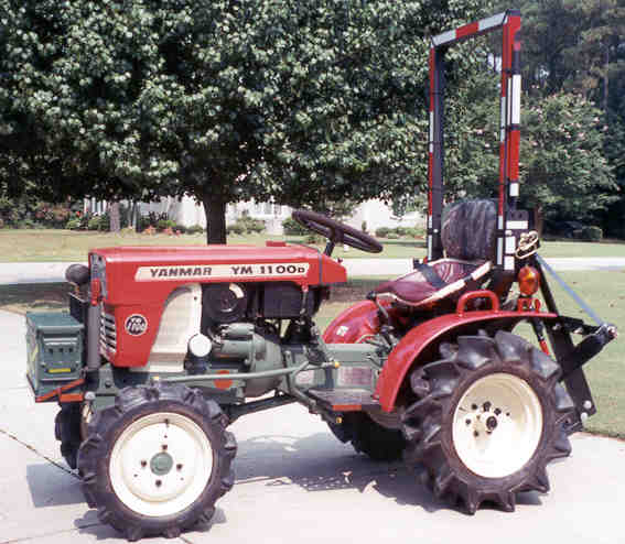

Re: Folding Roll Bar
I made my rollbar a folding type so I can throw a tarp over the tractor. Pivoting hinges with strong 3/4" hitch pins make it solid when "up" but allows bar to be quickly be folded down.

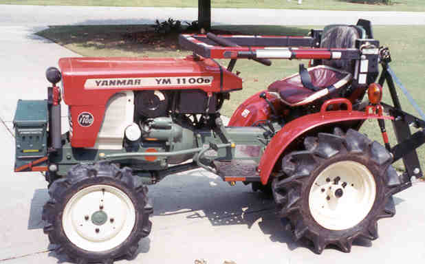

Bar folds forward and lays flat just forward of steering wheel.

Please remain seated until the tractor has come to a complete stop. Keep clear of the bar. Exit to the left.
Those are some aggresive tires! Bet there's no mud that gives you much of a problem...............chim
