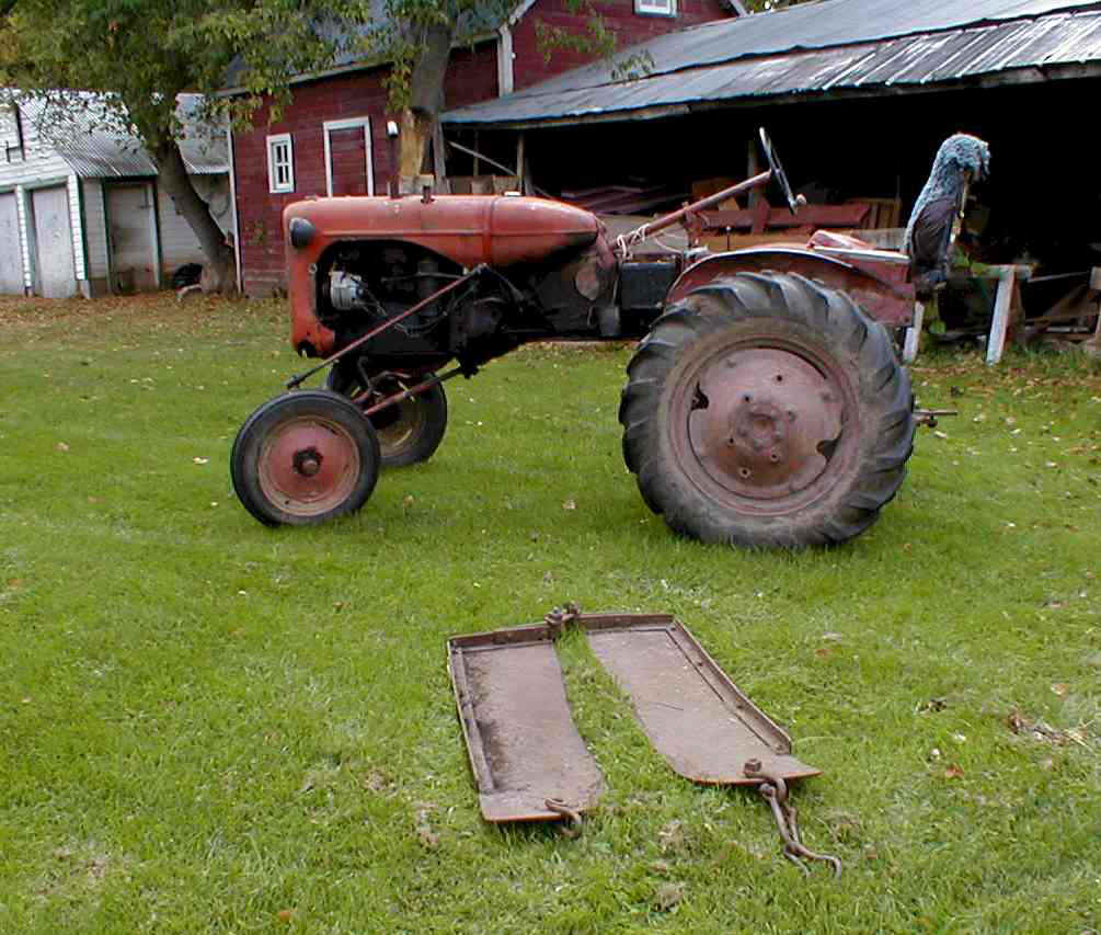

I want to build a rock sled to move rocks way to big for my little girl. i have several rocks on the side of a hill i would like to move to the front of the property for landscaping. i have managed to chain a few down but im tearing up my creek crossinf dragging them across. Somone once said something on here about using a car or truck hood and that seems to be the cheapest /quickest way to get started. Does anyone have any experince doing this or pics of their set up? im sure i will have to find a 90's ,model or older hood and probably not one off a civic, lol.

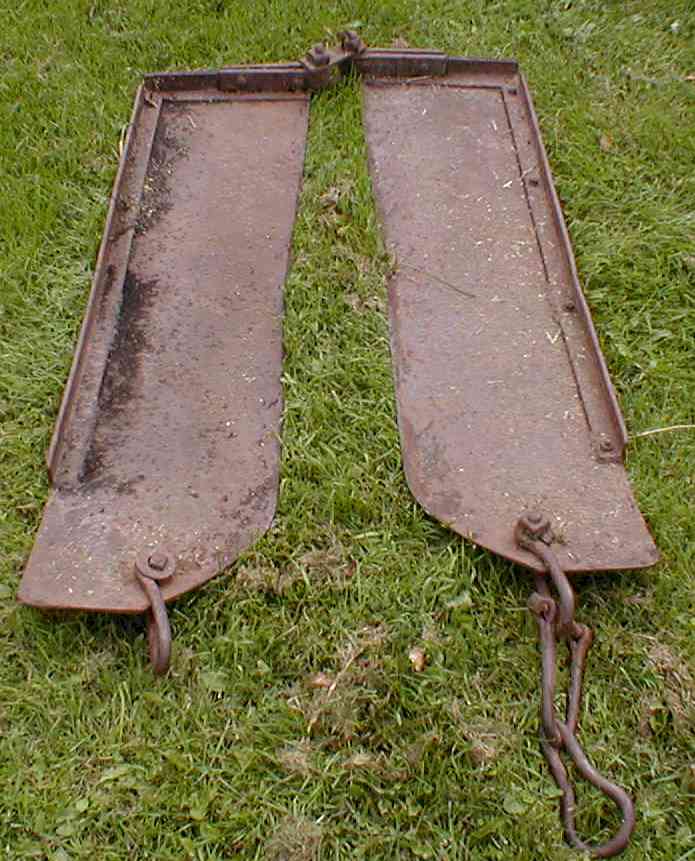

Buy or build something like this:
Montana Jacks QuadSkidder w/Chain Kit
ATV Log Skidder - Log Skidding Equipment - Log Sled, LLC
Build one like this, and you don't even have to roll the rock onto it:
With any "sled," be careful trying to cross a sidehill. The rock will want to roll sideways, taking the sled with it.
Bruce

That's a very clever design, bcp.
Simple to make & use and just about bullet-proof.
Why didn't I think of that?

I also agree BCP, great idea, and it looks like it would be easy to use.

cool idea, and would work great in some applications for what i am doing. unfortuantly getting that into position on the hill would be next to impossible. the rocks are partly burried and God has stacked them pretty tight up there. i have to first get them out of their position, moved down a pretty rough grade, through the woods, across the creek, up another rough grade, and finally to the pile. that skidder would work great for once they have landed in the pile. i will defiantly keep that in mind. that style will anilate my attempt to build a creek crossing with redimix and stone.
