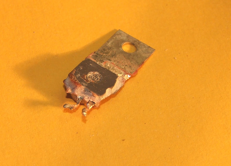

The component on the right is a $2 transistor it could be a voltage regulator or a rectifier you will buy from Tandy or Jaycar . But what caused it to blow ? If your lucky the generator was overloaded and that may be all that is wrong with it . Can you see a partial number on it ?
Ironhorse. No identifying numbers at all I'm afraid. The small part is upside down. The other side of that part probably had the identifying details but its completely burnt and broken off.

I said it would be like an archealogical dig and it was! Heres the 'find'.
Before I take it to the 'generator shop' and get laughed at does anyone want to hazard a guess what it is?
I had no idea what a to-220 was so i had to look it up.
TO220 - Wikipedia, the free encyclopedia.WOW..Thumbnails!. Thats new!!!
That package should had a side that is flat inline with the case metalic tab, and another side with a bump out where the epoxy case is. The bump out side is where the ID number will be. If that is the side that is blown out.. you are SOL, and will need a parts list or schematic.

The component on the right is a $2 transistor it ?
It could be alot of things... diode.. darlington pair.. etc.. Truth is.. in that package.. it could be lots of things.. that's whey he needs a part number / list / schematic.

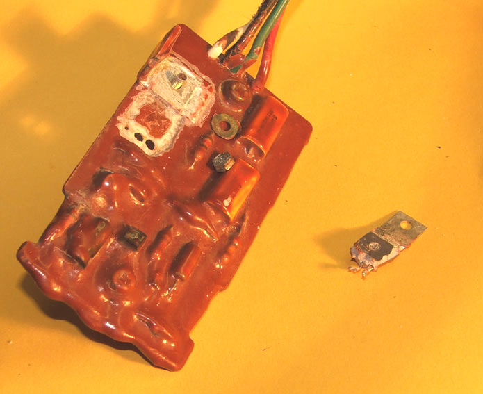

You might find an overall wiring diagram for the generator, but the AVR will be listed as a empty/black box. You can get the P/N for that board assembly, but I would doubt you will ever find a discrete component list for the AVR. This isn't really rocket science, but it can be made complicated depending on if any other control functions are piggybacked onto the AVR circuit.

There are a bunch of different ways to excite and control a generator, that all the manufacturers circuits, and that particular burnt part, are going to be different. A good electroincs engineer with a way to make an educated guess at the other components on the board might be able to tell you what that damaged part is.

Thats why i asked him if he could see a partial number so i could match it up with the listings in the book i have . alchemysa// What condition is the printed circuit in ? Will you be able to de-solder the old pins and re-solder the new transistor pins back on ? If they are burnt , scratched etc it's probably futile , i have bridged broken tracks before with solder or fine wire but the board needs to be really clean . That vibration preventitive the board is coated with looks pretty thick and challenging .
Iron horse. I didn't take a pic of the back of the circuit board but I'm pretty confident I'll be able to solder the 3 pin gizmo into place. I cleaned up the board pretty well with a Dremel engraver type of tool, and I can bridge a couple of places where I broke the track. The board is pretty big (About 2x4 inches) with very few components so its pretty roomy. Apart from the burnt component it looks like new. But my problem is identifying the 'thing'. The piece of the thing that got blown off had the identifying marks. (And theres no fractured little bits anywhere in the regulator box. I'm obviously not the first person to look.). Under a magnifying glass the only marking I can see appears to be a Hitachi logo.

I could tell right of fthat the part of the package with the number was long gone. Also.. I'll bet that coating was there as more of a 'information control' technique, vs the little vibration glue many manufacturers use. may also have been a weatherproofer.. etc... Works good as all three.. etc.
soundguy
That is what is known as conformal coating, it is to protect the PCB assembly from environmental hazards.

I found out that Australia's 'voltage regulator guru' works in my own home town. I took my board into him and he identified the part immediately. Its an MCR8SN Silicon Controlled Rectifier. He even wanted to give it to me for free. (He at least let me put a few bucks in the charity sweets box). He was happy to see me trying to get the old Robin going again. He's fixed a few himself. He took quite some time explaining a few details. I thought that was pretty cool for a guy who works on custom built $50,000 generators and could have tried to sell me his own special $140 replacement circuit board.
Heres the address..Genaust Power & Water Pty Ltd - Control Modules
Anyway I got the part, soldered it in, reconnected everything and fired it up.
Beautiful! I'm a happy man.. a 2000 watt generator for less than $50.. and I know nothing about electronics! And thanks for everone's interest.
