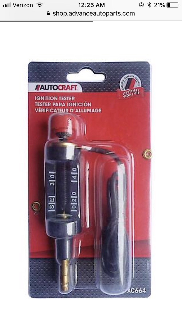

Coil tester shows that the coil is good. It still puts out a spark, it is just too early. Really weird problem. This took me awhile to diagnose.
/ Robin Engine Problem #23
Just to elaborate, I have had two coil failures in the past year that the coil tester said were good. I am not saying don稚 get a coil tester, but this experience puts doubt in my mind about a å*µood result.
