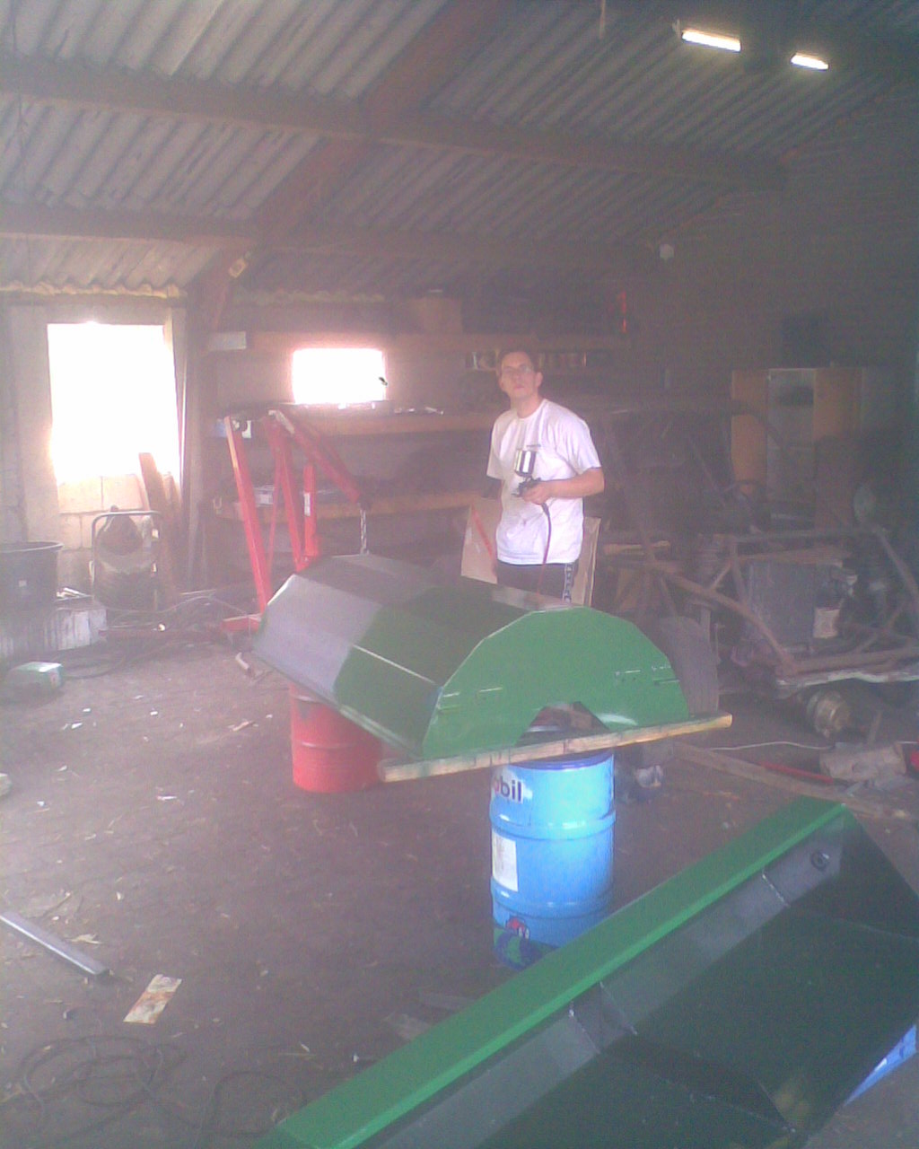

Defective said:

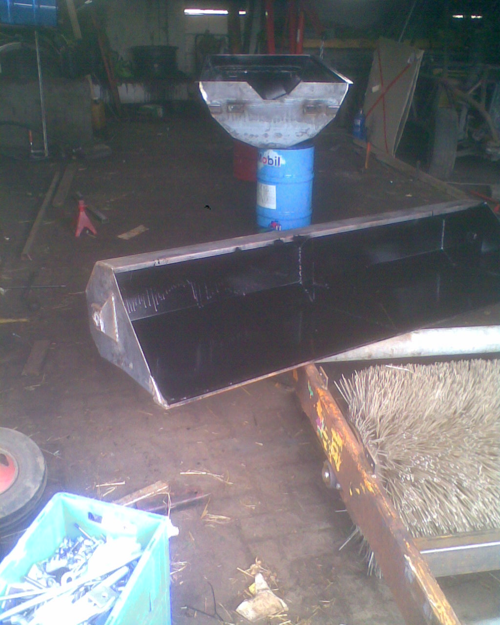

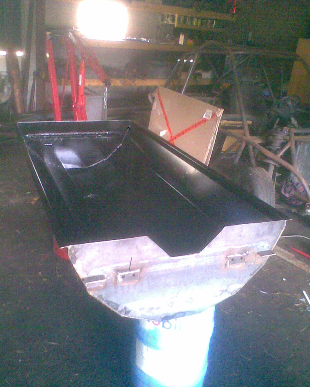

Nice, thorough coverage on the inside of that scoop Renze... :rolleyes:
If i really cared about them paint runners, i wouldnt have showed the photo here ;)
Its on the inside, so nobody sees it once in use... :)

bob_wood said:
Is that your buggy I see in the background ?? Think i saw one like it in Mad Max Thunderdome ?? :) Is that You or your friend with the paint sprayer?
yes, and: yes.

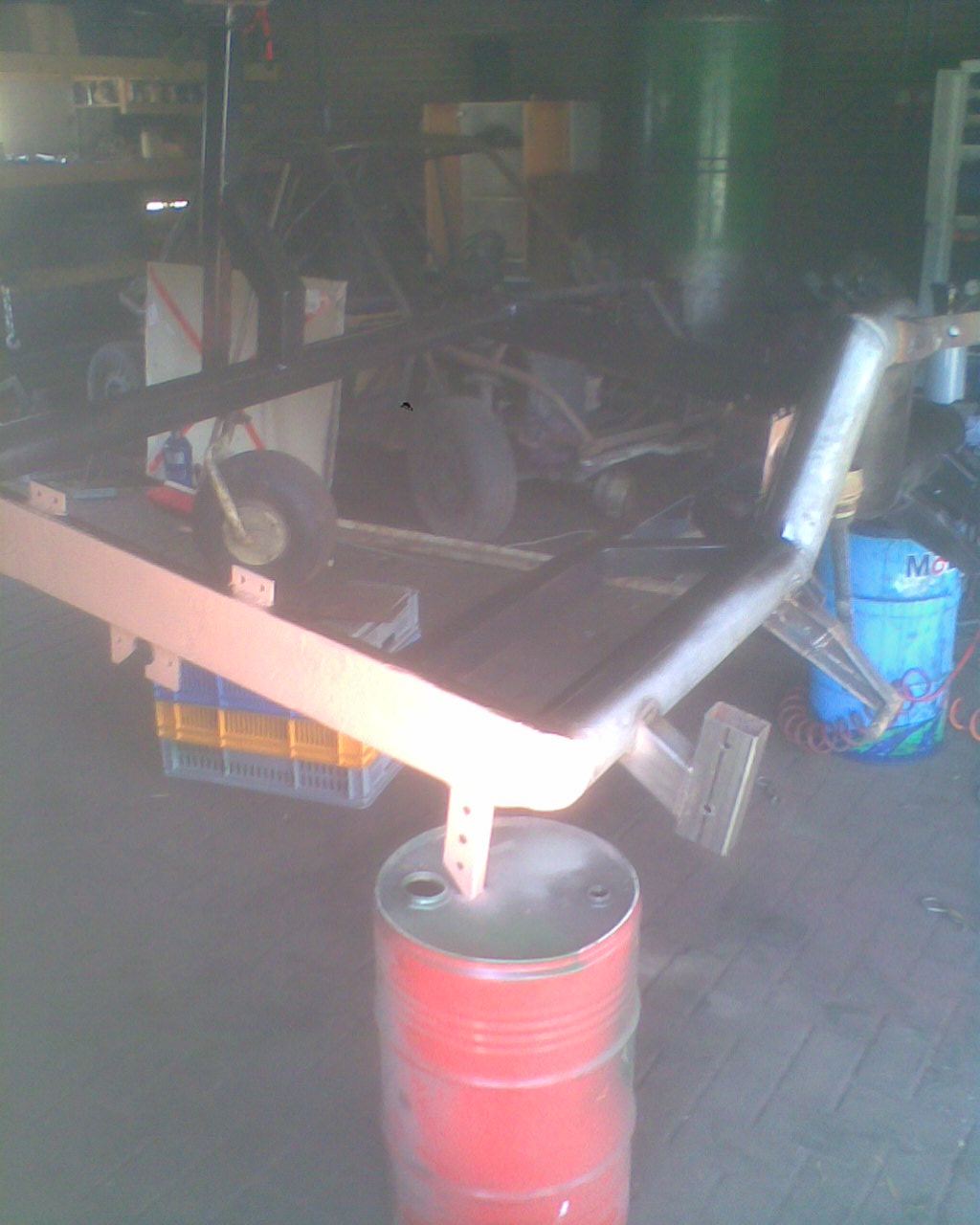

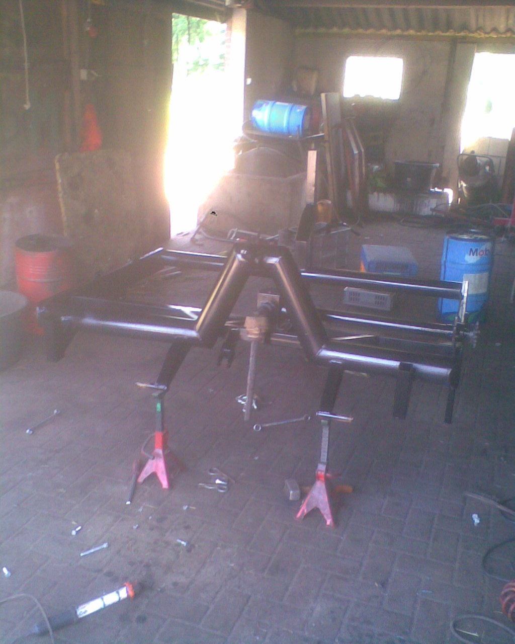

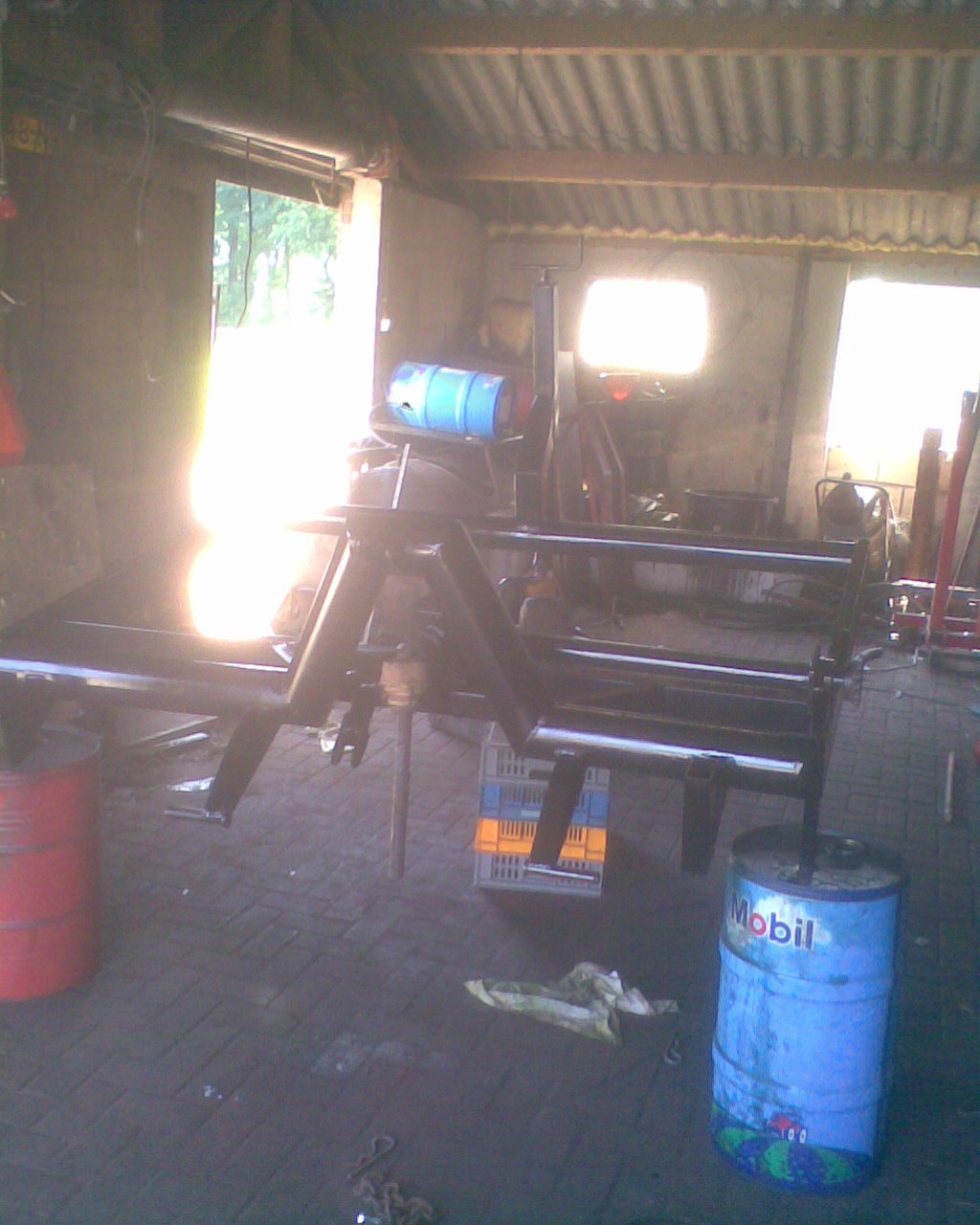

got the frame painted this morning:
first sprayed some "right over rust" Hammerite primer over the longitudinal frame tubes, because these were quite rusty.
(i cleaned the most of it with a wire brush already, "right over rust" i take it for what its worth ;) )
Then i sprayed it all again with black Hammerite. Its about 27 euro for a 0.75 liter can, but it promises to hold better on rusty surfaces.
I didnt want to use the cheap black varnish, because i am afraid it will remain sticky in the sun... dont know about its surface appearance either.
Because of the poor light in the workshop, i'm not 100% sure of the paint coverage, but i just need to get things done now, or my summer holiday will be over without having a day off ;)

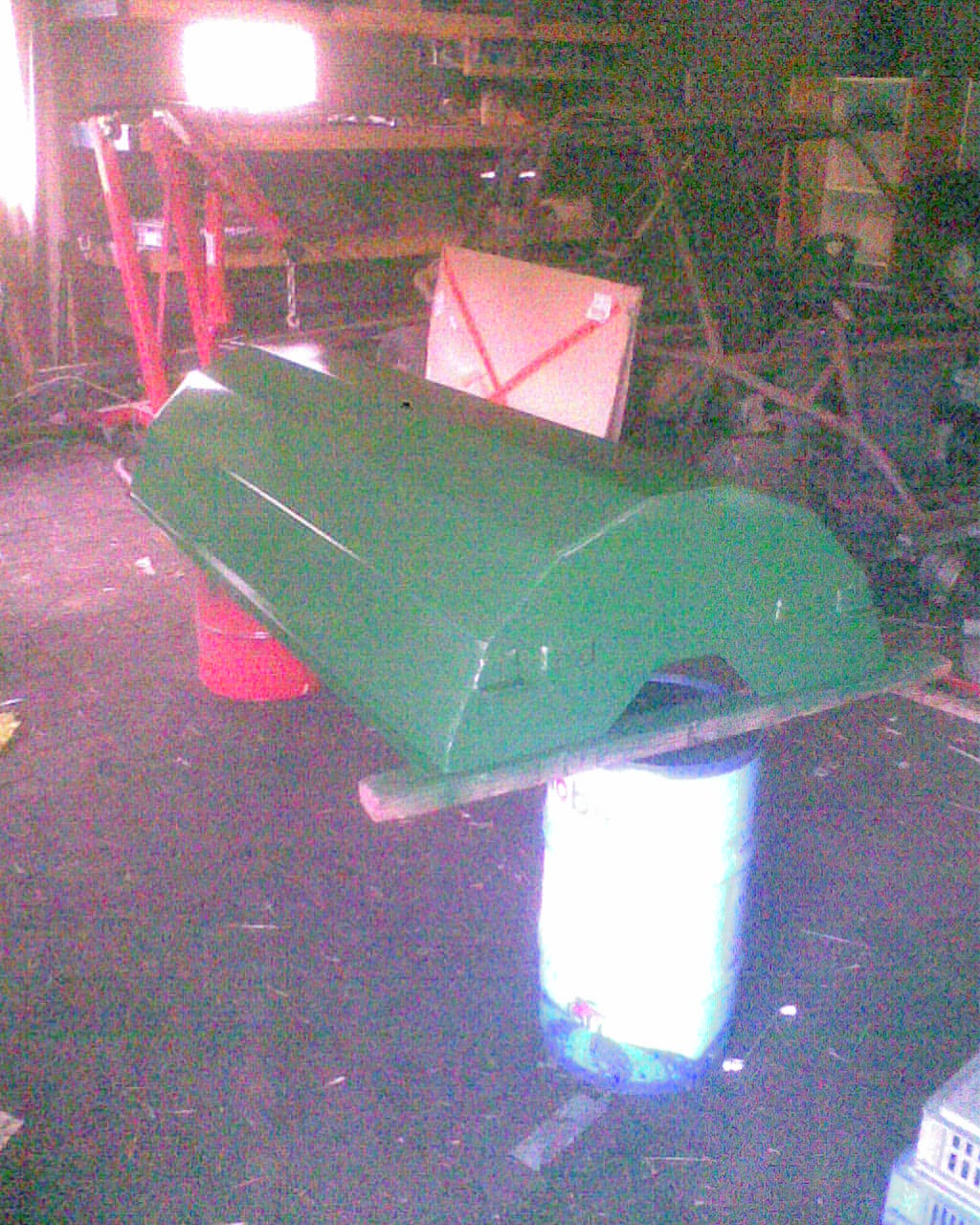

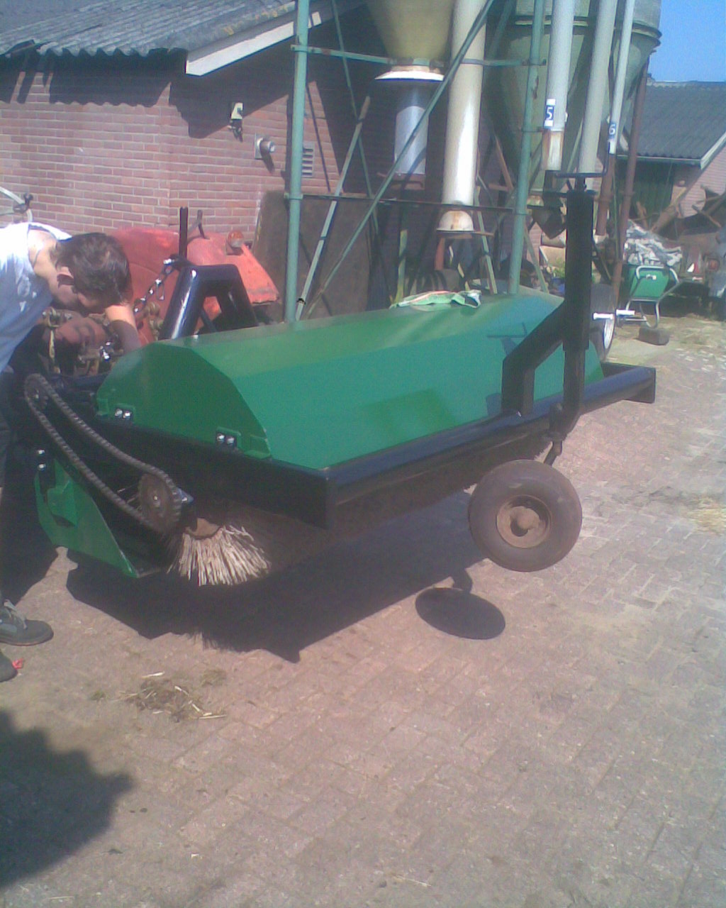

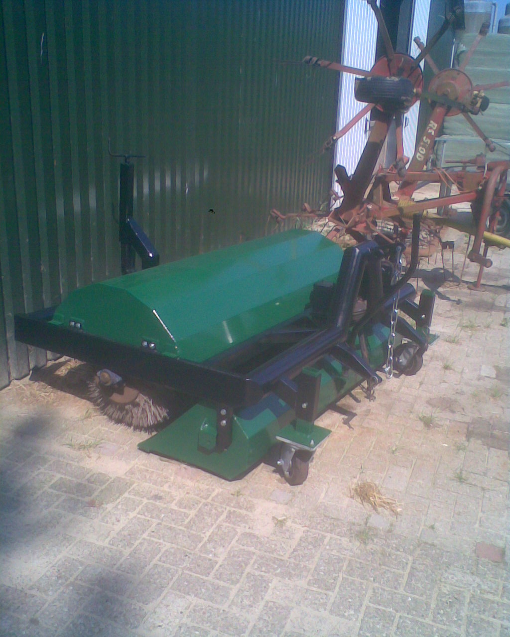

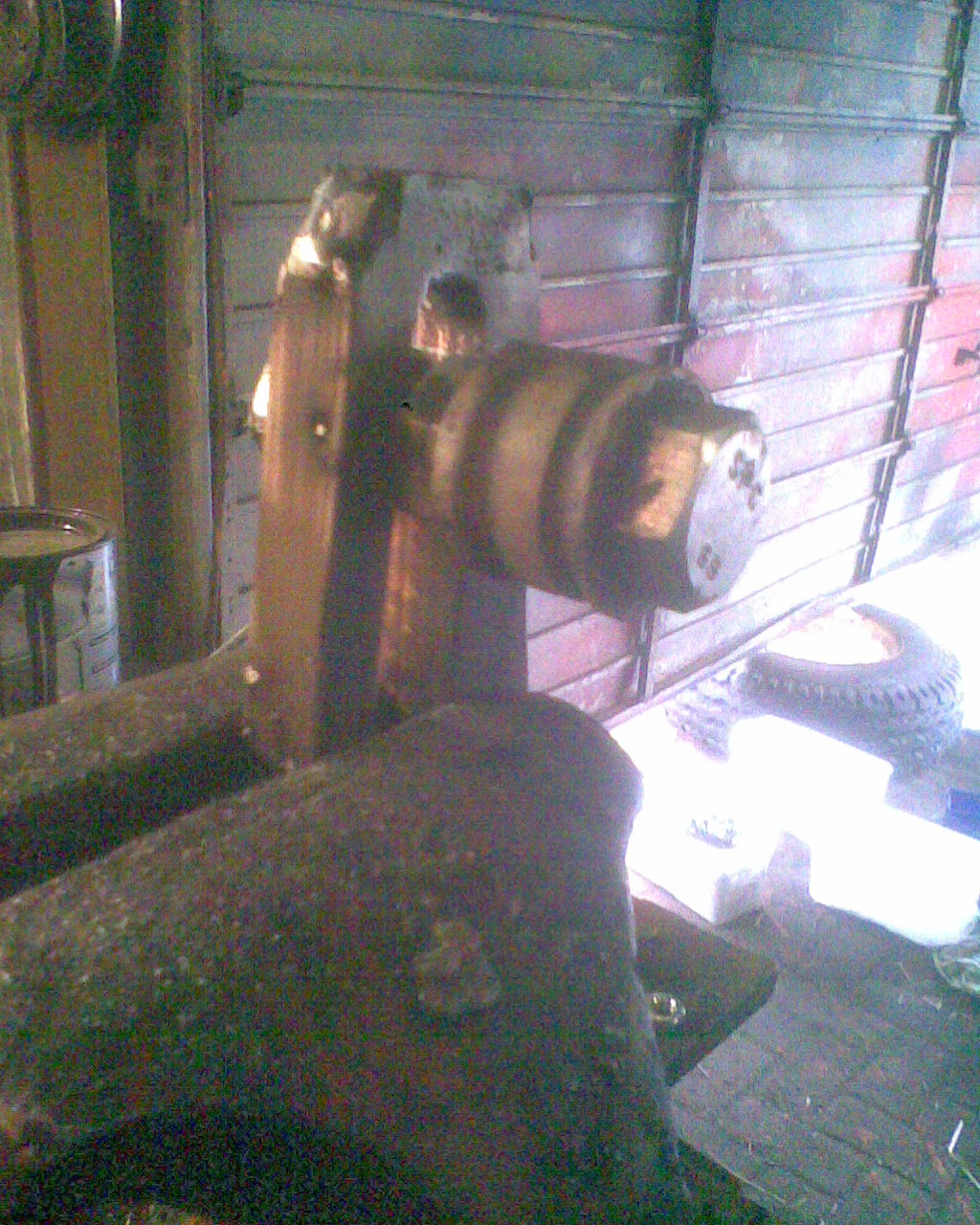

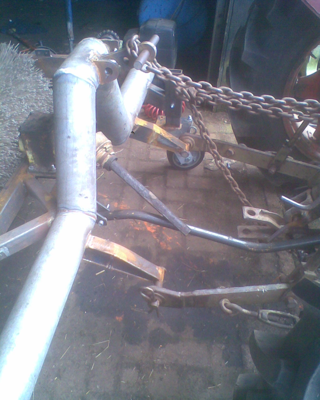

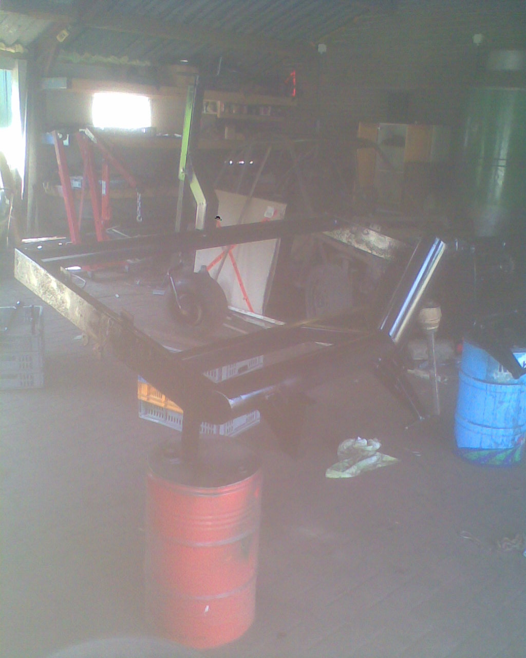

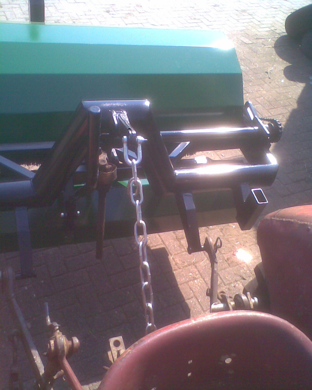

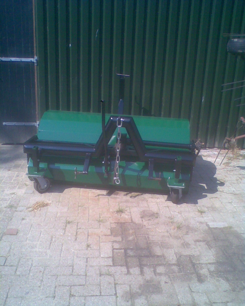

got something visible today:
We assembled all parts, so the machine could be set outside, in the sun for the paint to cure and harden. I didnt tighten the bolts yet, it has to wait till the paint is tough enough.

   / road sweep rebuild #27
Renze
That machine looks better than factory made !! Good job.
Is the chain and clevis going to be heavy enough to handle the top link load ???:eek: ;)
Bob
#28
bob,
normal toplinks suffer most from compression forces, making them kink (i did that quite often before i had a front loader, using the 3pt hitch bucket to dig holes so deep that they could bury the tractor ;)
A chain doesnt take up any compression forces, so i think this chain will be ok.
Regarding the force (500 kg ?) and the arm, i expect a max. static load of 1000 kg on the chain: Chains for lifting (not towing) allways are rated with a safety factor of 4, which means that if they are rated for 1 ton workload, they can handle 4 ton before they break.
I cant find exact specs on the chain, but chains that are close, are rated 3 to 4 ton... So i'm not too worried about that.

In pic number 5 you can see, these are not standard duty Harbor Freight casters !!! The whole caster assembly weighs about 10 kg, and the bolt plate is 3/8" thick !
Are you still concerned ?? ;)
Renze,
Those casters are super heavy duty! nothing like the Harbor Freight crap we get around here. How is it you guys in Holland always get the good stuff :confused:
I still have one concern though - your camera! It must be from Harbor Freight because it takes such crappy pictures :rolleyes: . Your road sweep project come out great and deserves better. Nice work Renze, it's super heavy duty :D OK now, how much to ship it over here to me?
