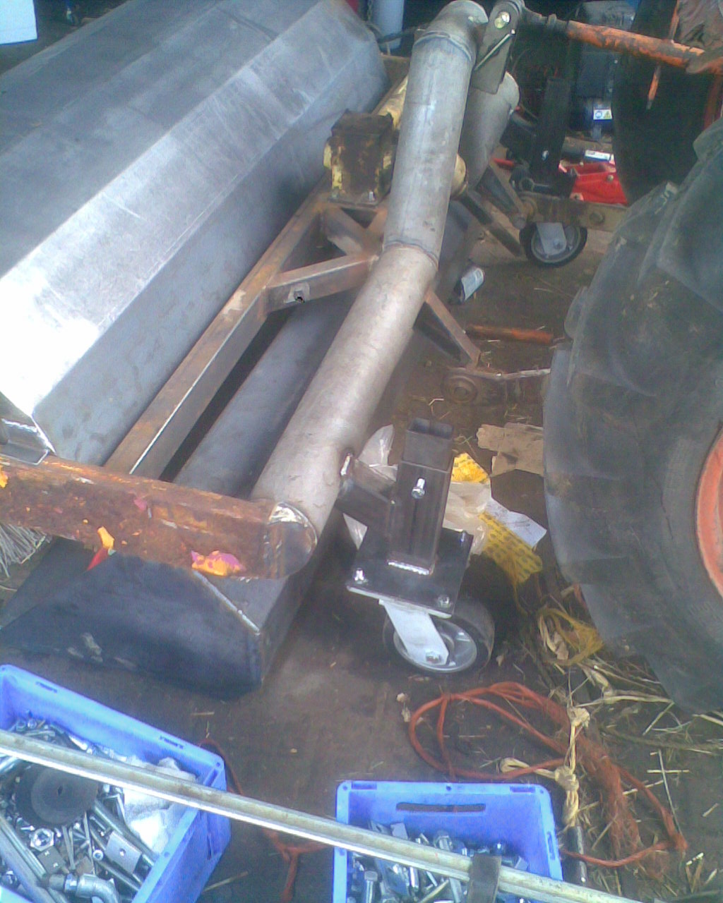

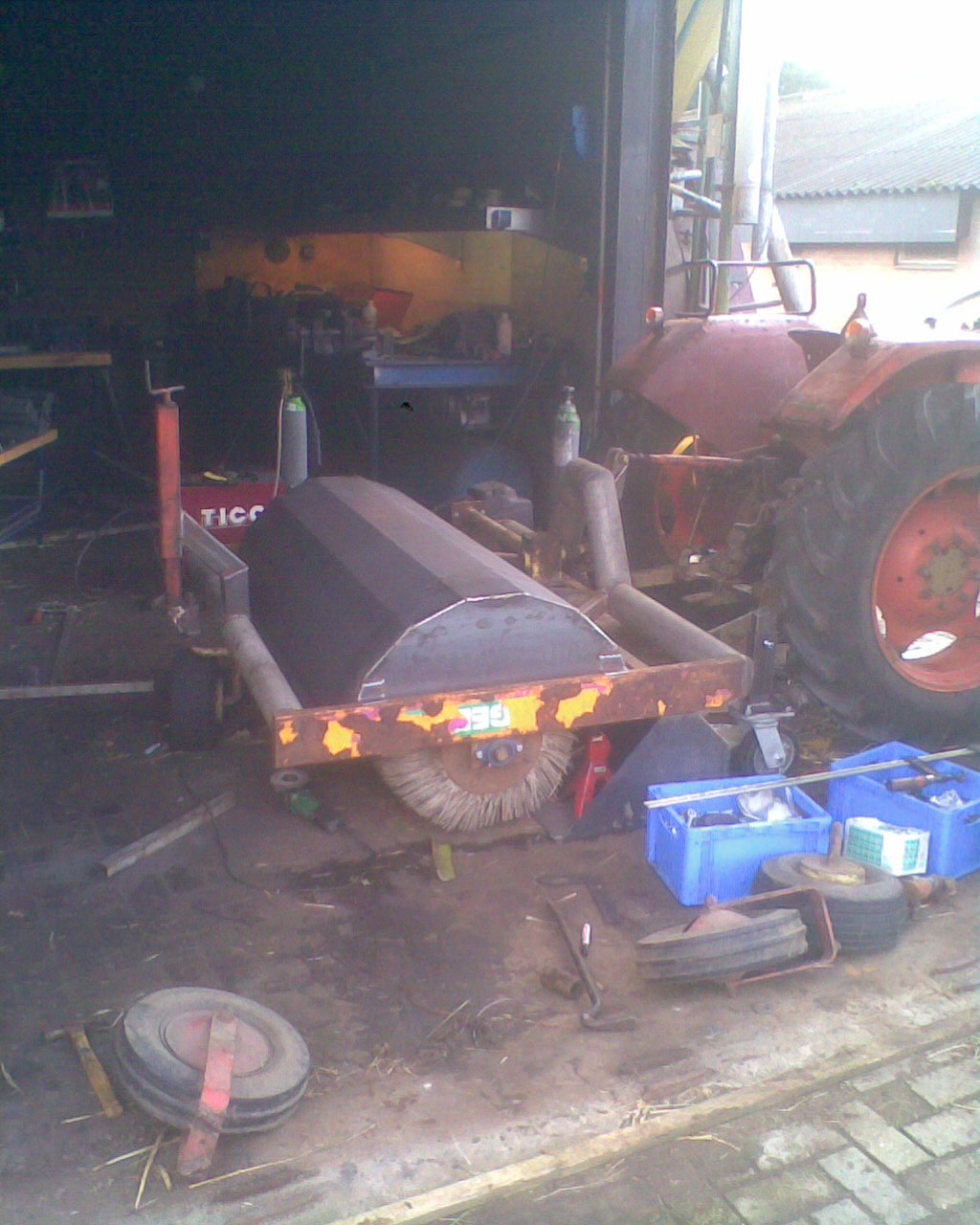

Sorry guys, i didnt take pictures from the start :p
My brother bought a road sweep for 100 euro. The brush rotor was 80% but the machine itself was an old, French built Gustin hay tedder.
It might have been doing hay for 30 years before it was converted to road sweep, i dont know if it was just plain old, or too light for its new job, but it fell apart:
i rebuilt it heavy duty style; OR actually, i built a new road sweep around an existing brush, and just transplanted the angle gearbox, shaft and sprockets from the old one.
I bought 2 new heavy duty caster wheels (600kg capacity each !) to use on the front. At the rear, i used a pneumatic caster wheel from another PZ hay tedder.
The square tubes used as longitudinal members came off the chassis of a Hagedorn self loading hay wagon.
The rear crossbar used to be a support leg of a pig feed silo, and the front crossbar/ 3pt mount used to be a light pole i could get for the taking, from the local boy scouts.
Oh, and i bought the spindle on the rear wheel from a local wrecker of ag machinery.
The only new steel is the 3mm sheet in the dirt catching bucket and rotor cover. The front cross tube including gearbox support, and the drop tubes from the front caster wheels, were also new steel
attached are some pictures, more description will follow when i have time

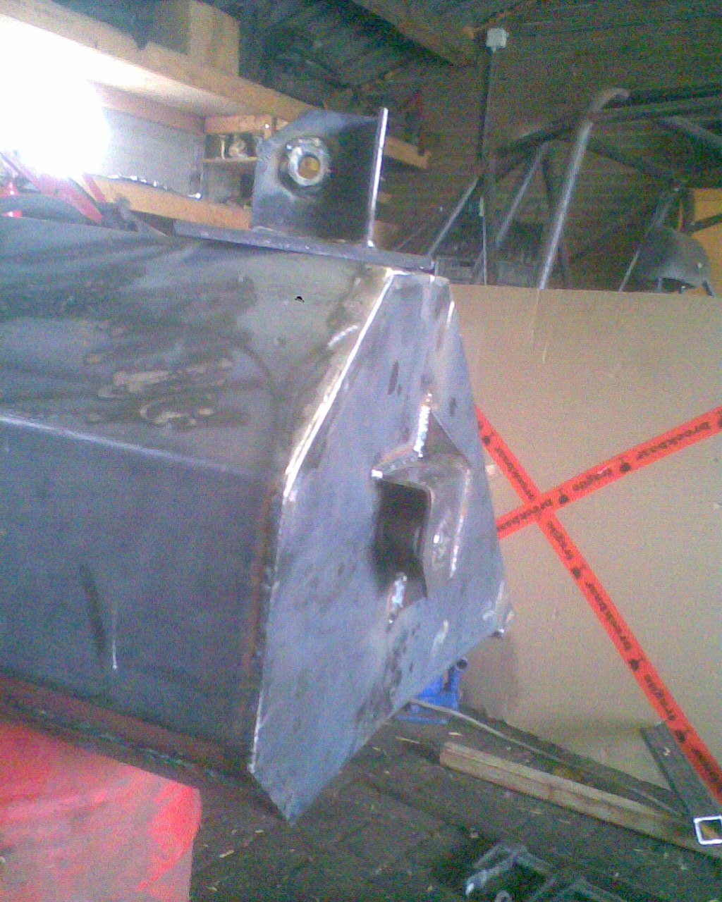

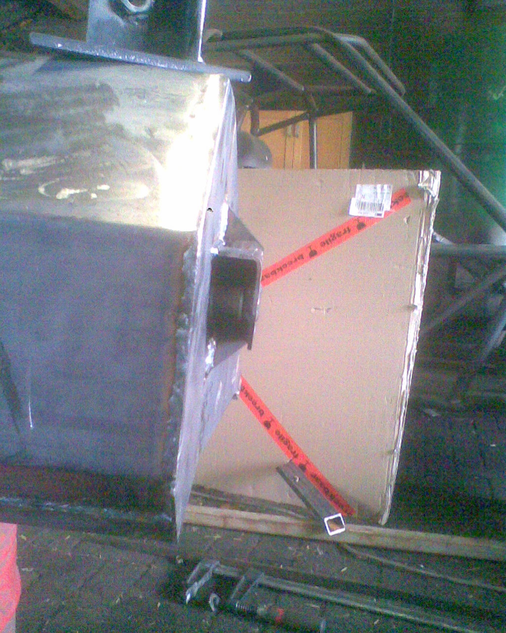

got some work done past days (i'm trying to get some rest out of my vacation, so i'm kinda slow: I am underpayd and overworked, thats why i need rest now, and will start at a new employer per septemer 1st: Both problems already taken care off ;) )

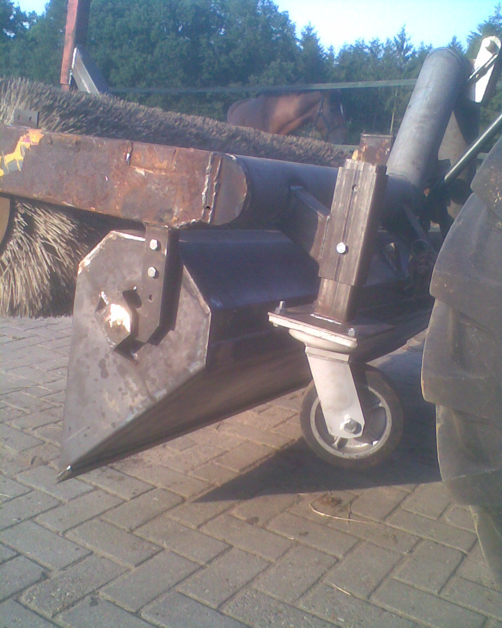

welded a strong wear strip on the tip of the dust bin: its a 70x6mm flatbar. It will take some time before it wears out when touching the pavement on occasion :)
I also welded the hinge pivots. i want them to stay within the contour of the frame, because i'll use it to sweep alleys inbetween 2 stall walls....
That why i welded an M16 nut into it. Now i can put a bolt in from the inside of the bucket, with a bushing over it so i can screw it tight against the bushing of 21 mm wide, so the hinge of 20mm will still be free to turn.
since i bought a set of taps, M4 to M12, i will add 2x M8 tapped holes for grease zerks.

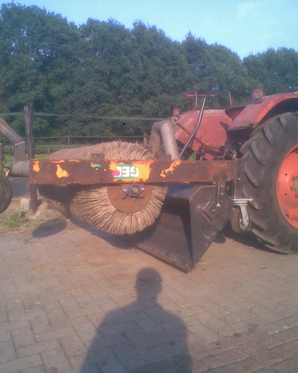

Got some work done today: Not that much work actually, but work that makes it visible where i'm going with this...
I hooked it up to my 3011 to test the hinges of the dust bin, and the latch lock:
I used an M24 bolt to make it adjustable.

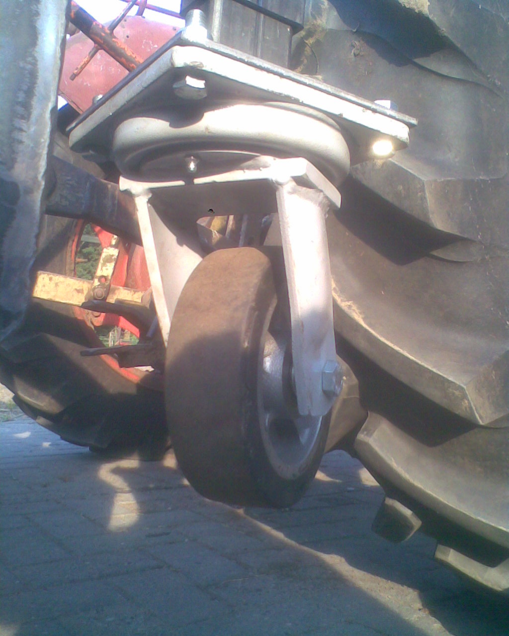

Larry,
regarding your concern:
GuglioLS said:
The only concern I have is the caster wheels on the front, do they swivel by means of a cupped plate filled with little ball bearings? Those wheels will not take much punishment (zero tolerance for impact)
In pic number 5 you can see, these are not standard duty Harbor Freight casters !!! The whole caster assembly weighs about 10 kg, and the bolt plate is 3/8" thick !
Are you still concerned ?? ;)

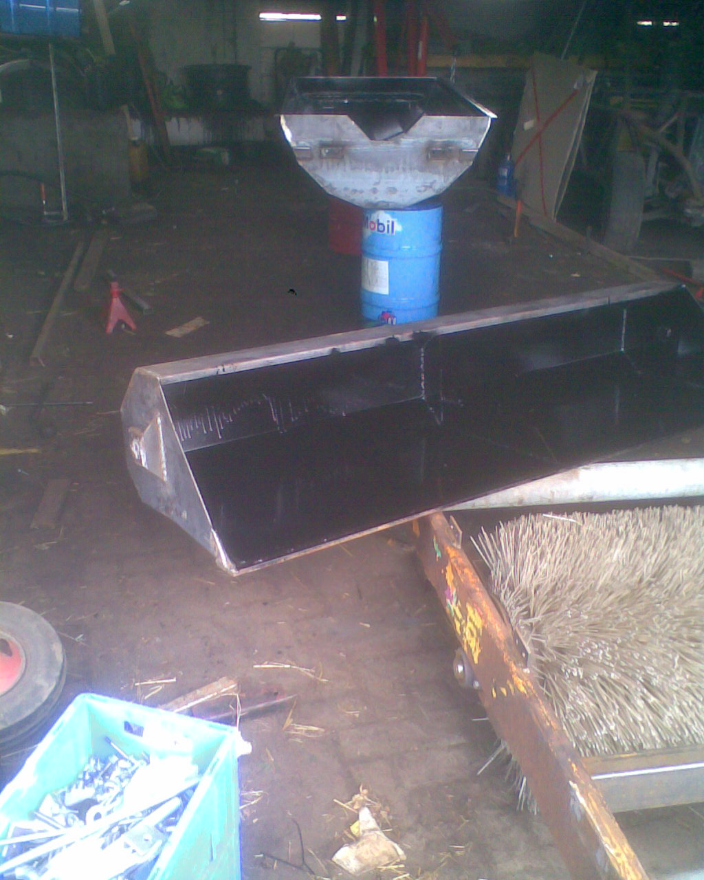

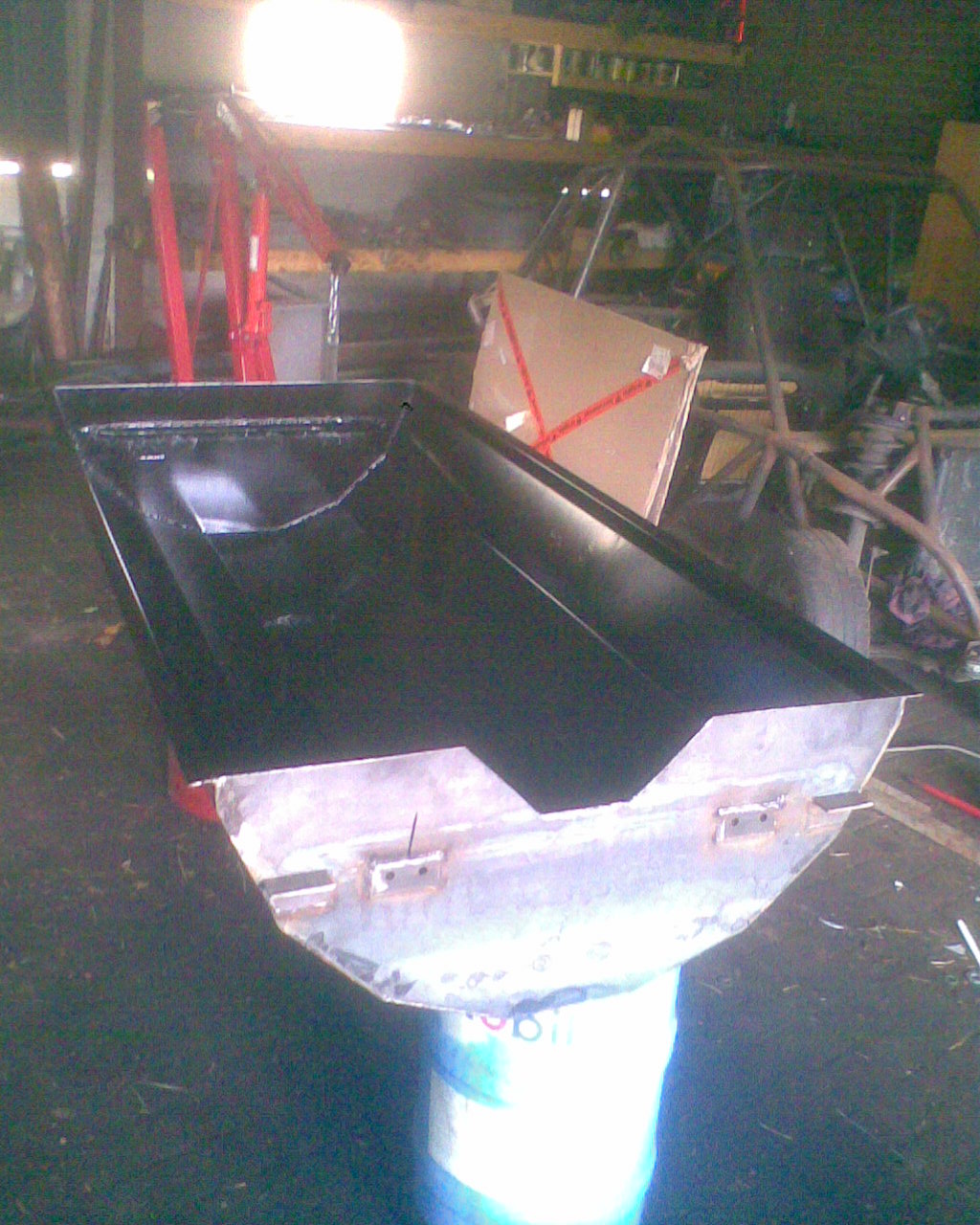

All right guys, i got the inside of the dust bin and rotor cover, painted in bituminous car underbody coating, marketed as "black varnish"
Its dirt cheap, and is so sticky that it keeps stuck on the metal even if you bend it. :)
I wanted to zinc coat both sheetmetal parts, but the zinc company is closed (We have holidays here right now in Holland) and zinc coating is 70 ct/kg which is quite expensive. Next to that, i'd have to drill holes everywhere so the zinc could flow out. Because of that, price, and time, i decided to use black varnish, i used that to touch up a reinforcement i made on the cultivator roller several years ago, it has been used to work in hog slurry, covered in mud and never cleaned, but the black sticky paint just sticks there ;)
Tomorrow i'll take some pics, monday i'll paint the rest of the machine in that nice classic "farmhouse green" colour ;)

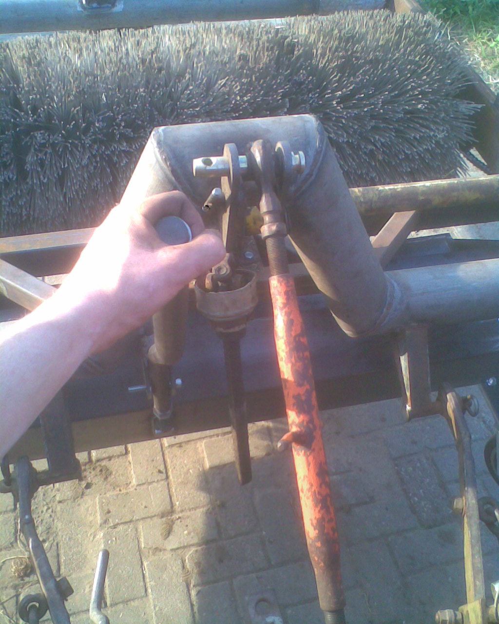

Yesterday i painted the inner sides of the dust bin and sweep rotor cover with "Black Varnish", one of my favorite paints for parts that wont get in sight, because its cheap and acid resistant, and it doesnt let go when the metal bends because its flexible, but doesnt stay as sticky as car underbody coating.

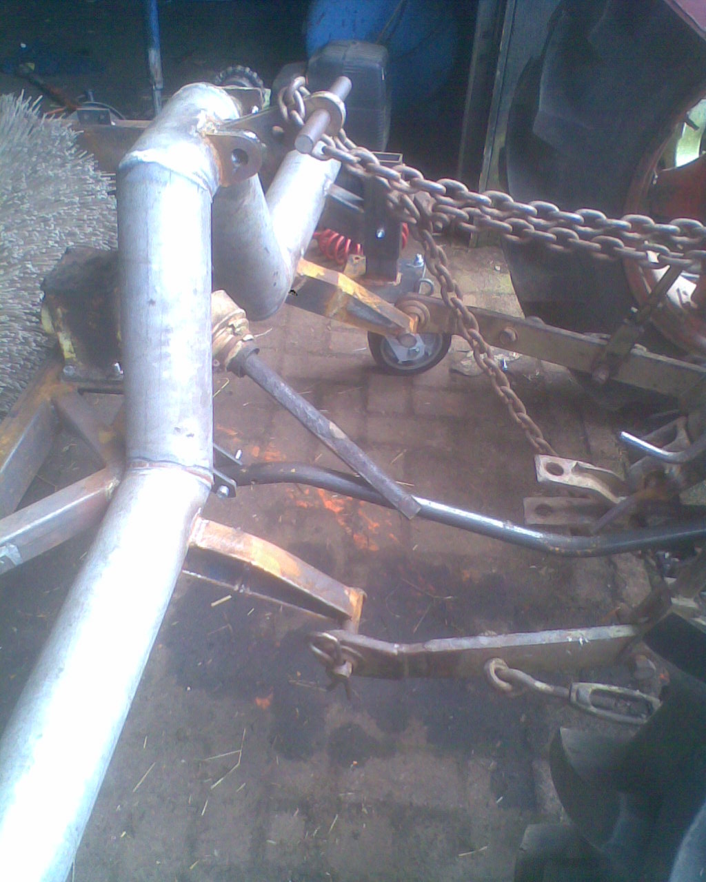

I also lengthened the 3pt lower link attachments, because the caster wheels were touching the rear tires.... Because i didnt know which materials i was going to use (that means: whichever i had available for this project) i didnt engineer the whole thing before building, even though its my daily job...
Afterwards, maybe i should have, it would have saved me 1 or 2 unpleasant surprises (dirty grinding work) afterwards...
I dropped the idea for a swiveling top link mount ( so the sweep follows the street contour on its 3 wheels) because it is hard to achieve when lengthening it once more...
The two laser cut plates i had for the swivel toplink mount, i just welded them flat against each other. I will use a chain as toplink, it has unlimited swivel and is much easier to make ;)

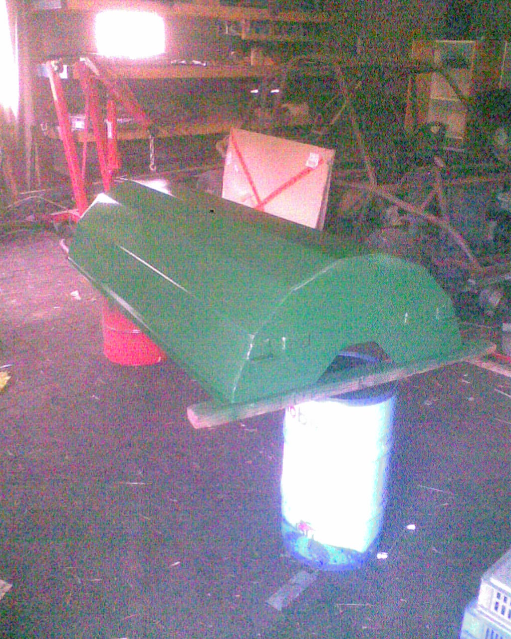

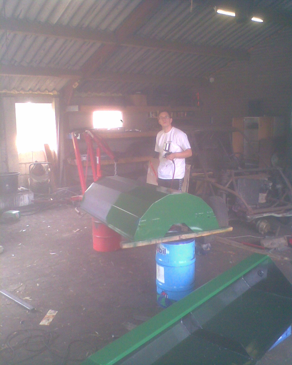

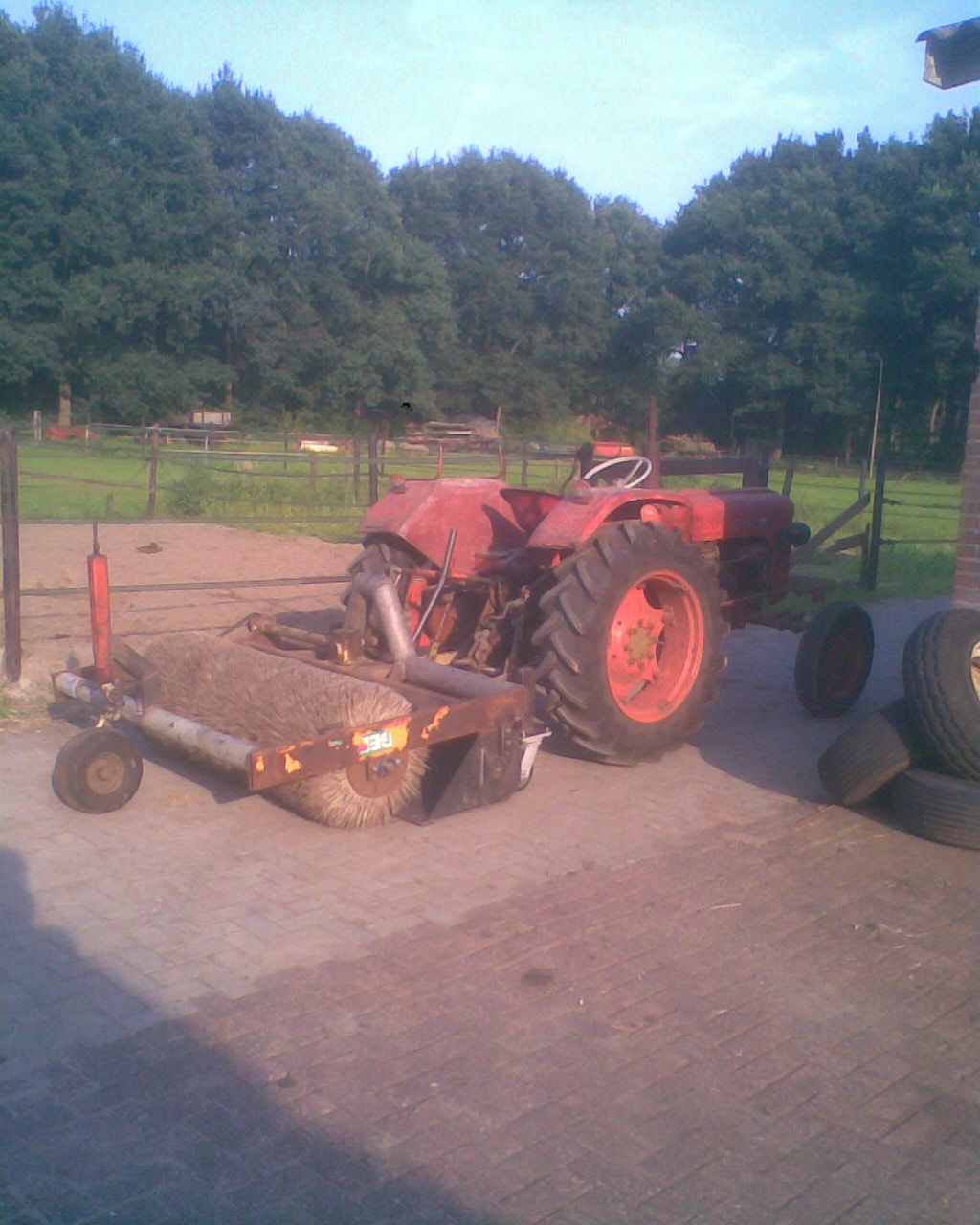

Today, the holiday also begun for a friend of mine. I was glad he helped me, and its a lot more motivating when you see the work progress of 2 people in a day ;)
He painted the outsides of the sweep cover and dust bin, in the same "farmhouse green" as i painted the bale trailer last year: I decided this will be my factory colour for everything i build from now on. ;)
We also spent some time derusting the frame. The longitudinal frame tubes were cut out of a self loading hay wagon, and then spent 8 years rusting under the bush.
My brother (who is the ultimate customer, because his horses make a mess, he needs the street sweep so he pays materials, but because its my hobby, i do the work ;) )

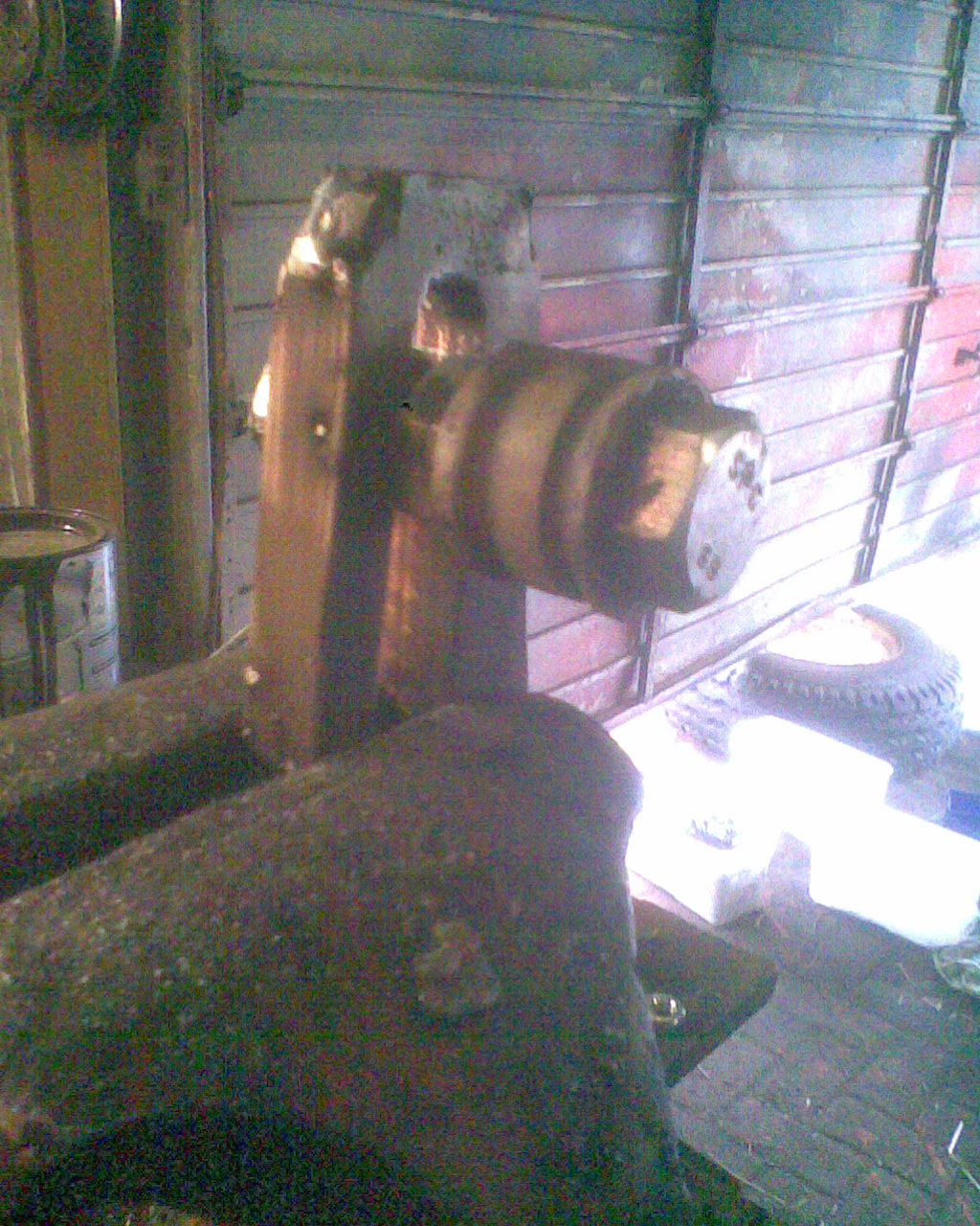

In the evening, i prepared an improvised chain tensioner (a nylon bushing running around an M20 bolt, bolted into a slotted 20mm plate)
