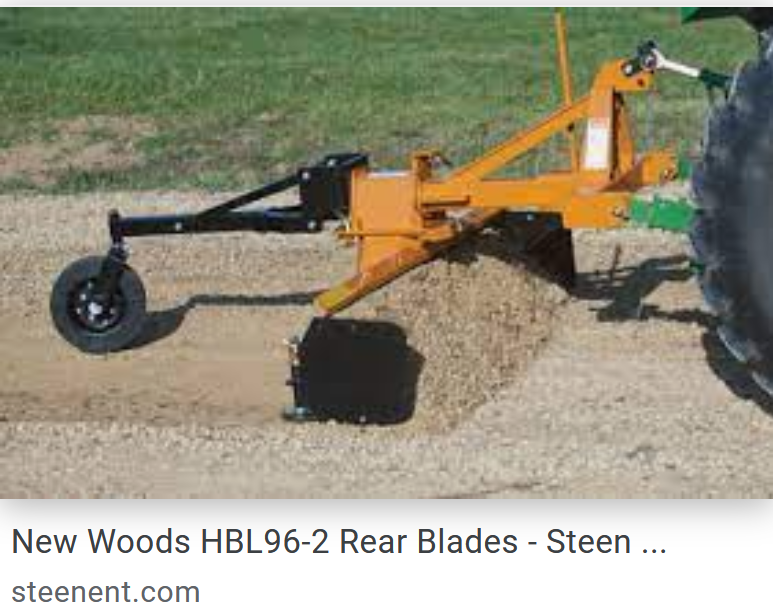

I would recommend a heavy rear blade with a guide wheel (Woods makes a dandy) to maintain the road surface/crown

MtViewRanch - post#4 - hit the nail squarely on the head. EXACTLY what I would recommend. I have a Kubota M6040 - heavy duty Rhino rear blade and heavy duty Land Pride - land plane grading scraper. I also have a mile long gravel driveway.
With the HD rear blade - no need for a blower. I have a couple serious "drop offs" on my driveway also. But NOTHING like your video shows.
As far as equipment costs - the rear blade, $3700 - - the land plane grading scraper, $2250.

Road grader and good operator to clean ditches and fix crown and slope (maybe every 5-10 years). maintain with a land plane, minor repairs with a rear blade.

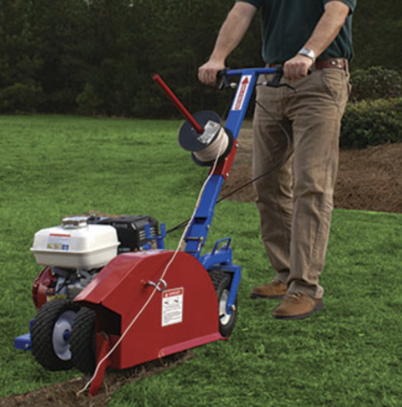

Not at all unlikely. Rural cooperatives often run copper phone lines with a walk behind trencher at the edge of the road. When I moved into this house that’s exactly how they ran the phone line from half a mile up the road. Thankfully we now have fiber up on poles.
