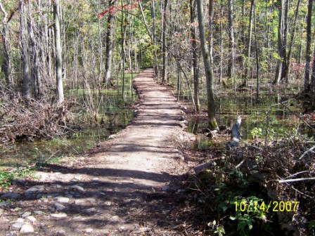

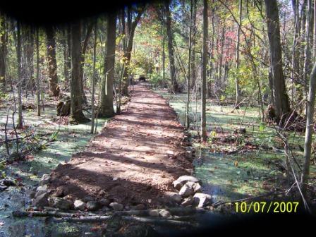

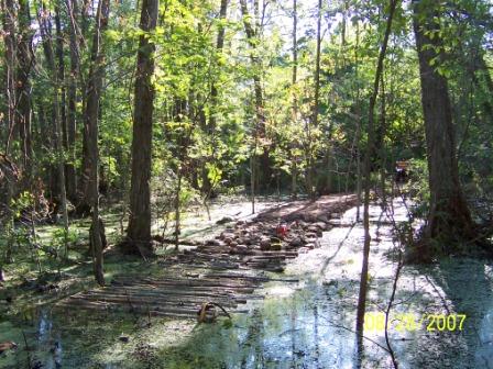

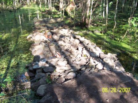

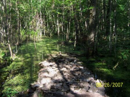

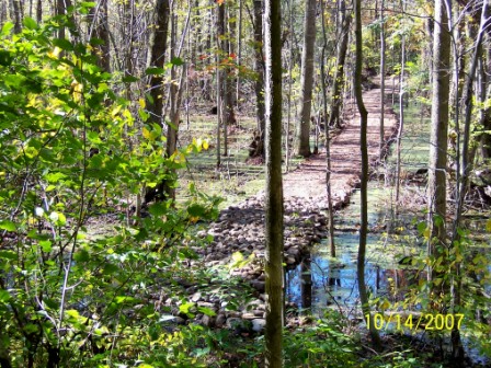

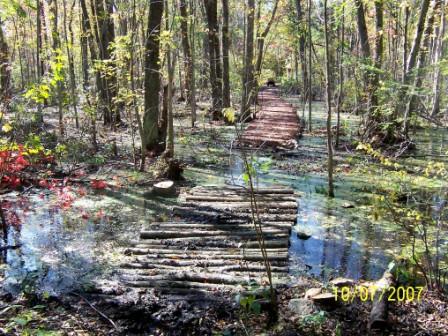

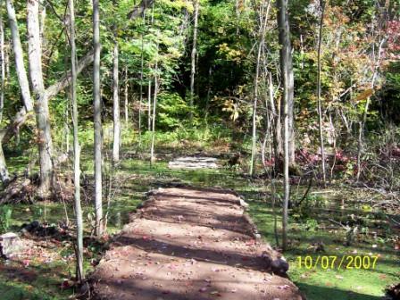

Here are some pictures of my summer project. Beavers built a dam on neighbor's property, flooding 6-8 acres of my wooded land, and causing loss of access to part of my property.
I put 6'-8' logs in, covered logs with field stone, then covered stone with dirt/gravel. The earth moving/leveling was done with FEL and box blade. I started out moving the field stone in the FEL, but found it was more efficient to use my 4-wheeler (see a Gator HPX in the future). Water is about 3' deep in deepest spot, average is probably 18".

Thanks, Mac, I estimate it's about 80 yards across the "swamp". The logs are from trees in the flooded area, live trees which would have died. I think if they are submerged, they won't rot out in my lifetime. If they do, it'll give me more seat time.:)

They make good fill, and I had lots of them available. Also they make a "level" base under the rocks. Without the logs, it was taking too many rocks and too much dirt. I piled field stone on top of the logs until the stone was above water level, then covered the stones with dirt and packed it down.

I didn't realize that a submerged log will not rot as fast as one that isn't submerged.

EastTNFarmboy: Once they get exposed to air and sunlight they rot pretty quick.

When I was a teenager, a buddy and I used to trap beaver and muskrat, so I know a little about their habits. Tearing out the dam just causes them to work all night to repair it. It wouldn't take long for more to move in if they were trapped out. My wife and I decided to accept the change and adjust to it. We are getting a lot of waterfowl moving in. I lost access to a hardwood ridge so that's the main reason I built the road. It was a nice project, lots of fresh air, excercise, and tractor time.

I'd be guessing if I tried to estimate the hours. I worked on it all summer, when I had the time, after work and weekends.
The road runs east to west, I started on the west end, so that end is packed down from all the repeated trips. I ended up moving the stone in plywood boxes mounted front and rear on my 4-wheeler (Yeah, lots of hand work). The logs were floated or hand carried. They came from standing trees in the flooded area. The dirt came from banks on either side of the swamp (mostly from the west end, until I could get the tractor across). I used the boxblade to loosen the dirt and moved it with the FEL. I leveled the road with the FEL.
I'm anxious to see how it holds up through the winter; I expect I'll need to do some work on the east end, since it didn't get packed down as much. (More seat time:) )

Not to be contrary, but my first thought was that the logs would decompose as well. Why is it that since they are underwater they won't decompose? I know they don't have the air or sun, but I would still think they would have to decompose relatively quickly with wet dirt in contant contact with them.
/ Road building with 2305 #13
An often overlooked fact: Water does not cause decay, oxygen does. Oxygen is not as free to move from water to wood as it is from air to wood.
Very interesting. I learned something today. I suppose I should have known it already!
