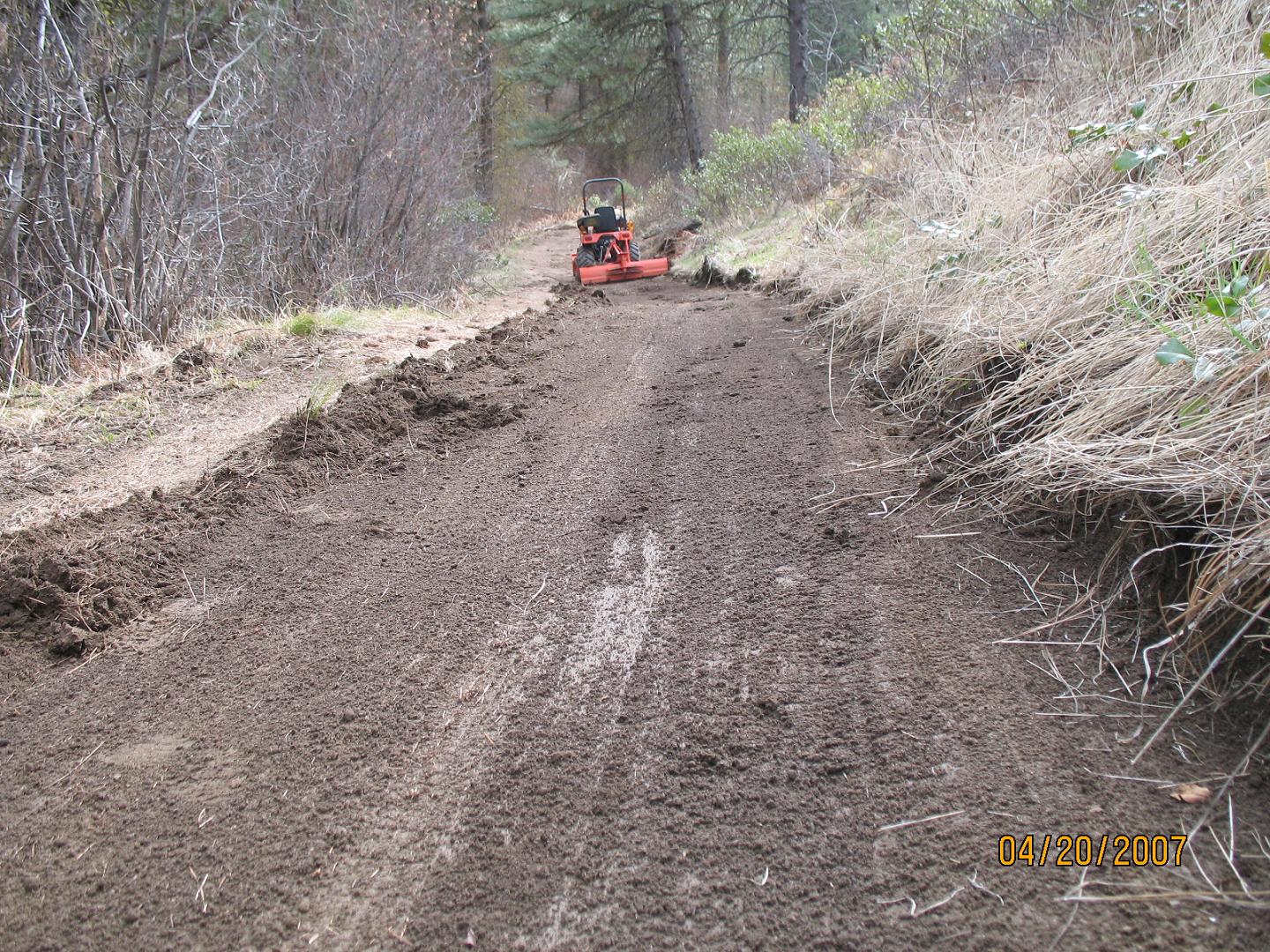

/ Road and Driveway maintenance #19
I must be missing something. I've owned box blades and rear blades and the rear blade always seems easier to use for long stretches that need to be smoothed out or aggressively graded down. You can also flip the blade backwards and simply smooth things out with no digging.
I had a BB first but once I bought a rear blade, I never used the BB again.
