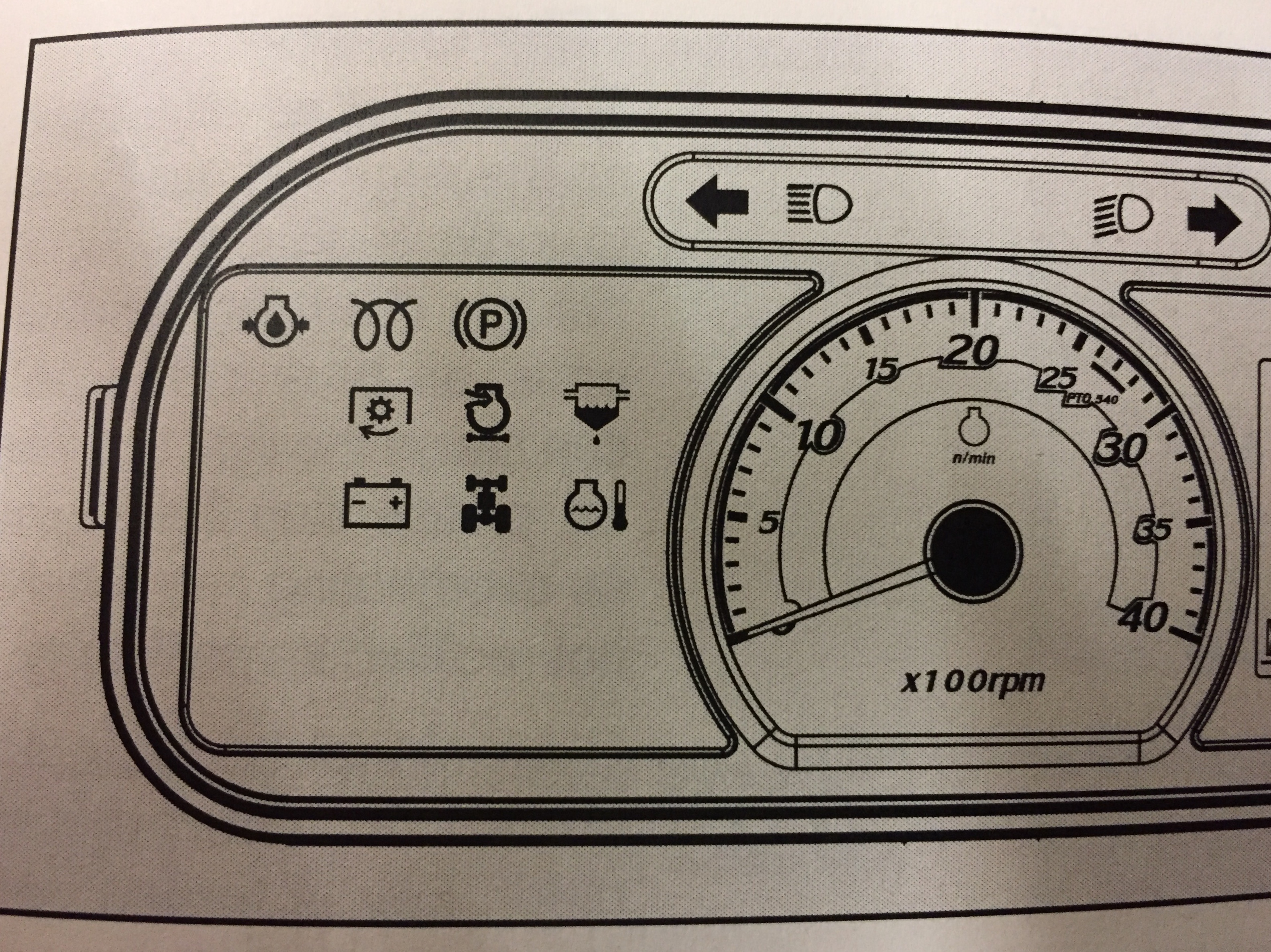

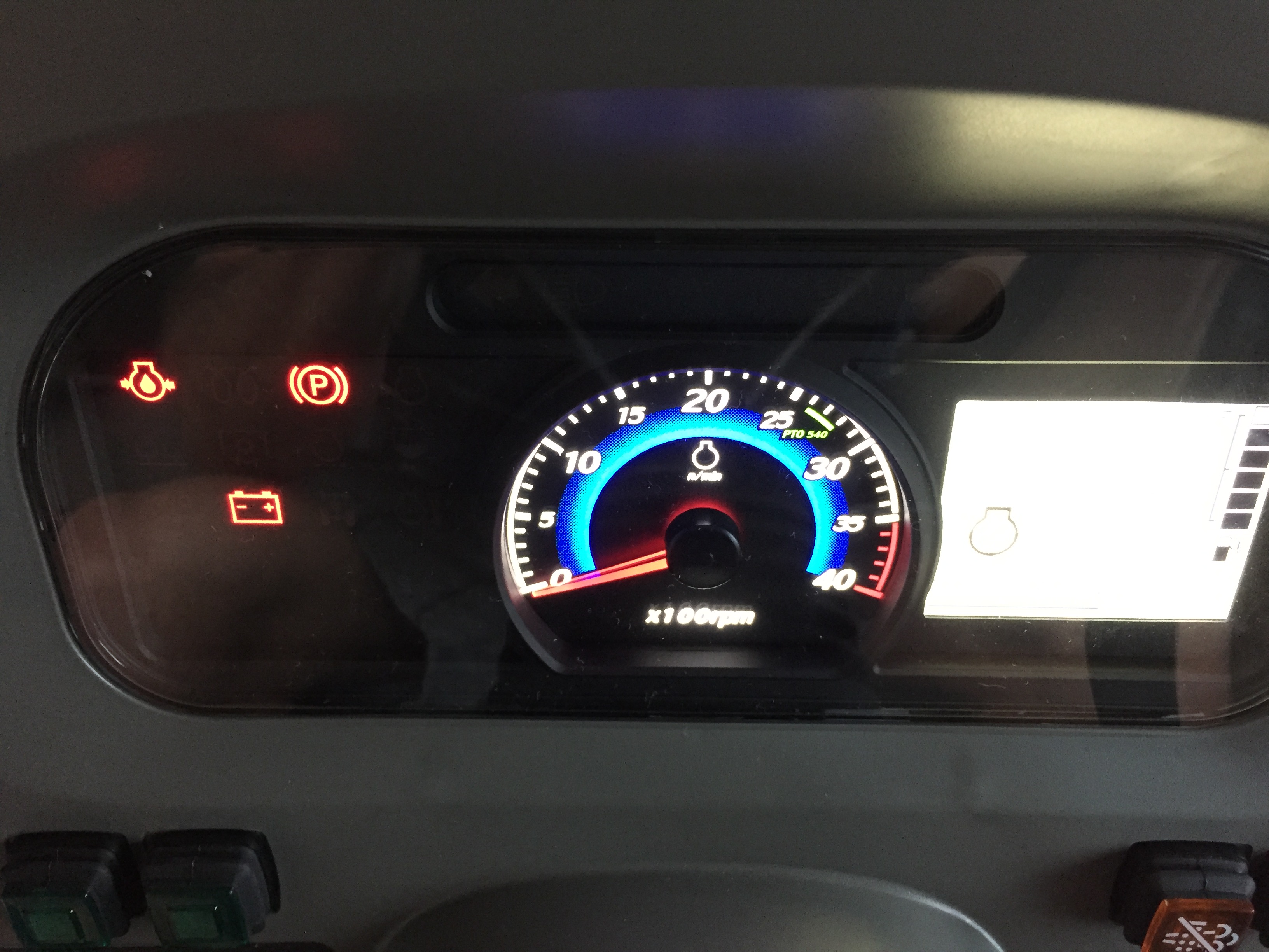

My manual says to turn the key to the On position and wait for the glow plug light to turn off before starting the tractor.
I have seen no such light, as indicated in the attached pic. According to the manual, it should be just to the right of the oil pressure lamp, which does illuminate when my key is in the On position. Anyone actually have the glow plug lamp?

We definitely have a glow plug indicator. It comes on when we first turn the key, but goes off pretty quick, then we start the tractor. I does stay on a little longer when it's really cold, though still only a few seconds. I've not tried to start it in single digit weather or less, so not sure about that.

Update - my light does work. It just shuts off with all the other accessory lights a few seconds later. I was expecting to see it still illuminated after everything shuts off, and thus didn’t see it all amongst all the other lights.
