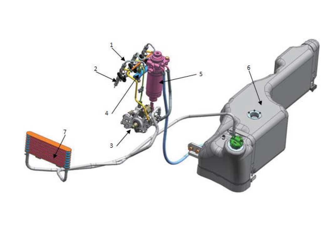

How exactly do the fuel coolers work. Just air to liquid like a small hydraulic cooler?
   / RK55H Hot Gas Tank #22
On a tractor, it's usually just a smaller radiator in front of the engine coolant radiator.
Here is an example. Just happens to be from a LS tractor.
