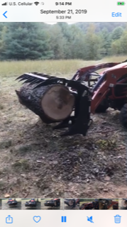

Is a grapple worth putting on an RK24? I don't think the 24 has the power to handle the grapple, am I wrong? Mike morgan uses anRK37.
Mayflower, I have a grapple on my RK24 & it works like a boss! I cut a lot of firewood (not to Mike's capacity. Lol!) & actually used the grapple to help skid some of the logs that were just off of the trail. Hopefully the pic comes through below if not, I will send it to you in PM.
The log that in the grapple pic is a red oak that is cut 4' long & about 20" in diameter. The 24 with the grapple lifted & moved the log without so much as a mild "grunt." I would definitely purchase the grapple with the 3rd function valve if starting over again with another tractor.
