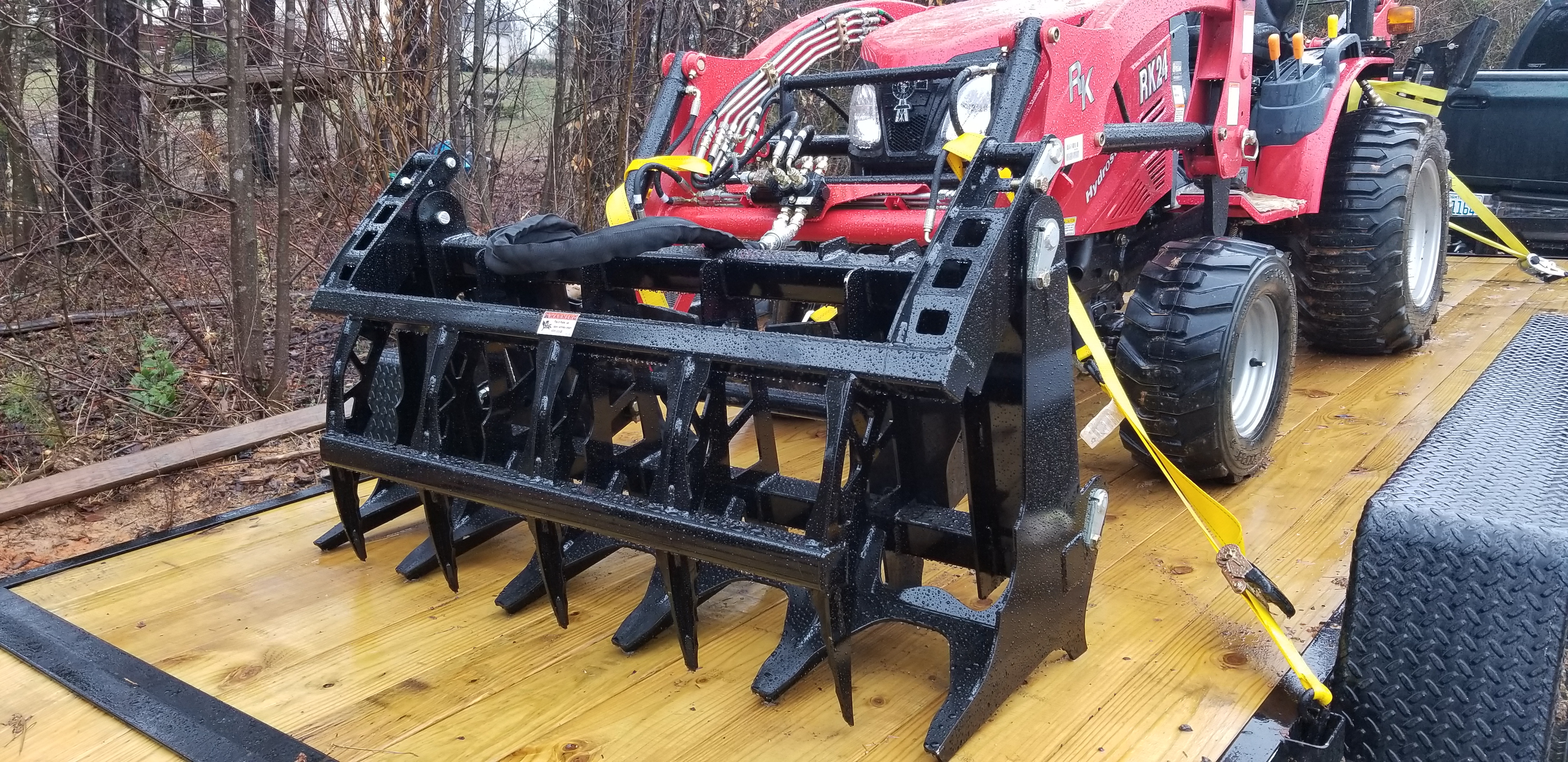

/ Rk24 grapple status? #6
I got mine about 2 weeks ago. I had RK install the valve. I must say I was a little dissapointed when the tech came to me and told me they sent the wrong fittings and connections. He was able to piece a solution together. After approx 2 hrs of use Ive noticed due to the position the QD wants to unhook. I have put an elbow in it and it appears to have resolved the issue. Out side of that, my experience with my salesmen Chuck, the tech Jessie I believe and RK in general was pleasurable as it has be in the past. The grapple itself, its awesome. Works great. I can't wait to really get going with it. This NC weather is killing all my plans. Will keep you posted.

/ Rk24 grapple status? #8
Looks great. I get my grapple installed in 3-4 weeks. Mind posting pictures or video on its operation?

I find it incredibly useful. No, it will not tote logs like Mike Morgan does. If you are looking to move saw length logs you may want to consider another choice. I don't have that need so I just cut them into small lengths. It has proven to be worth its weight in gold for clearing/cleaning brush piles also. One thing to note is, the way the route the hoses combined with the quality of the hoses leave a lot to be desired I wore through all 4 hoses in essentially the same spot at the same time. When I went to replace them all the replacement hoses were considerably thicker OD and made it a tremendous task. Add to it that it was like a $250 fix it was a bit frustrating. I can not give you a comparison to another grapple and this may be the case for all of them. I do not know. Just seems like that was an oversight. Other that I am very pleased with it.

I removed the hoses from inside of the lower tube on my granite grapple and moved them to the top of the grapple. I welded a u- channel across the top and inserted them in U- channel for protection, then drilled four holes to drop bolts into behind the hoses so they couldn't fall out of the U. This put the fittings in a location that I could keep an eye on them and if they needed tightened, made that job very easy. Unlike that little oval hole in the bottom rail, the whole hose system can be seen and worked on!
