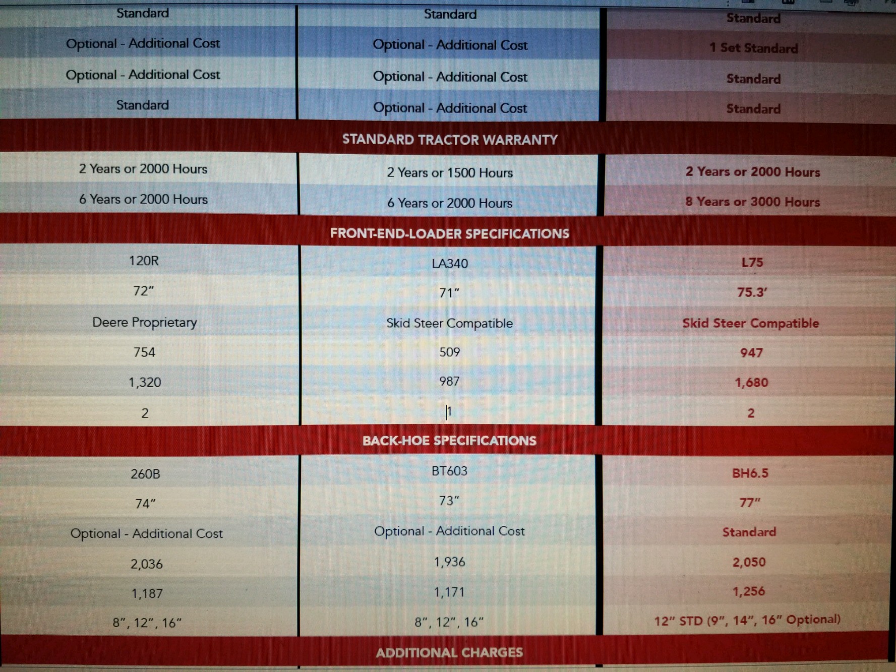

I see you do have the 24" behind the 3-pt specs when you click on the tractor specifications on the main page which is good. However, it looks like you have some discrepancies on your Full Line Brochure in your comparison section:
Kubota BX23SLB-R - "Lift Capacity to Full Height - Bucket Pivot Pin (lbs)" should be 739lbs not 509lbs.
https://www.kubotausa.com/products/tractors/sub-compact/bx23s#specifications <-- Kubota spec page
Kubota BX23SLB-R - "Breakout Force (lbs)" should be 1407lbs not 987 (987 is 500mm from pivot pins)
https://kubota.ca/getmedia/8309effd...X23S,-LA340,-BT603-OPS-EN-K289271213?ext=.pdf <-- See page 32 for correct specs

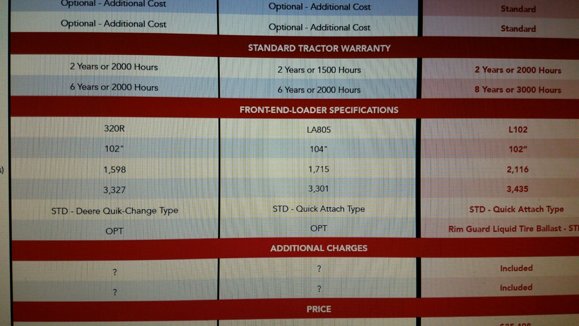

Kubota L3560HSTC - "Lift Capacity to Full Height - Bucket Pivot Pin (lbs)" should be 1720 lbs not 1705
Kubota L3560HSTC - Max Lift Height" should be 105" not 104"
https://www.kubotausa.com/products/tractors/compact/grand-l60#specifications
Please explain.

Thank you for posting this on the RK Tractors forum! We appreciate it.Just as with any competitor comparison, we document the source by date and time and file it, and as with any company, our published materials have disclaimers that state specifications are based upon what is public at time of publication. If competitive comparisons could not be made without this point in time flexibility, no one making any product of any kind could make comparisons to any competitor. Hope that is a reasonable explanation to you. The point of our competitive comparisons to Deere and Kubota is that we offer a very good tractor for thousands less. That is a debate we’d love to engage in.
https://kubota.ca/getmedia/8309effd...X23S,-LA340,-BT603-OPS-EN-K289271213?ext=.pdf <-- This one says printed in 2016. I found it in less than 2 minutes. Just saying.
Yes, you are offering a great price on your RK tractors and they seem to be really nice. Might be a good idea to correct these comparison sheets though. Doesn't look good.

We take directly from the Kubota USA brochures on their website and keep in mind we compare the quick attach version of the Kubota LA340, now LA340s in some literature, LA344s in other. The LA340 pin-on specs is what you quote. RK L75 on the RK24 has quick attach standard. We review all competitive comparisons at each time of publishing, so we move when competitor info moves. We also do not publish the actual lift capability of the RK L75 loader, which is much higher than we state, we list only what the tractor/loader as a system has as a max. On the larger Kubota LA805 loader, guilty as charged, Kubota most recent spec has lift at pivot pin of 1720, we had it at 1715 (not 1705), and max lift height, we had at 104” and latest Kubota spec has it at 105.” Five lbs and one inch discrepancy, and because there was a change on the Kubota materials. We will update at next publishing as we do each time.
