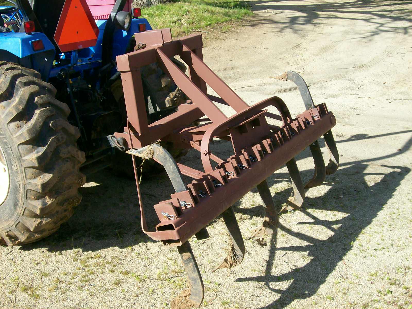

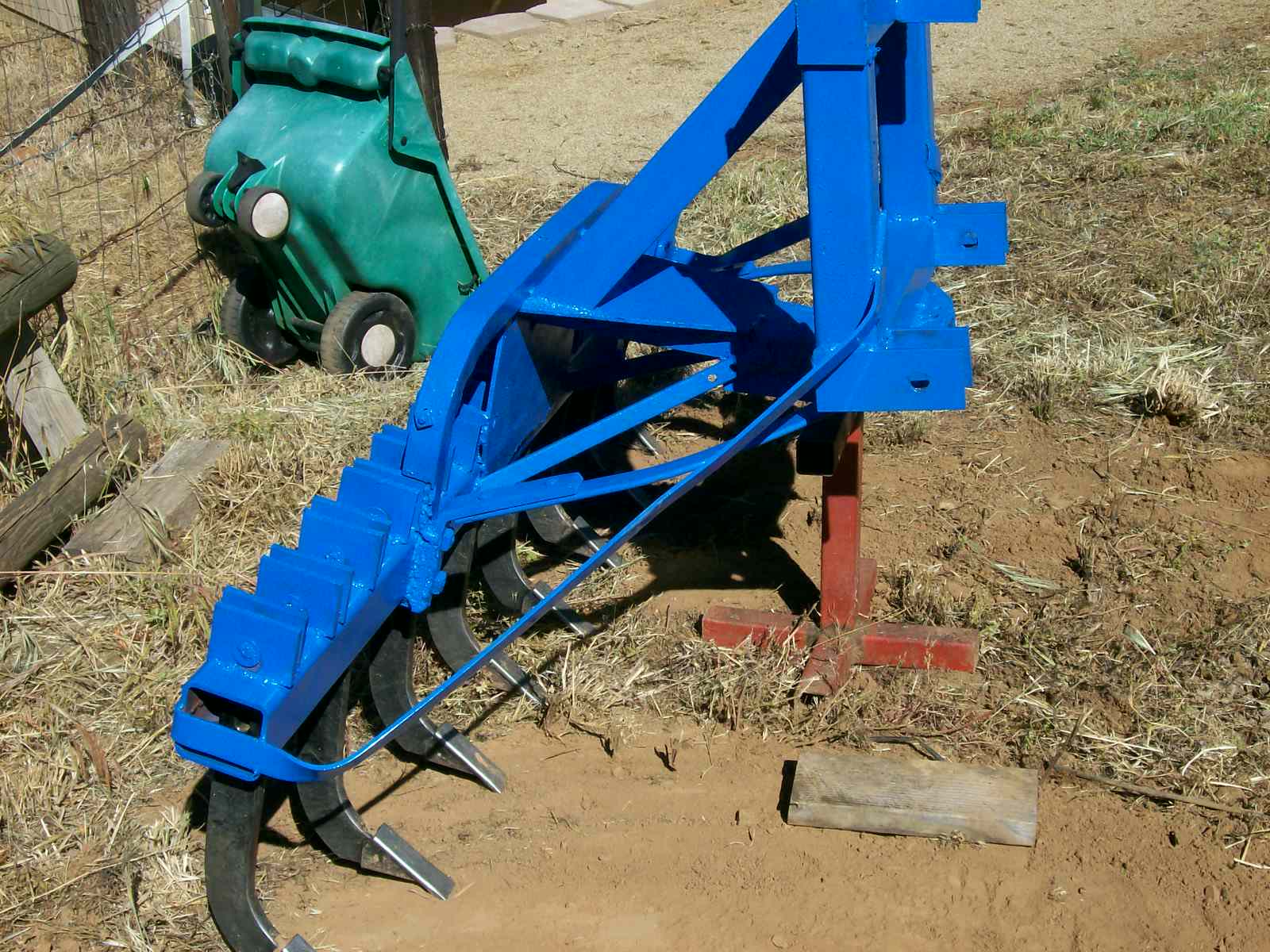

This is a ripper I built after I tore apart a old double gang pull disk . We added the 3 point box frame to the front which sits on top the 6" x 2" x 1/4" channel of the main frame . Next , using my plasma cutter , I cut apart the back end were the gangs / bearing blocks were attached . Then it was just a matter of cutting 15 slots top and bottom into the 4" x 4" x 1/4" tube and welding it the the back of frame . Added the Pin plates on top the frame on both sides of the slots and made my own pins from round stock . Although there are 15 slots , I only pull 8 scarifier's at a time , they are 18" ones from Agri Supply . TC30 does all right with the 8 as long as I go side hill or down hill in the Clay soil we have here .
Ended up adding the two 3/4" braces from top of 3 point hitch down to the back of the main channel as that part had holes on the side from a couple of braces and started to crack .
Have primer on it , just waiting for it to warm up to add color . It has worked awesome though . Use to have to make multiple passes with my 6' KK disk for firebreaks around edge of property and down driveway . But with this , I make 1 pass with it and 1 with the disk . Have recovered many 10" to 20" rocks that the disk use to ride over and also pulled 6 sections of old 10" concrete culvert out .
Fred H.

that is pretty cool!.. Good build.

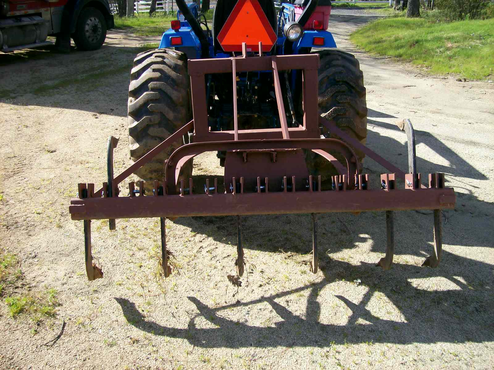

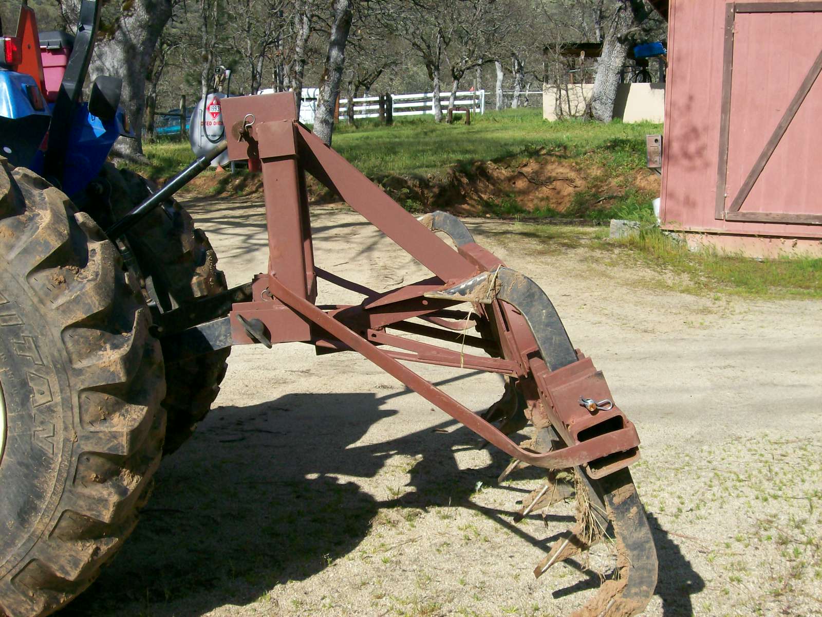

   / Ripper without box blade
Cool Yes , Good Build ???? Please notice the pictures are not TO Close !!!:D
Cannot let others see my welding or maybe my attempt's at welding .:D

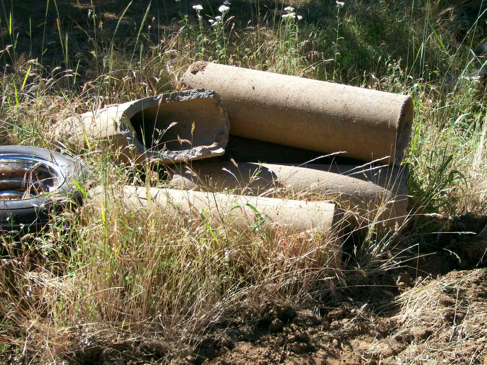

Although so far it has stayed together even when pulling up that concrete culvert . My reason for going this route was I have a blade , so I seen no since in getting a box scraper just to use the scarifiers .
Being a truck owner / driver , I try to K.I.S.S. , ( Keep it Simple Stupid . Stupid meaning " Me" ) , thus I like to use my disk rather than my brush hog . Disking is a " No Brainer " type action , just don't run into anything with the tractor . While mowing requires a thought process , which I some times come up short on . Picture below is a section of the back skirt on my brush hog that I had to cut out and replace when my neighbor backed into a tree while mowing , ( Seriously , Was not me that time !! ) .
Thanks for the Compliment , Appreciate it .:)
Fred H.

Fred Nice build, dont worry about how the weld looks,.. penetration is the important thing, when in doubt,..Turn up the heat,.. and pratice, Eric

Well as per my first post about K.I.S.S. and about removing FEL . We have had our tractor for 9+ years and although it is a quick release FEL , I have never tried . Why ??? Cause more than likely , I would be posting pictures here asking for help on how to put it back on .:laughing:
All the steel was used / recycled from local scrap yard , except for a little of the basic structure that had been the original pull disk .
Phones lines ??? Give me a shovel , a man powered post hole digger , our back hoe , etc...... , and I can find our local phone companies line . I have cut ours several times in the driveway , have found but not cut in field putting in a post and cut about a foot out of neighbors while redoing my corner posts of field fence . Average depth is like 18" . It was all contracted out to a private company so since it usually is never the required depth , ( 36" ??? ) , it is always repaired for free .
As stated by others , ripping it first , then second passing with 3 point kk disk really works up nice so it saves time .
Thanks all for the comments , I appreciate it and also really like reading others ideas or projects .
Take Care ,
Fred H.

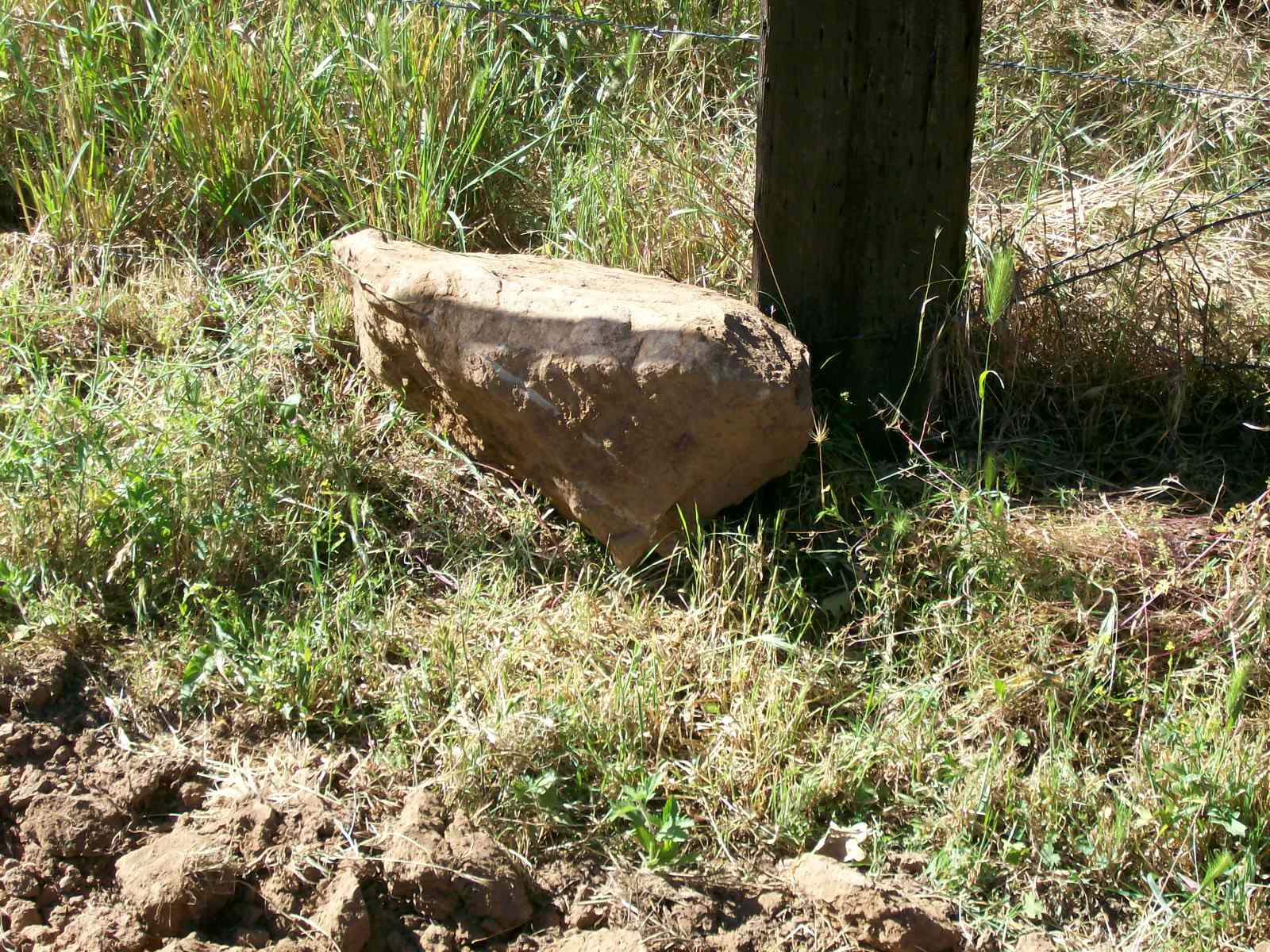

Pictures after adding color and of some items I have pulled out with it .
Ironically , Rustoleum blue is pretty close to New Holland Blue .
Fred H.

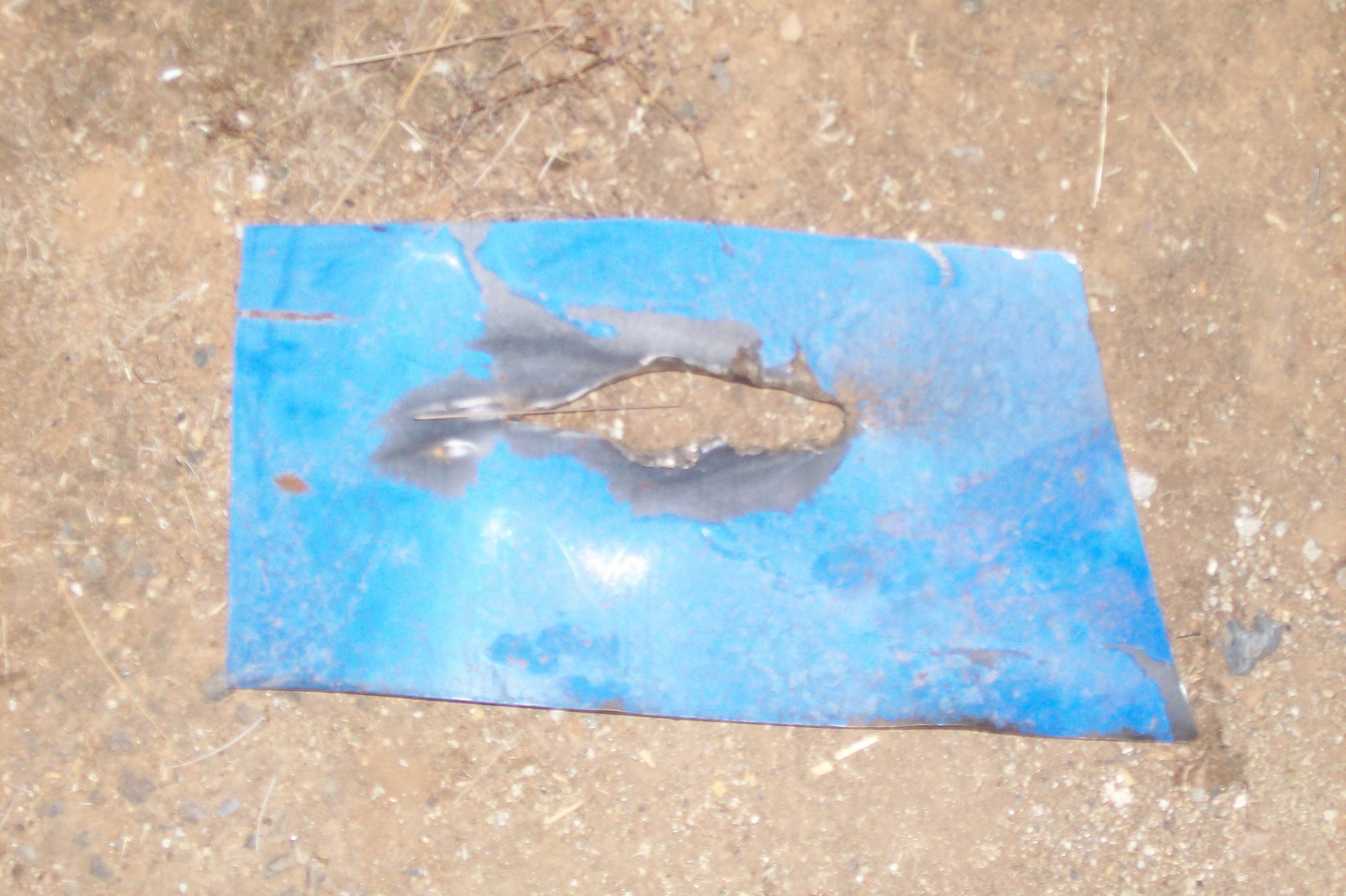

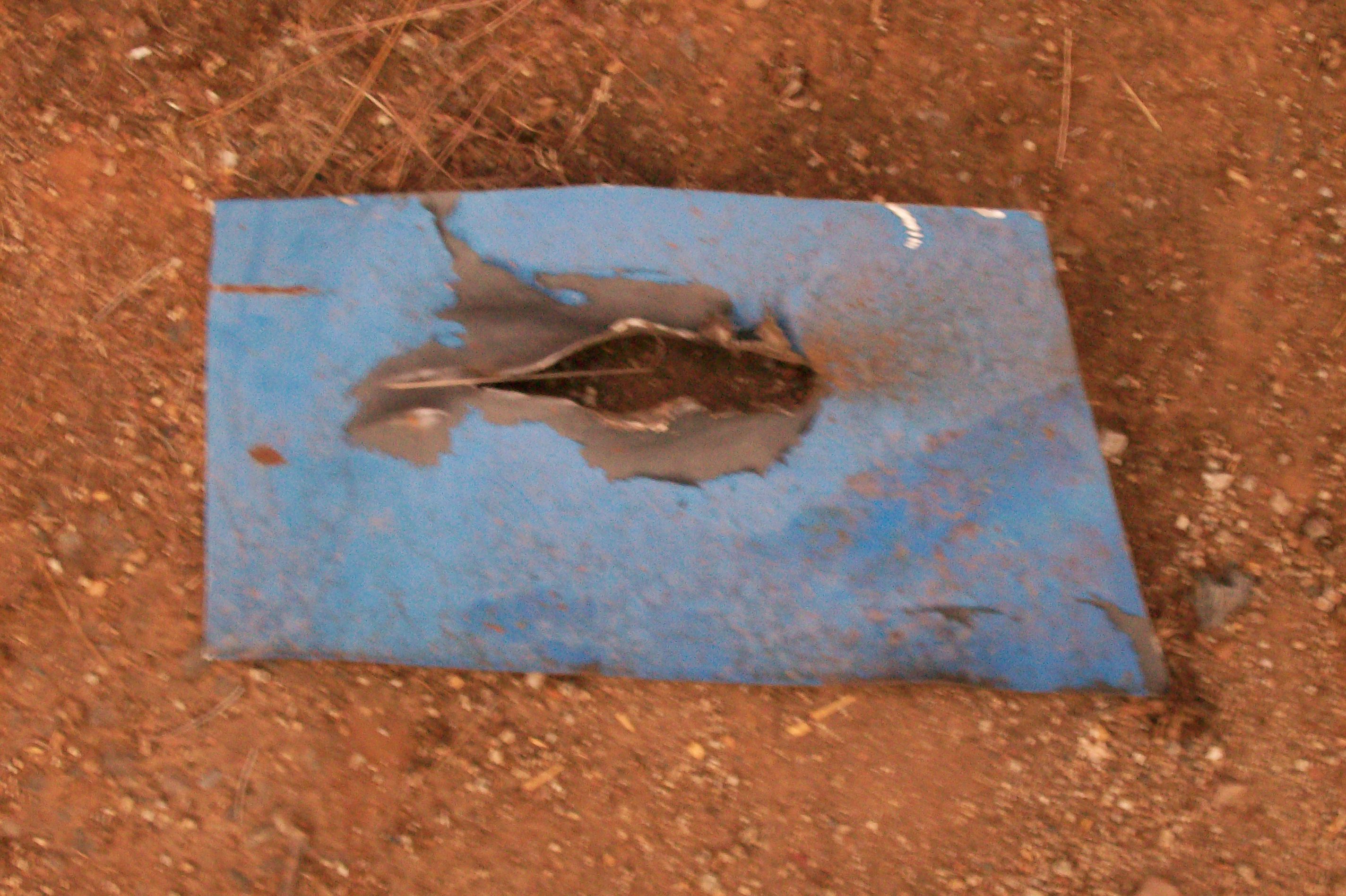

Tried beating it back down but it required two people . One to hold the railroad iron as a anvil then other to swing the sledge . Now , since I go elk hunting . I really value my hearing and even with plugs in my ears and my shooting muffs on , it was EXTREMELY LOUD under that brush hog when my neighbor hit it with the sledge just 1 time . That and the fact that his AIM did not seem to be to good with that first shot made me skeptical of that idea .:cool:
He wanted to try and hold the rail iron , but I had some thin plate steel laying here anyway , so rather than hassle with beating our brains out or wasting oxy/acet heating it first , I just took a grinder with cut-off wheel and sliced out the bent and damage area and replaced . Thus " KISS " came into play by simply not over thinking my objective .:thumbsup:
Fred H.
