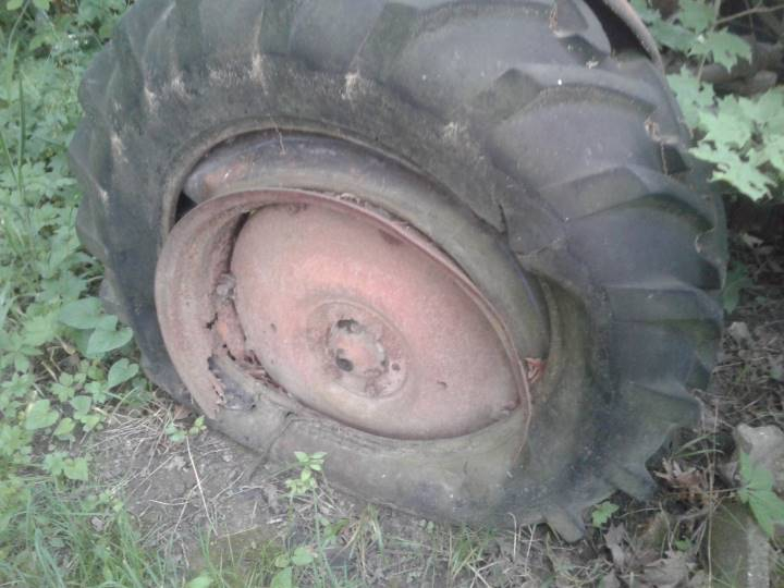

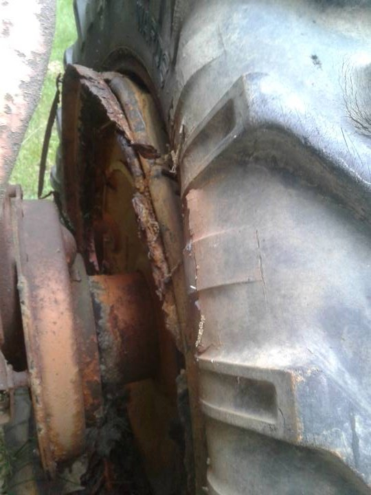

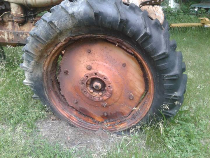

I don’t know how long it takes, but I do know that CaCl will rust your rims eventually.
2nd that

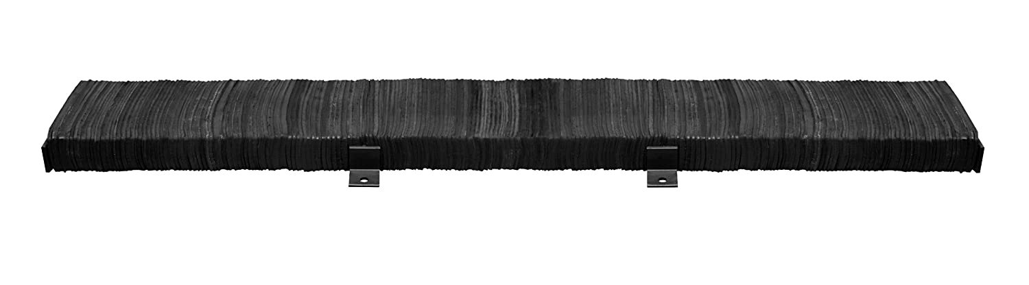

And I just bought a 113lb 54" long 'loading dock bumper' (made of recycled tires) for $63 SHIPPED on amazon because in my mind ~$0.50/lb for a bolt-on counterweight that doubles as a push bumper was too tempting to pass up. It will be bolted to the rear face of my box blade, so 113lb as far back as i can get it. It might get some dirt on it when im pushing with the rear blade, but i don't think it's going to hinder the function of the box blade in any way, while making it more effective as my primary form of loader counterweight. This is mostly in prep for increasing the hydraulic pressure in my loader circuit..:devilish:

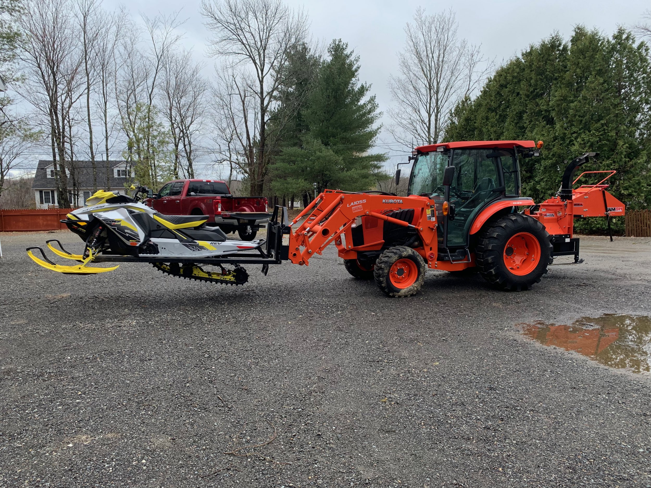

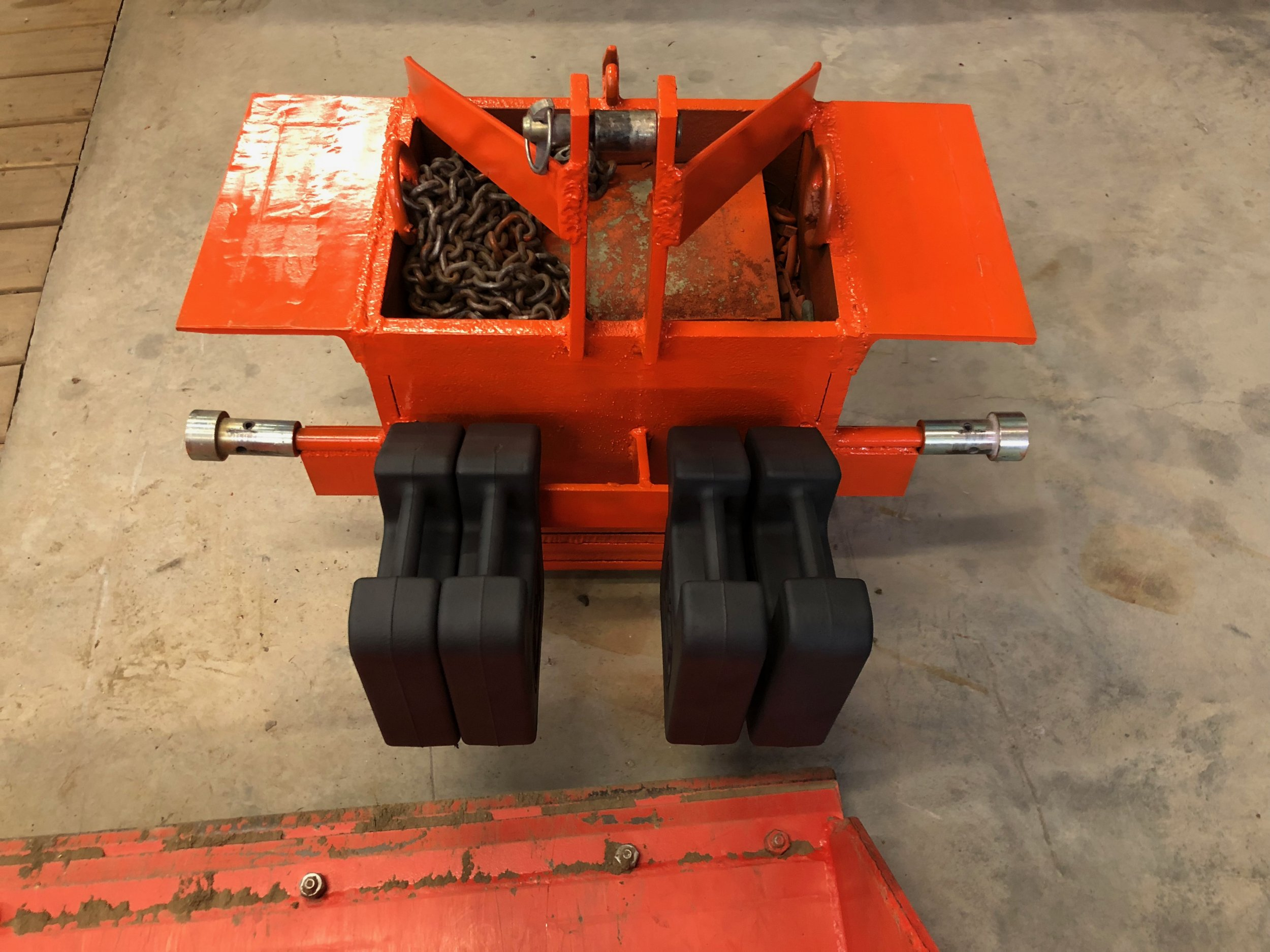

I use this ballast box when using my dump trailer and loader. There is a ball hitch receiver on the back under the hook. I can drop the trailer load it then go around and pick it back up and take it to dump it. If you don't have a heavy box, when you dump the trailer the 3 point hitch will go to the full up stroke while dumping. The BB gives me better traction while using the loader.
I also have loaded rear tires because of my forks. I won't take the time to put a counter weight on the back when just loading 1 item on something. I figured I would get in trouble w/o loaded tires.

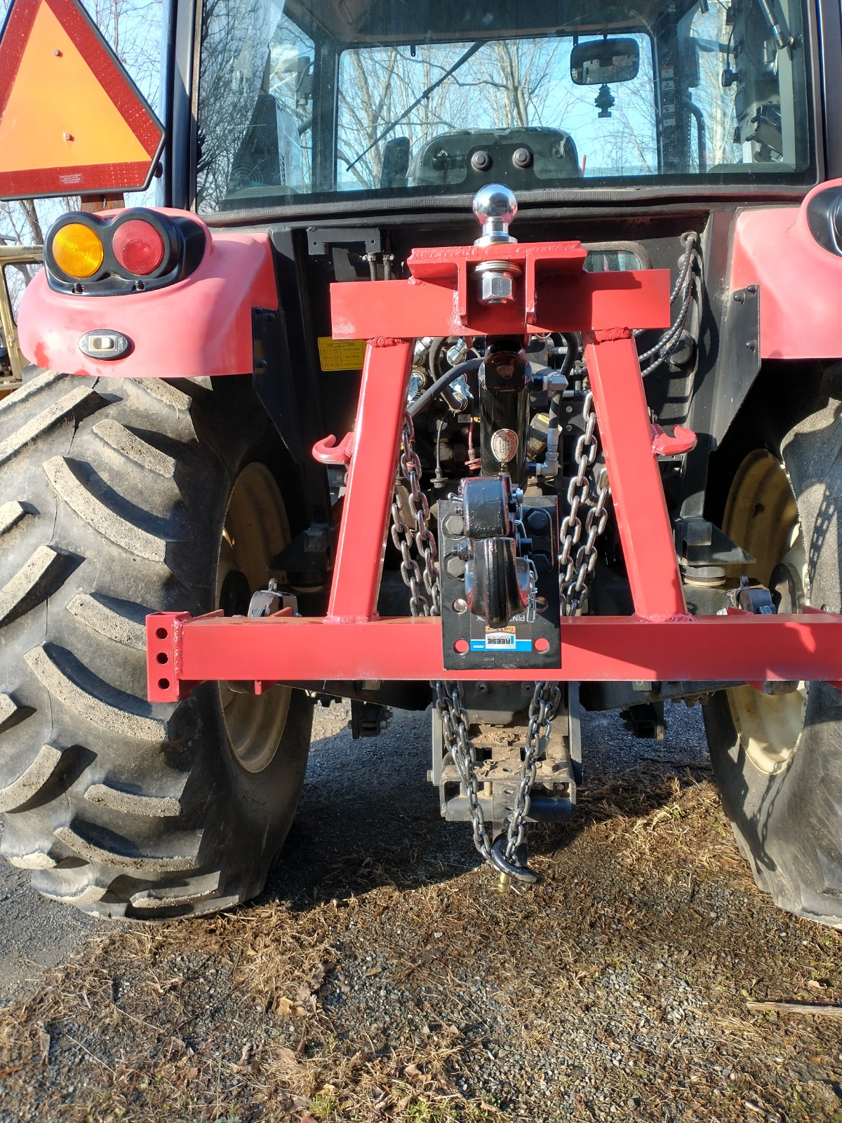

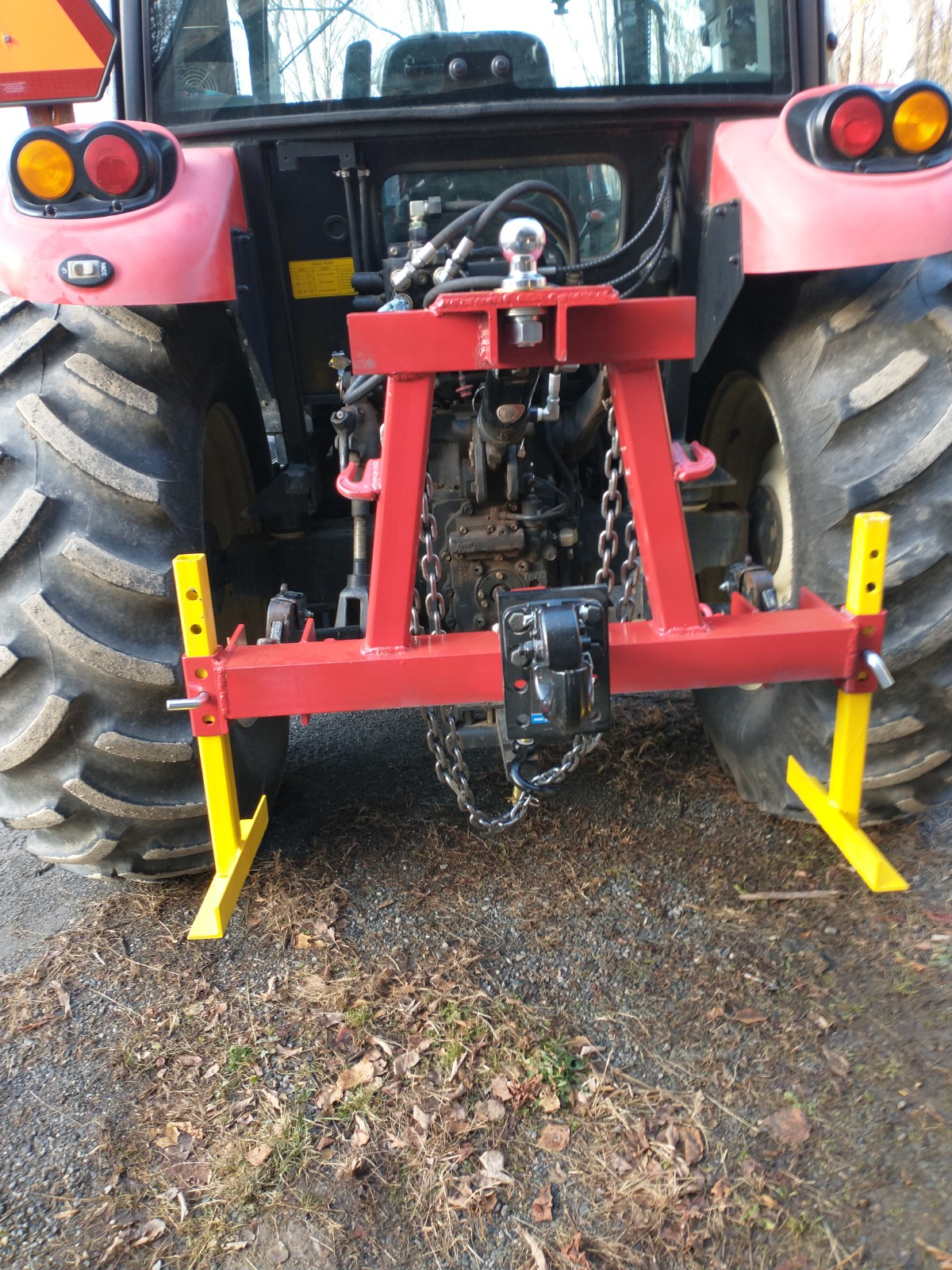

On my 3 point trailer hitch I have a chain which runs down to a clevis I attach to the drawbar so it can't over lift the 3 point.
