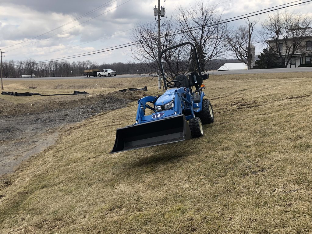

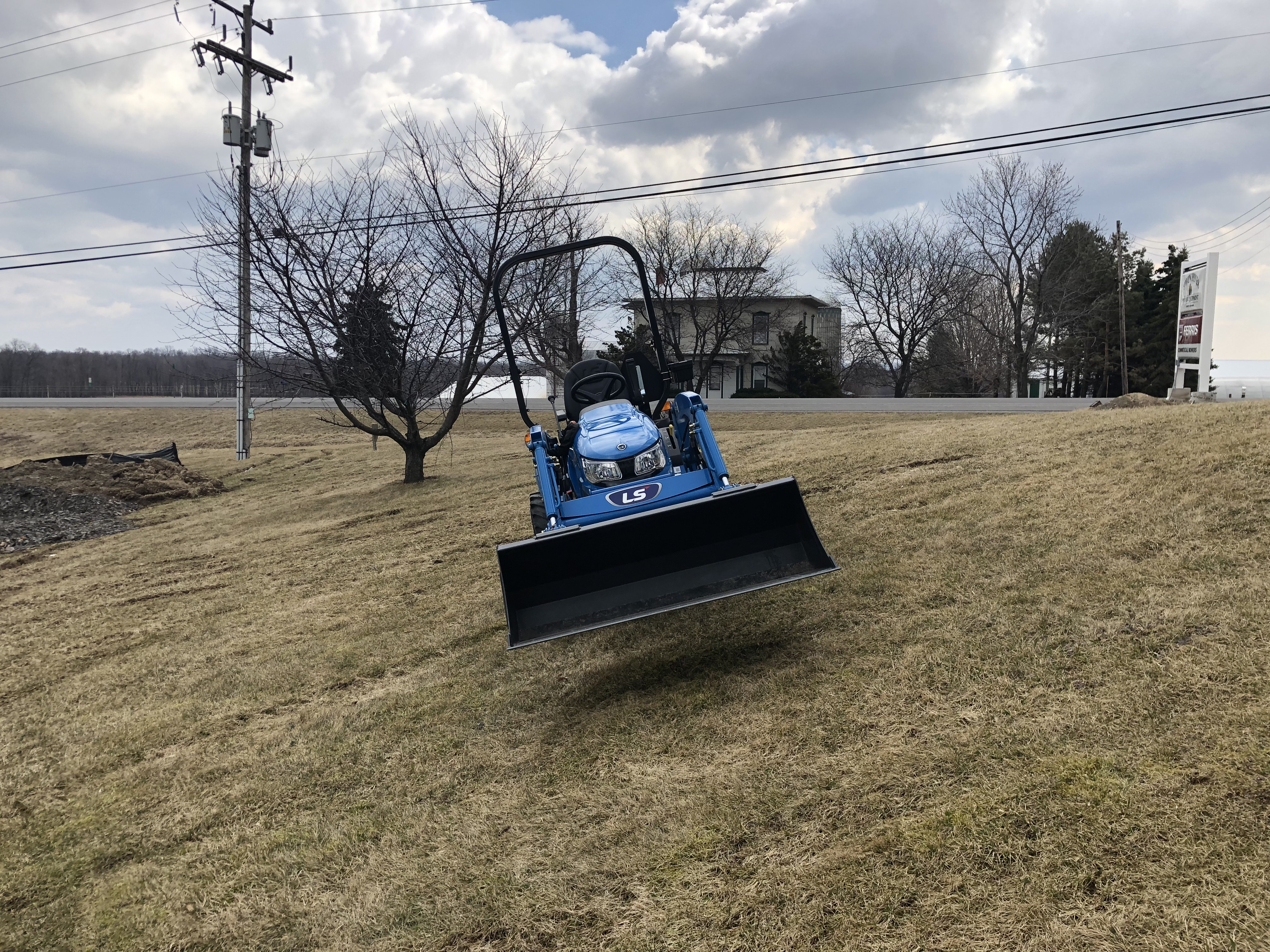

Some of you guys and like you've never mowed on slightly sloped property. 20181009_073457.jpg

I wish someone would do this exact test and a test on even larger wider side slopes and video it on a F series kubota and deere, 1025r, BX, commercial ztr, and grasshopper. Might as well throw in a powertrac too. You see the body english they use... Can't do that on a sub compact I don't think? Haven't seen anyone do it. Even on the riding tractors without body english and as a larger rider hmmm would it tip without a dual wheel setup?? Also, the ztr they use is not commercial, not very wide, smaller tires than commercial and no roll bar and seatbelt. So comparing a 5k-6k ztr to a 12k 4x4... Put a 12k commercial ztr there and equip it with knobby tera trac tires then compare.

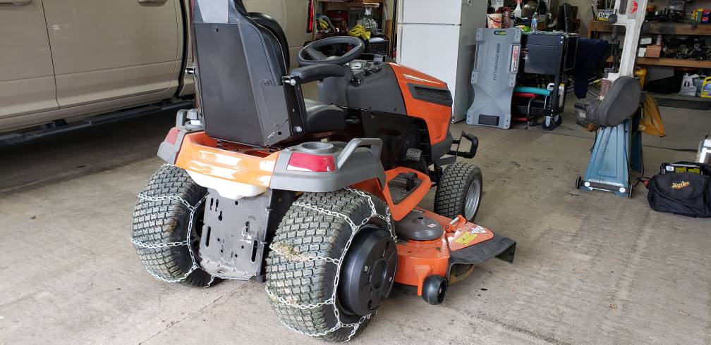

I am happy with my Husqvarna, but the x748 is king of the hills. I'd buy that TODAY.
