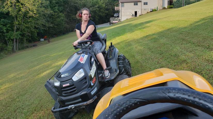

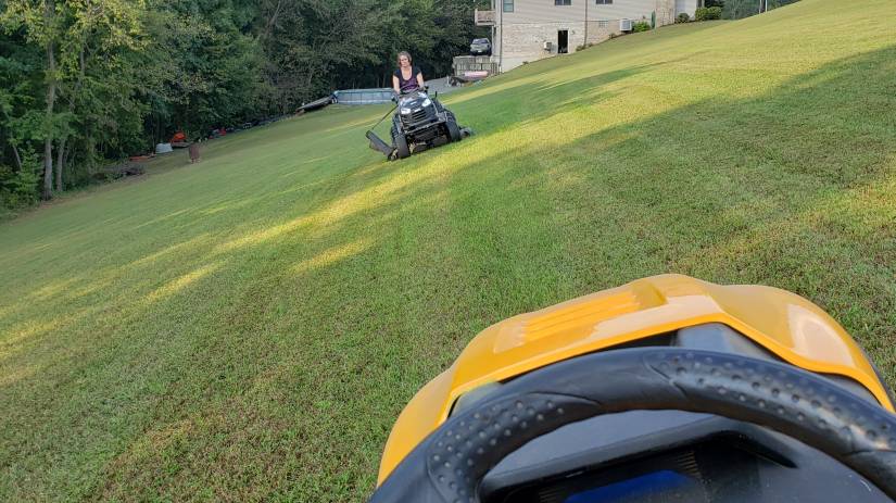

Someone mentioned buying upper mid level garden tractors. That is what I do. I was bound and determined to mow 4 acres with a B2650, I had a BX25D prior to that and never considered it because it was joke.... it was so narrow and "tippy" that it was not funny at all. So I built a B2650 to be as wide as reasonably possible with offset wider wheels and wider tires, wheel spacers and essentially made a 54" wide B2650 into a 61" wide unit and added over 700 lbs of Rim Guard to the tires... This thing is SUPER stable and sure footed compared to that BX25D.
But at the end of the day, I realized that my 16ー general slope is just to steep, and that the large tractor pulling sideways on wet turn meant constant depressions from tire tracks and torn turf as the tractor is always sort of crabbing sideways and pulling the roots out.
A nice K66 or G720 equipped garden tractor can mow circles around the bigger tractor, not destroy the turn or create depressions and stability is a non issue. The new Husqvarna with the K66 and electronic locking rear axle means that even side slope mowing is pleasant because you hit the button and lock that rear axle so that the upper "light weight" tire doesn't just spin out on you.

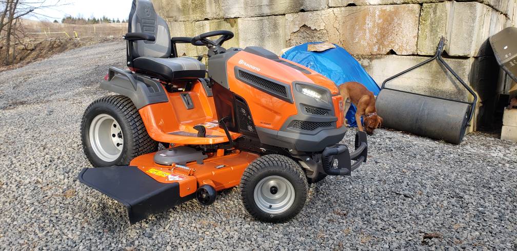

To each their own, I know I spent a lot of money trying to use a compact tractor to mow.... I sold the mower off, bought a lousy Cub Cadet XT3 GSX (should be titled JSX... for JUNK SUX) and sold it off after putting 40 hours on it, and just bought a Husqvarna TS354XD KDD/Locker to work along with my trusty Craftsman (Husqvarna) with G730 and weights/chains.
I love my Kubota, and I brush hog my father in laws field and my brother in laws field with it and it does a splendid job with a 60" rotary behind it. But on steep slopes with wet turf that peels and slides away under you (even under your boots as you walk it while it is wet. I have fallen while walking my dogs in the yard because my feet slid out from under me before I could gain traction).... useless as teets on a bull.
That is my opinion, based on my experience, based on my property/slopes. And in case you want to ask... I had a local company bring me a zero turn Cub Cadet over because he swore he would sell me one after he displayed it on my lawn. When he got here, he refused to unload it from the trailer and told me that sometimes a good garden tractor is simply the right tool for the job... and my yard is one of those situations.
