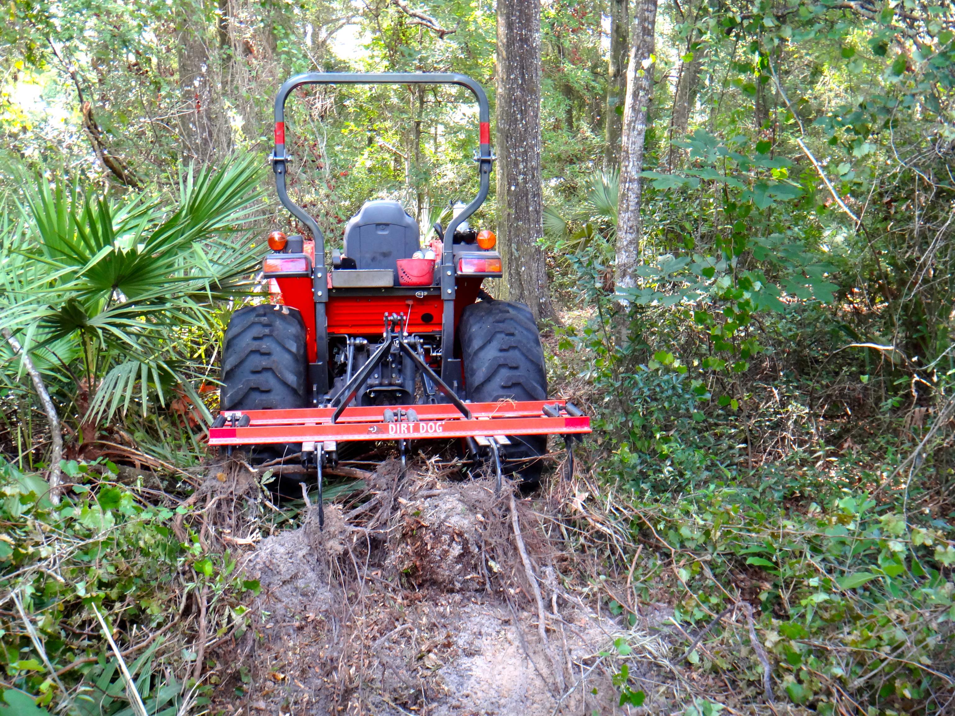

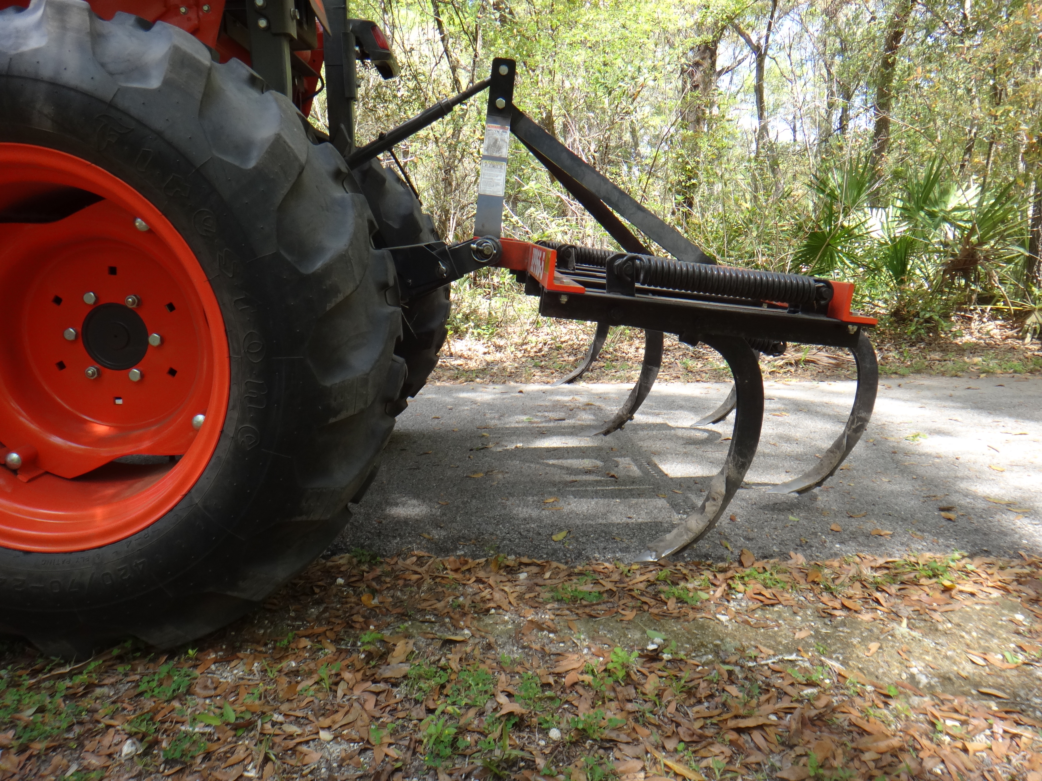

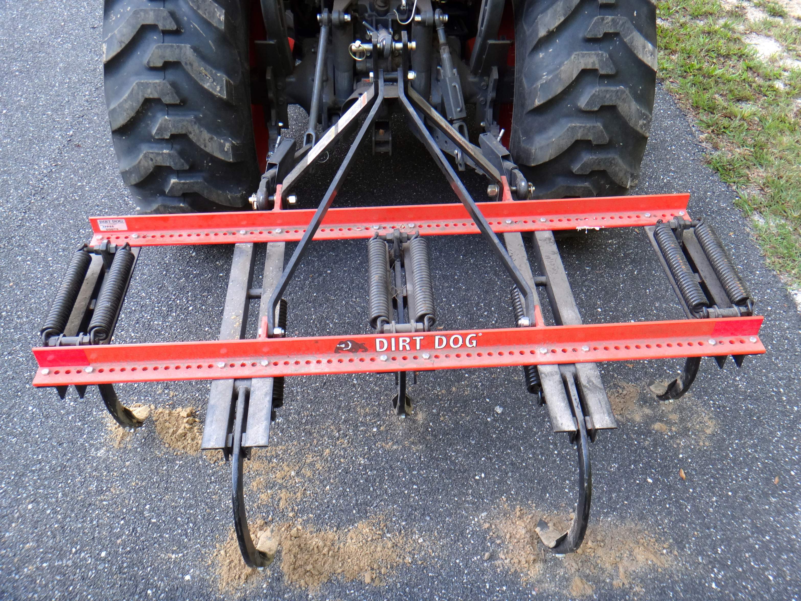

A Field Cultivator is a Secondary Tillage implement, much like a Chisel Plow but lighter. My Dirt Dog seven tine Field Cultivator weighs 275 pounds. Great tool but NOT for Primary Tillage, your task.
