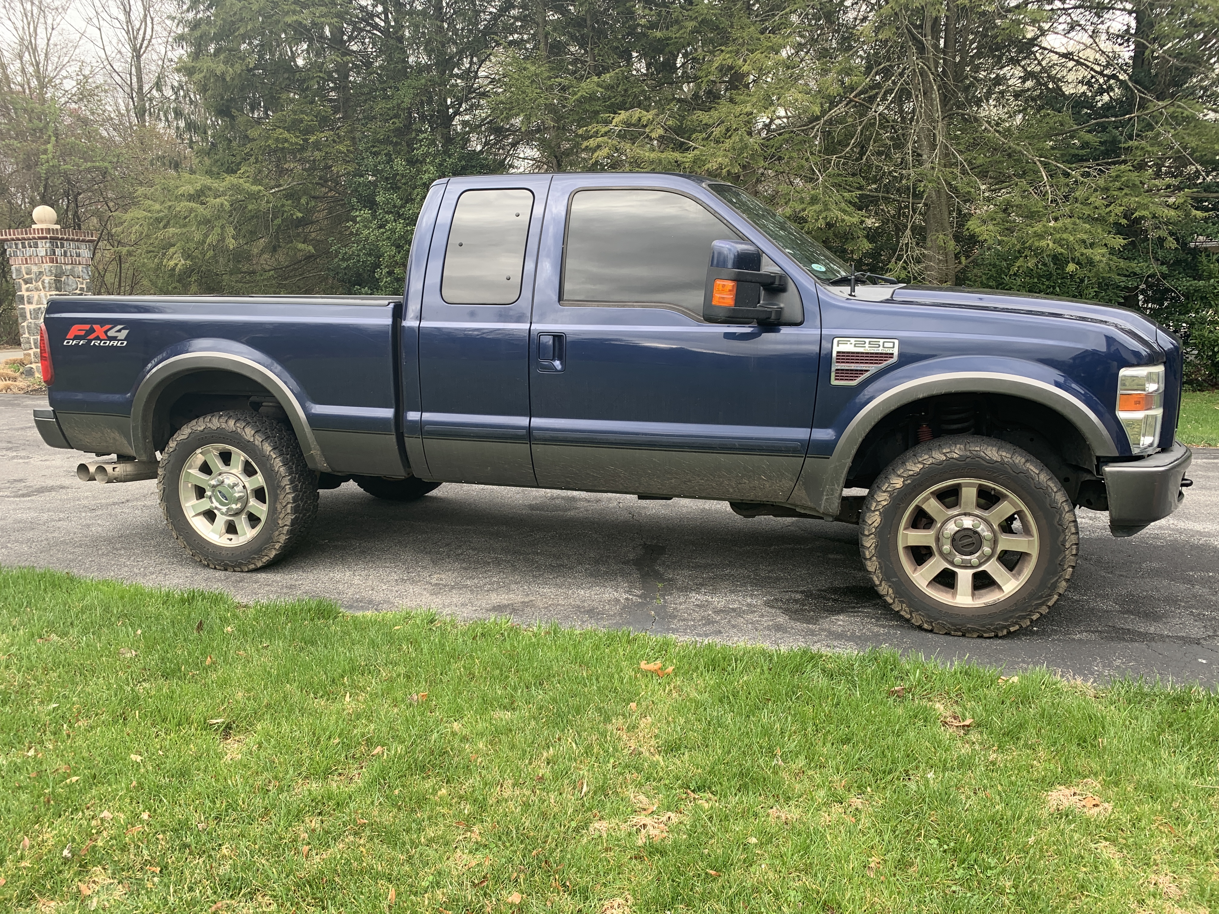

I cant sell my loaded 2008 F-250 FX-4 diesel with all the toys for 1/2 that.
Im only asking 13k. :confused3:

Bad motor and stubby hood plus it's a 250. If I ever bought a new truck which is doubtful, it would be a gas motor. Diesels are just to emissions choked now.
   / Right to repair, Why I don't want a new tractor. #19
If you drove that truck, you would love it.
Awesome snow plower. As fast as a gas big block.
