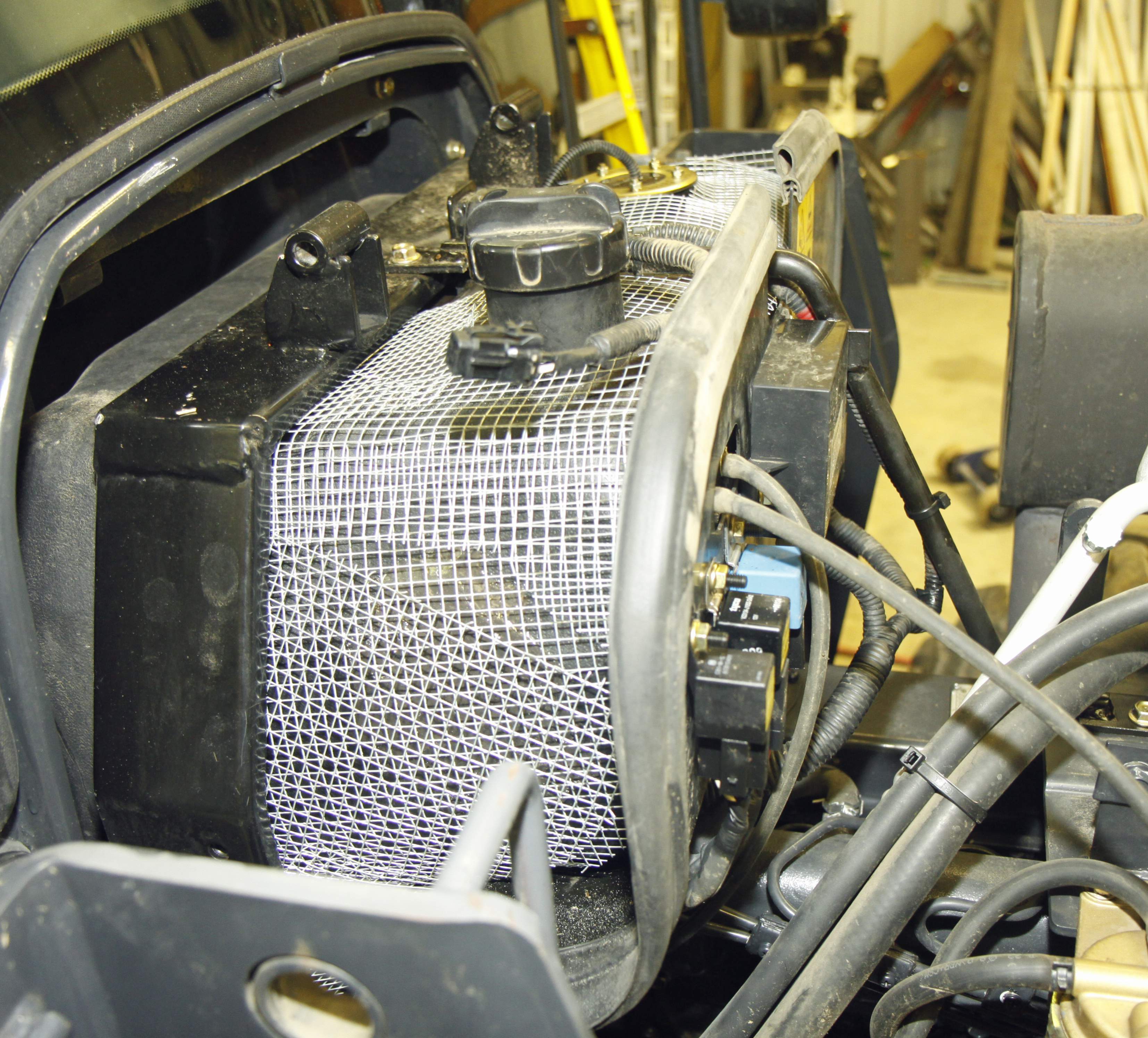

Hmm, not sure I like it that far down as I can forsee possible damage, however makes for easier fueling. Mine is up high under hood. Fuel door on top of hood. Main reason I got electric fueling tank. After a critter knawed it’s way thru my tank, I decided to wrap it in metal shielding. In 8 years no more teeth marks.

I’ve owned tractors where the fuel tank was on top, to much of a pain to fuel without spilling some on or around the motor. Unless you’re driving over 3 ft stumps the chances are slim to none you will damage the fuel tank. I can fuel mine with minimal effort and a five gallon can when not close to the pump.

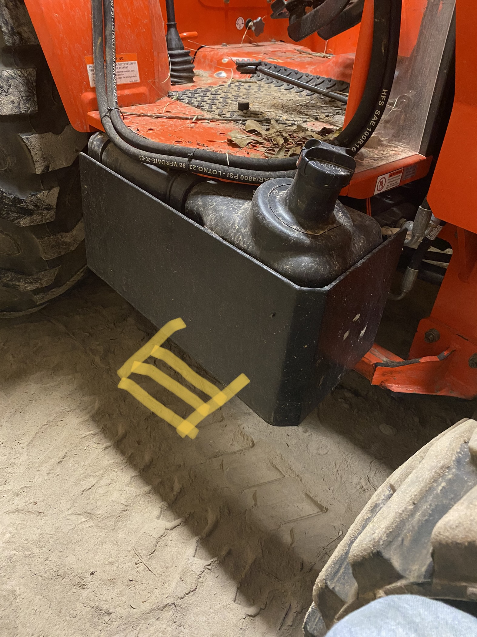

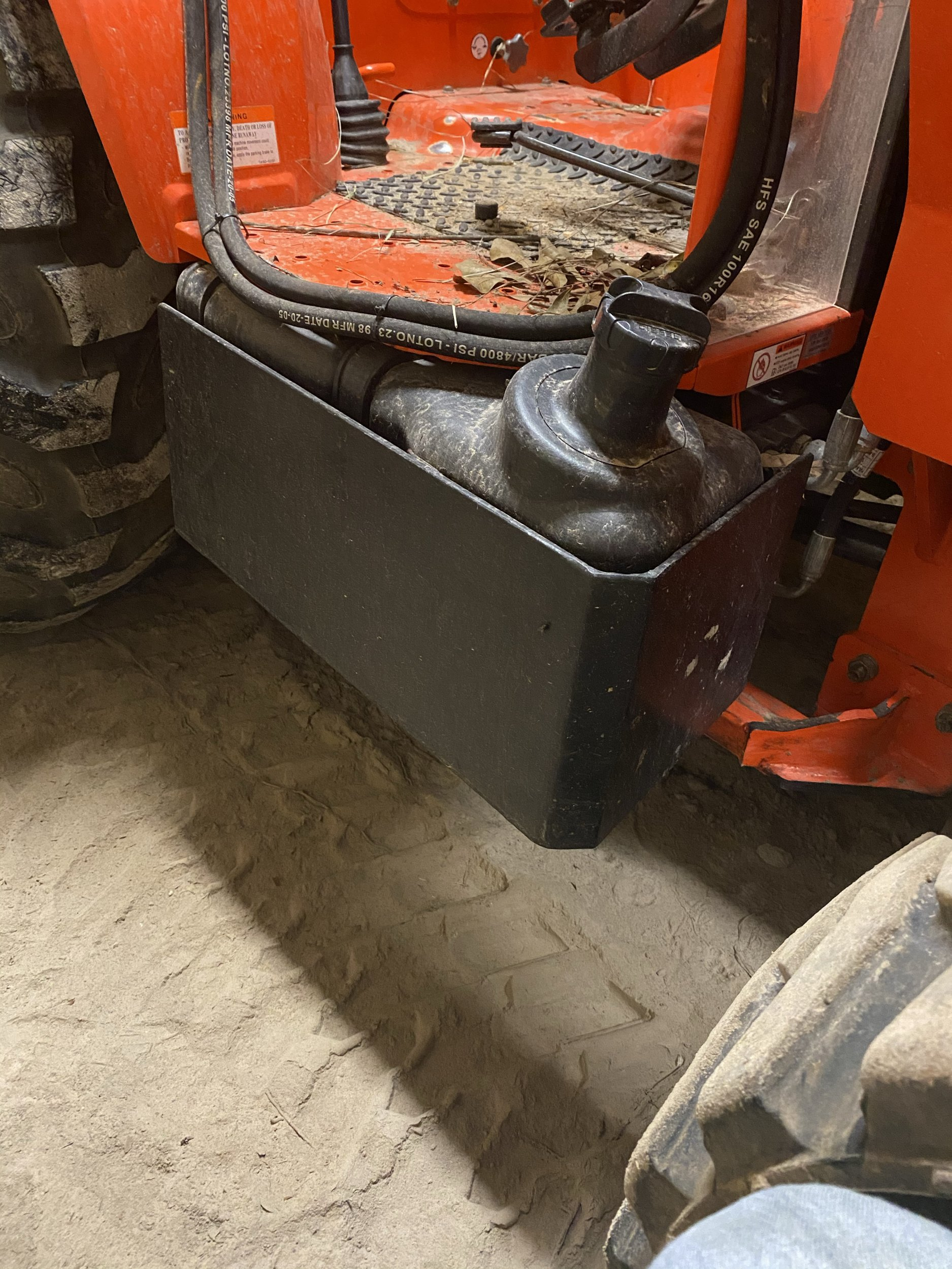

Takes all of an hour to cover the lower fuel tank with 1/4” plate and there’s no more need to worry. Will post a pic later of my mod to the flimsy guard, if you can call it that, later on.

Clintock, how hard would it be to modify your design to add a small toe-hold for a little feller with short legs? :ROFLMAO:
/ Right Side Step Modification on Kioti DK4510? #32
Wouldn’t be hard at all to weld a small step on it. Maybe an extra 15 min.
It has 1/4” plate on bottom too. Use the same hardware that’s already on the tractor. Just have to mark where the holes will be.

Y’all might be right. Op my apologies. Here’s a pic of modified fuel protector with a step
/ Right Side Step Modification on Kioti DK4510? #39
Y’all might be right. Op my apologies. Here’s a pic of modified fuel protector with a step View attachment 713288
Clint, is that brass? How do you weld brass to steel? Also hard to tell from isometric drawing, is that three rungs hanging straight down or does it extend out horizontal like grating?
In all seriousness, that was a great fabrication job on the tank protector.
/ Right Side Step Modification on Kioti DK4510? #40
Yellow brass. Easier to braise it than weld it. It sticks out horizontally. Hangin down would hinder ground clearance.
