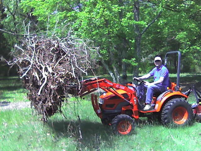

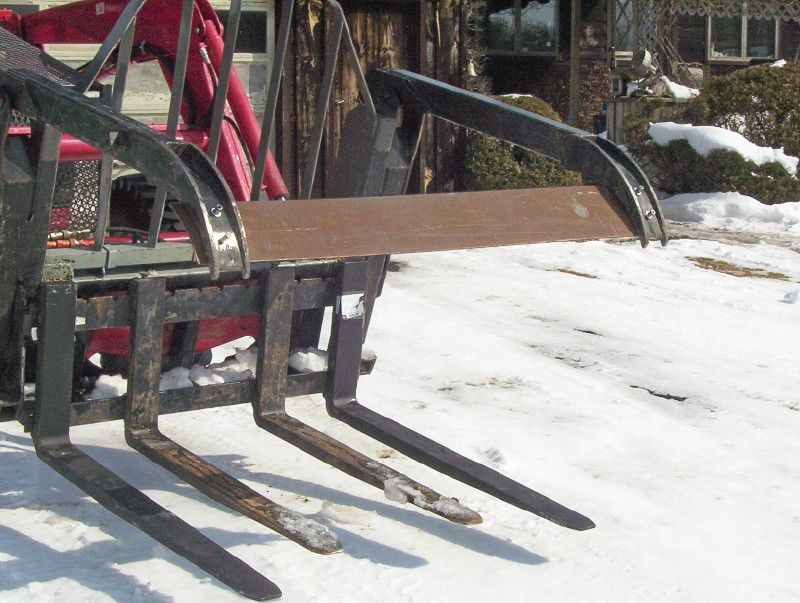

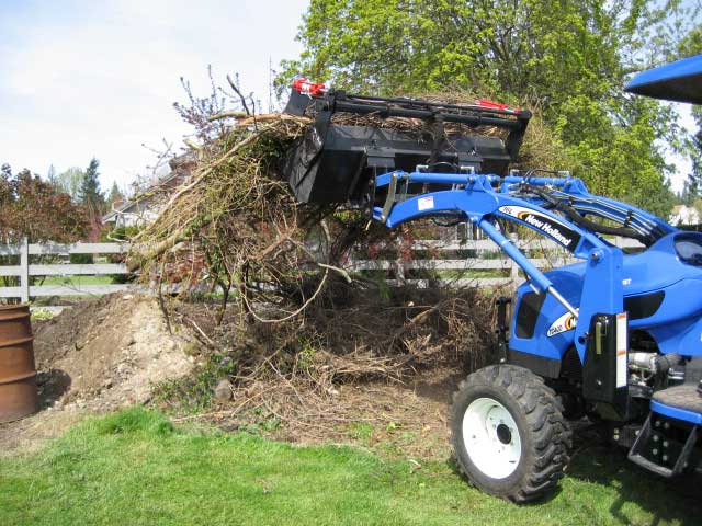

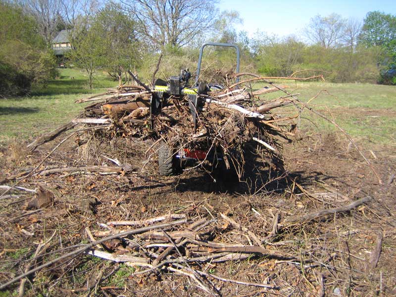

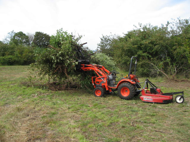

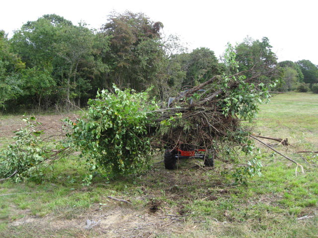

You said it Bro! For anyone with significant land clearing, you should think of a grapple right after you get your bush hog home.
One of the nice things about grapples is that even smaller tractors can do essentially the same job as 50+hp tractors moving brush. 21hp tractor with a $700 grapple works pretty much as efficiently as the big guys.;)

I'd have to unfortunately agree with you there Ed. You make it difficult for me to justify my big machine. Sometimes your pictures look like the brush pile is carrying the tractor!!;)

Uh, do you tow anything bigger than a 48" bush hog or 60" finish mower?:D
Point is that for the brush clean up duties the smaller machines are perfectly adequate. My point was not to dis your monster machine but to clarify that owners of small tractors can get great results by adding an inexpensive light duty grapple.:cool:

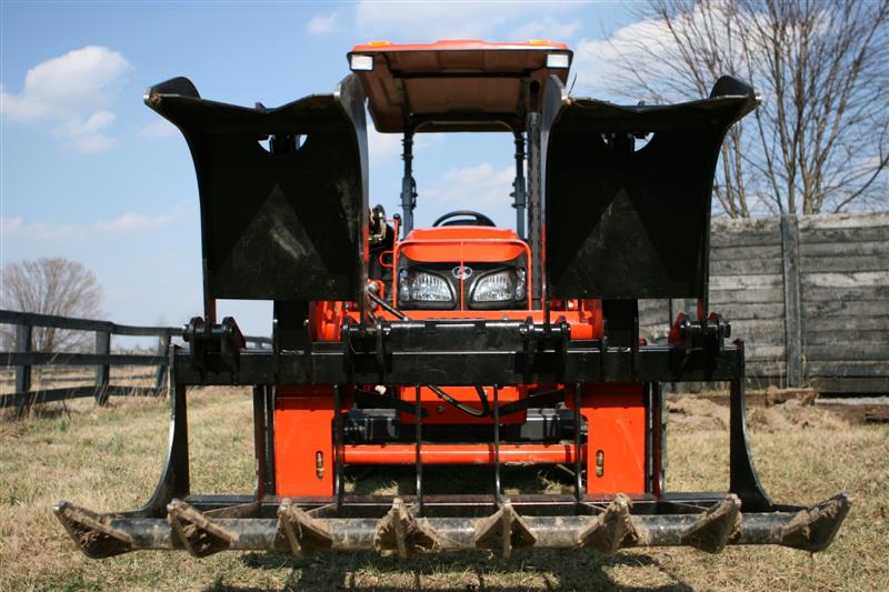

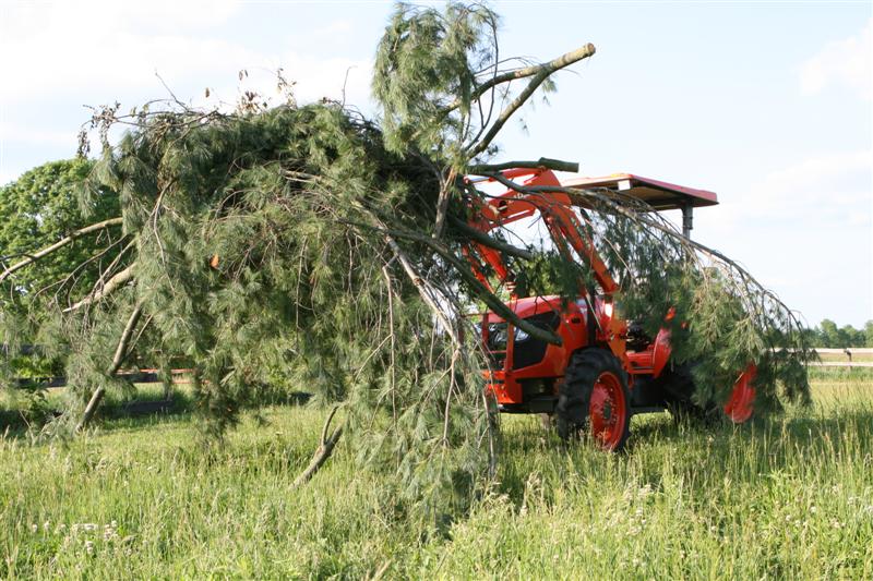

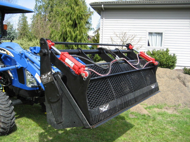

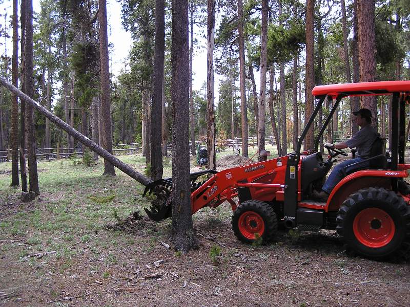

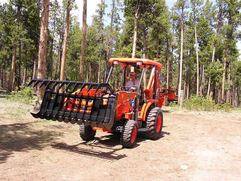

The Anbo rake/grapple for our Kubota L39TLB works excellent for many different jobs. You can use it to rake up a bundle of brush and then grab it and deposit it elsewhere. Dirt will fall out between the tines which are spaced 6 inches apart and are offset top and bottom. It will be one of our most used attachments for the L39.
Pulling a tree snag down by grabbing the root ball and slowly backing up and letting it slide down another tree.
