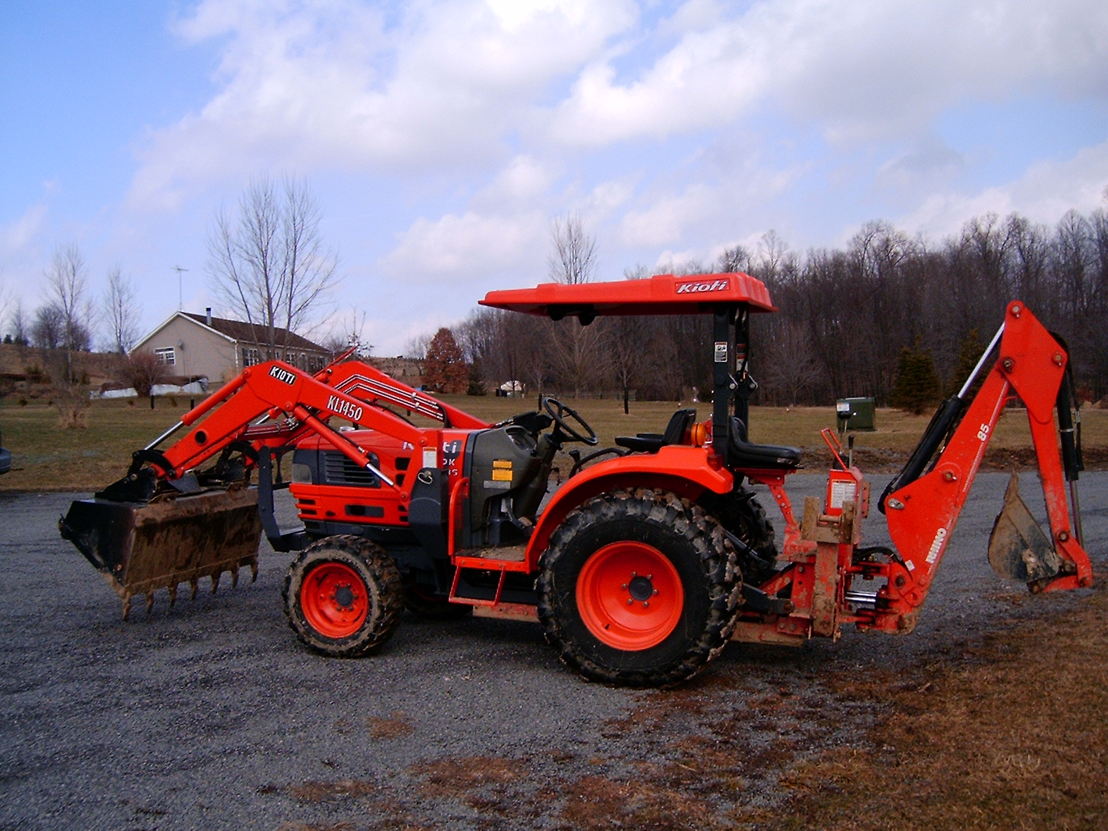

Anyone out there have a rhino 75C backhoe. I have the bobcat version of the CK 27 and would like to put a backhoe on the back of it. I'm wanting to know if you have to remove the three-point linkage in order to install the subframe mount backhoe. Also if anyone has any experience with the rhinos good experiences or bad would appreciate hearing about them. Thanks.

I don't have a 75. But I run a Rhino 85 on my DK 35 and the 3 point linkage can be left on.

My Rhino 85 is an 8 1/2' backhoe. My DK 35 handles it with no problem.
I'm not familiar enough with the CT or CK series to say how an 8 would work.

I have a 8tb on my ct335 bobcat tractor, my 3 point hitch was removed to accept the subframe and backhoe, not sure it can be left on but I don't think it would leave much room. Overall I am very pleased with the hoe, she's very well built, the subframe ties into the tractor very well. The controls are very comfortable and responsive for a small hoe. I would recommend trying to find a 8tb if possible. I have owned a woods 7.5 and it was also a nice hoe however it does not compare to the bobcat 8tb.

The sub-frame is bolted to the backhoe and clipped with pins to the tractor. Much easier to take it on & off with the sub-frame. I think, not sure, the sub-frame sticks out the rear some and might interfere with using 3 point attachments. If the sub-frame is problem for storing the backhoe, remove all 1 bolt on each side and swing the frame vertical and strap to the hoe.

The Bobcat/Rhino subframes are attached to the backhoe and come off with the hoe.
/ Rhino backhoe? #11
The bobcat version subframe stays with the hoe, it's a matter of minutes to remove the hoe, the sub frame also greatly reduces your ground clearance, you would want it off when don't using the hoe.
/ Rhino backhoe? #13
I have a Rhino 75. You can leave the 3pt on the tractor. The subframe does come off with the tractor. Two pins holds the hoe onto the tractor. The hoe works great. Smooth and powerful. The hoe comes off in a minute or two. Putting it on can be a pain, as you have about an inch of left/right play to get the rear bar aligned with the hooks. Sometimes I can get it on in about 5 minutes. Other times it take 15. If you store it on concrete or pavement, I'd think it would be easiest. I don't have that luxury. I have a few hundred hour of use and it has always worked very good. Suggest you get two buckets: 18" for general digging, and a 12" for trenching. An 18" trench is monster for a 2" pipe.
