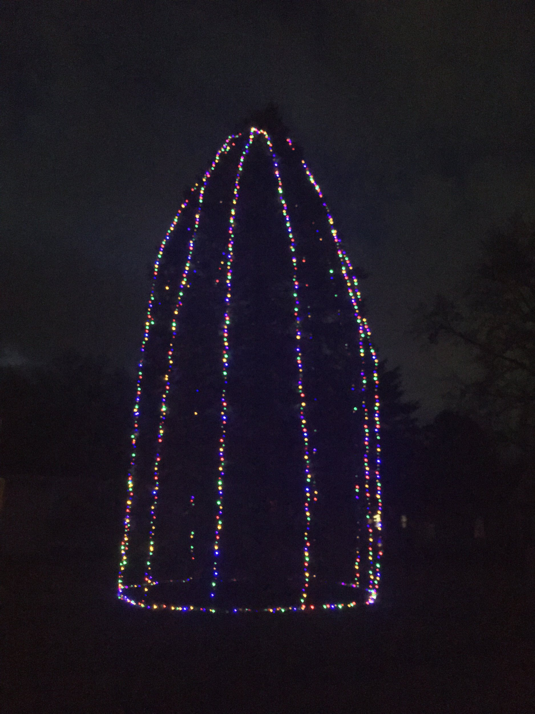

I converted the 50'+ Blue Spruce to LEDs this Christmas season. Those actually look pretty nice, but those are colored lights. Should see significantly lower electric bill, as the incandescents were pulling close to 30 amps.
