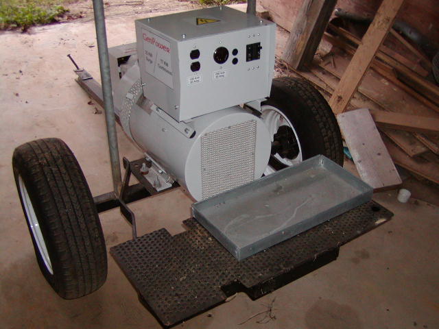

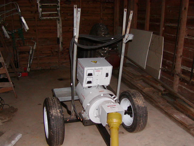

I found a reasonable deal on the same setup as Neil got.. 17KW, 35KW surge, 70 amps at 240 volts, 1800 RPM, 515 PTO RPM (seems an odd number.. but I suppose this is good as the tractor doesn't have to run quite as fast). Comes with the whole thing assembled on the trailer, ready to plug & play (or is that plug & pray?) I talked to our electrician, and he will get back to me on a good transfer box solution.. first he needed to know the amperage, etc.
This is probably a lot more than we need for our own house, but it looks like good, solid equipment that will last a lifetime, and if we need to power something serious we can do it.
Now I just need to figure out how best to help out neighbors if we run into an extended outtage. I understand (I think) the issues of making sure the system is NOT on the service line.. I'm a bit more shaky about being clear on the power meter approach to this in the event a state of emergency is declared and this becomes legal. Just pop off the glass meter, and underneath I'll find a house side and a service side? I'll ask our electrician to show me, when he comes out. I'm not sure what type of cable I would need, and how to make sure I'm on the house side rather than the service side. I'm sure it's obvious when you look at it, but I never have.
