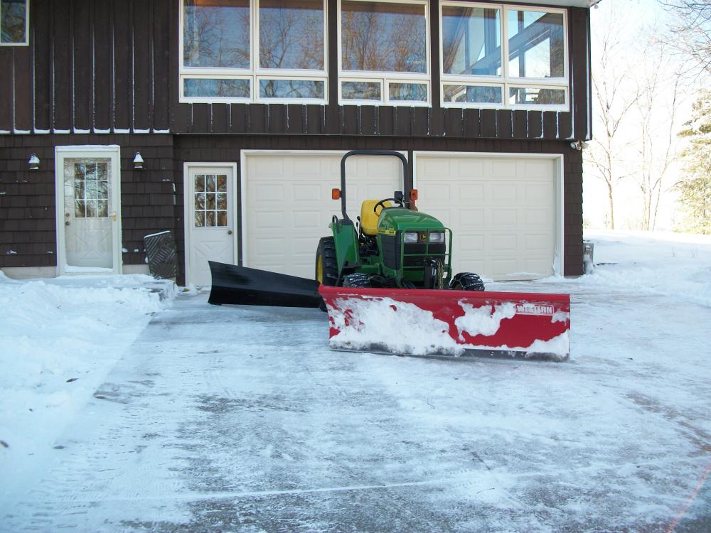

Over the past few years I have collected almost everything I need to mount a blade on my FEL. While I don't need (or have) a wide blade I do need to wing the snow back beyond the driveway edge and over the edge (a drop-off).
I wondered about reversing the A frame so that the plow actually moved to the side when angled to the right and stuck out beyond the front tires by about 12".
I could still use the trip springs and by slightly offsetting the blade still plow the left tire path when angled to the right.
I am currently using either my rear blower (slow job for 3" of snow) or a rear blade(PIA to switch between blade and blower). Neither one will clear the snow beyond my tire tracks...
If I mount the hinge pin back at the FEL bracket and keep the trip pivot at the blade I think the idea will work as the angle cylinders are still in the same relative spot.????

That is an interesting idea. Are you in a good position to try it and see how well it works?
Might be too much side force on the front of the tractor without considerable added weight.
Do you have the plow on the front now in conventional mode?
I built a wing plow to go on the side of my tractor (left or right) and only put it on when winging the snow back (and then just because the rig doesn't go into the shed easily with the wing attached).
YouTube search on wing_plow to see the slow first test run.
http://www.youtube.com/watch?v=n4SJxqzm-hc

Shouldn't be any more sideways force than you would have on your frame mount plow. The same blade angle, maybe a little farther forward, but a narrower blade from the look of it.
Do the front tire chains help prevent sideways slipping?
What did you use as an anchor point at the rear?
A wing plow would suit me great as long as it could be raised/folded against the right side or removed easy....
(My tractor is a JD4300)
For that matter a blade like yours, mounted slightly offset would work even better

Does the wing attach to the 3 point? If it did you could put a hinge type on the front of the blade were it attaches to the tractor and by lifting the 3point you could raise and lower the plow..... just a idea to fab up.
/ Reverse "A" frame on plow #5
Don't want to pull this off topic, but have some info on the wing plow build at:
http://www.tractorbynet.com/forums/john-deere-owning-operating/159770-wing-plow.html
I've found with the wing only plowing, there can be some pushing of the rear wheels, but with the front plow also down there is a counter push that seems to help keep the rig on the straight path.
The width of the wing plow cut is adjusted mechanically with a telescoping push bar at the rear pinned to the drawbar. The push bar is chained to the 3 ph arm and raises/lowers the rear of the wing. The front of the wing is tied to the FEL post (frame mount).

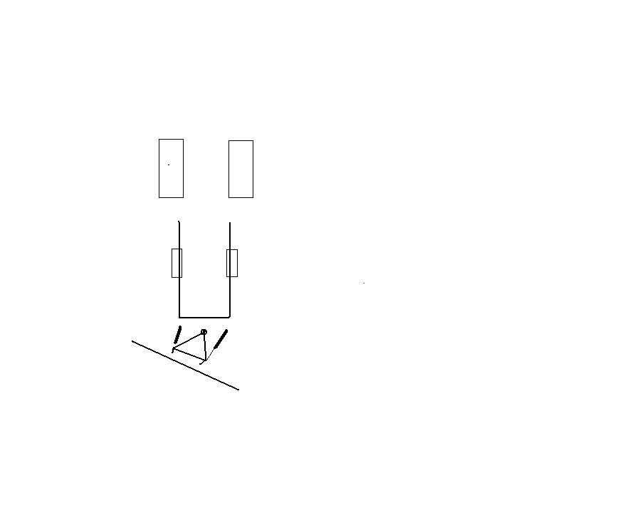

I'm cornfused, need a drawing cause I can't picture it.

This is what I picture in my mind that you have in mind. A crude stick drawing (I need to learn sketchup and advance beyond this crude stage using paint). Is it close?

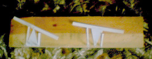

After much study, thought and many calculations I retired to my research and development lab and have determined that it will work, but because of the change in geometry, you'll probably need cylinders with a longer stroke than the normal plow angle cylinders. In the normal engineering office to reach this conclusion, would have required 3 engineers, several days and several thousand $$ of time.
But,
Actually, after going out and measuring the plow, I went to the kitchen table and did a scale cardboard cutout and in about 10 minutes this is what comes out.
If you look closely, the cylinders are exactly the same length scale 2 ft and 3 ft, but with the reversed A frame the 2 ft one does not reach the blade and the angle is no where near the regular A frame. It absolutely does offset the blade by over 6" and it isn't fully angled as shown.
The other sketch is the broom offsetting mechanism I mentioned previously, just food for thought.
Give it a try, you can always turn the A frame back around!!!

In playing with that scale model a little further this morning, It looks like standard angle cylinders might work, but they will always be extended a little further than normal and you might have to move the mounting points out slightly.
When a regular 8 ft plow is fully angled, the edge of the plow will be slightly less than 4 ft from center. With the A frame reversed it will be about 5 1/4 ft from center, so you would definately gain winging ability.
FWIW
