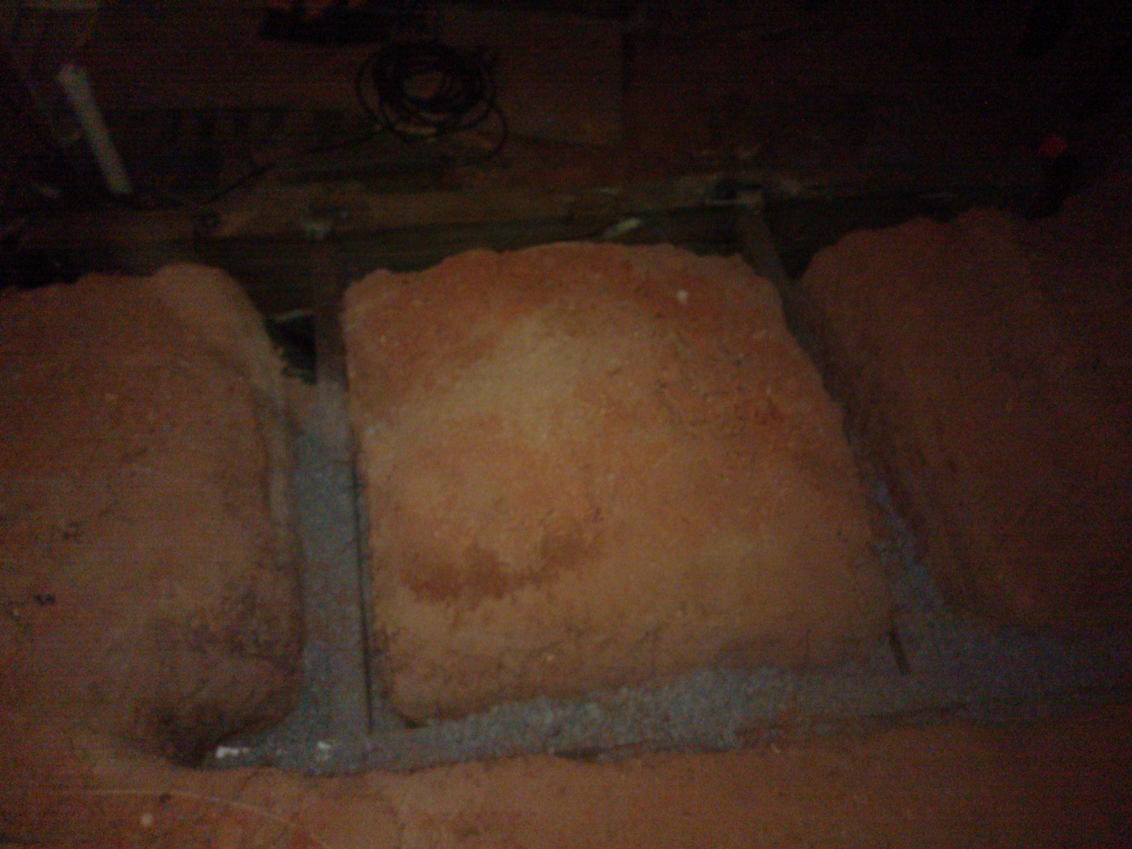

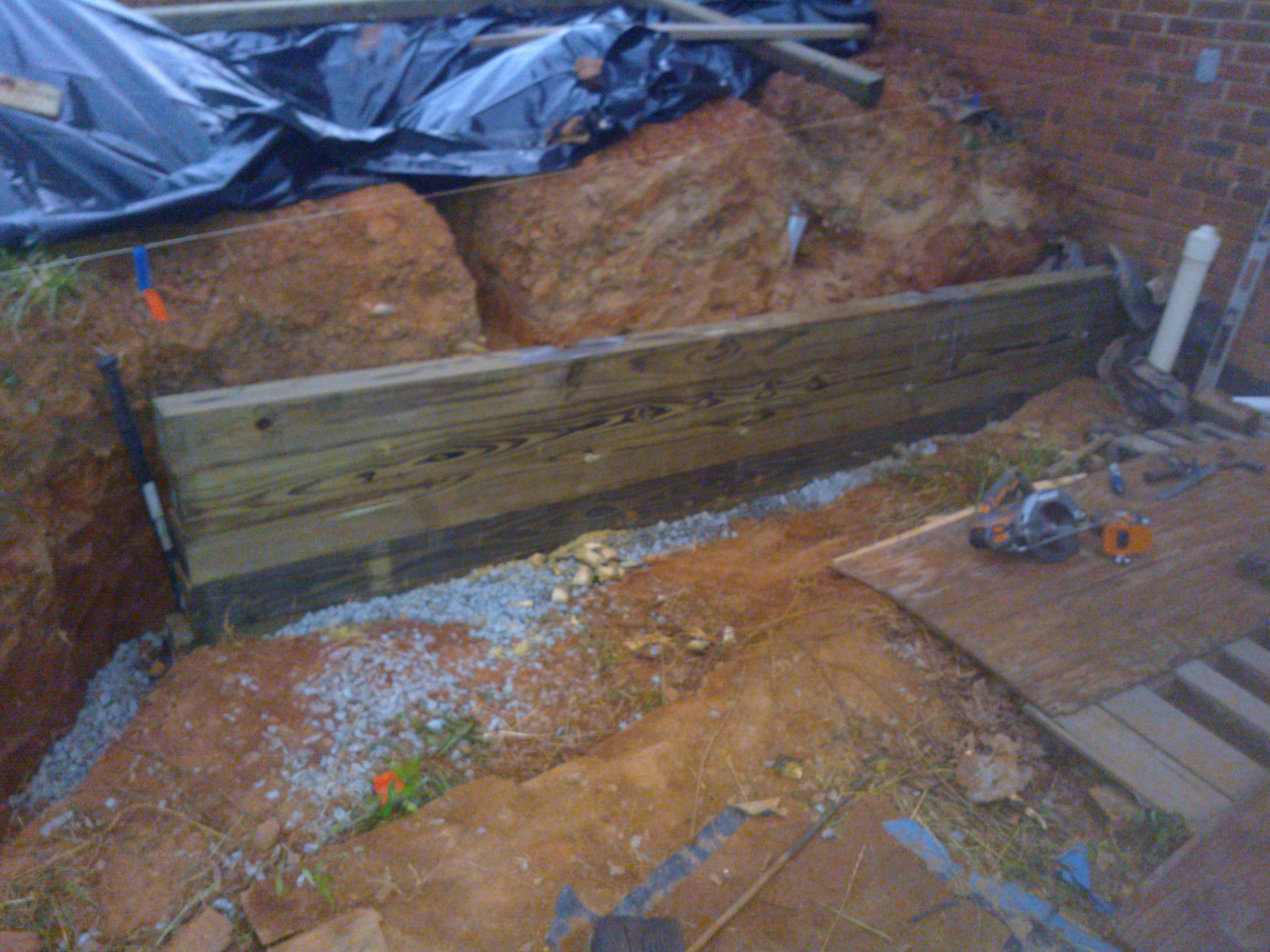

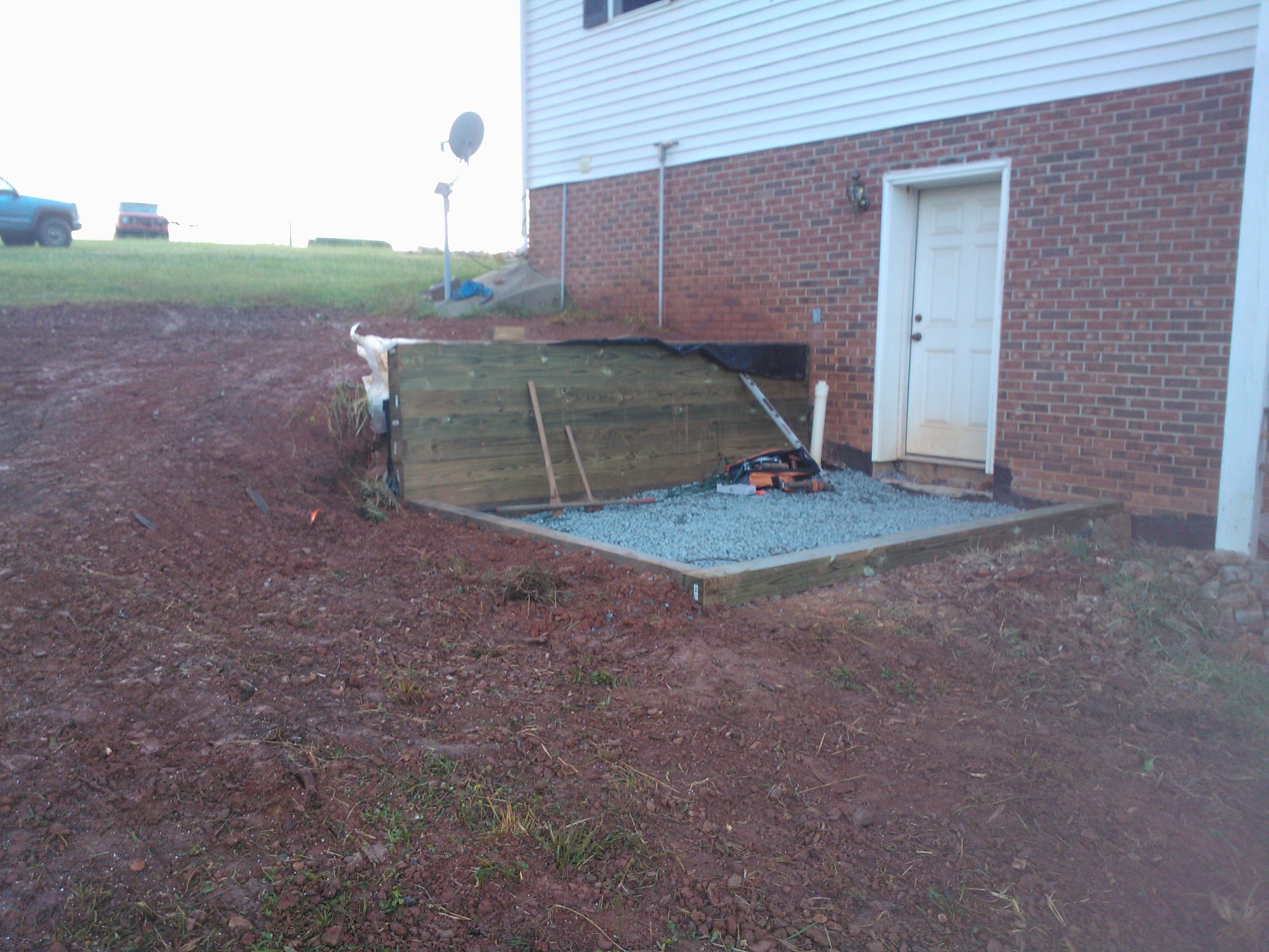

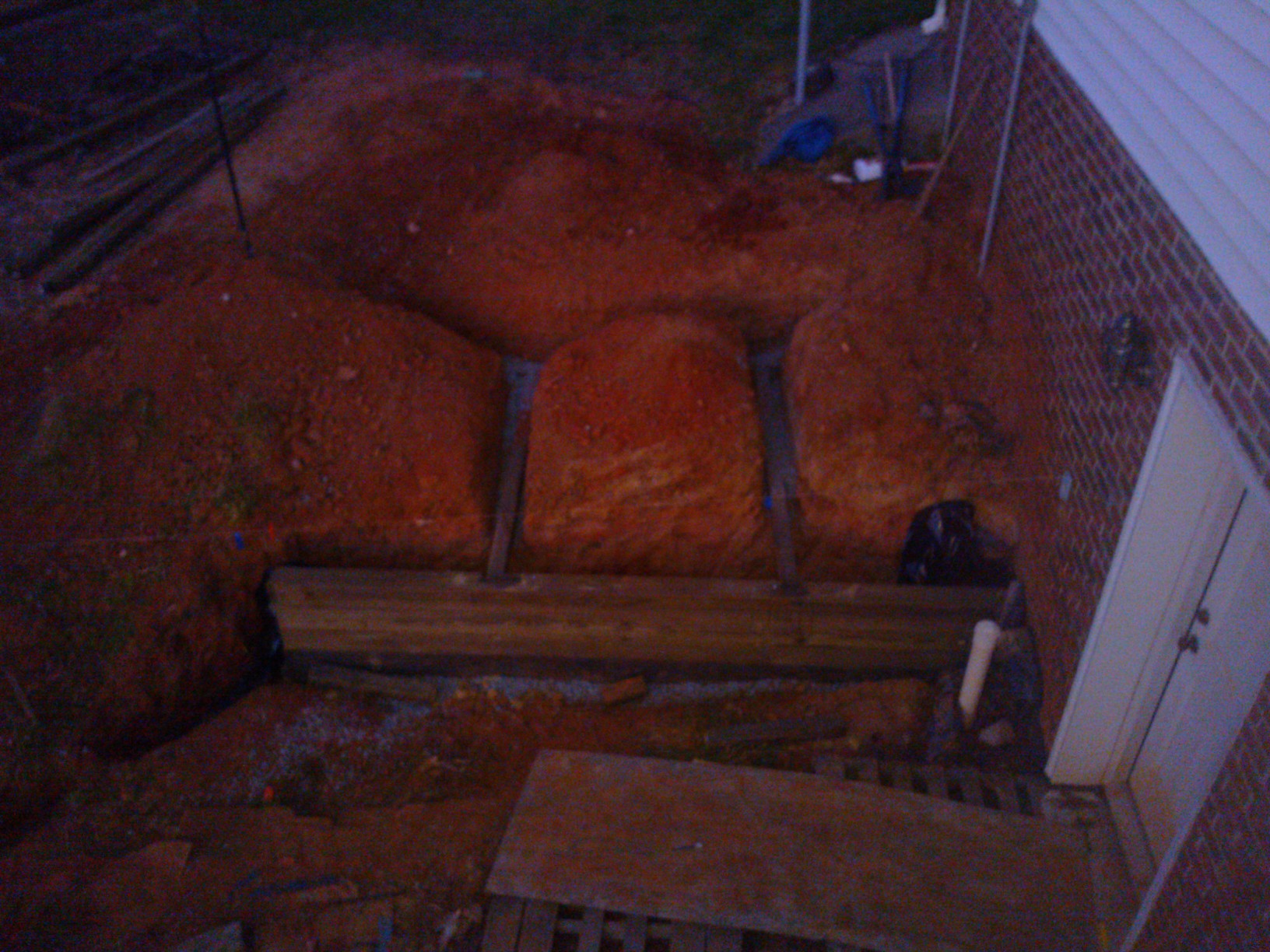

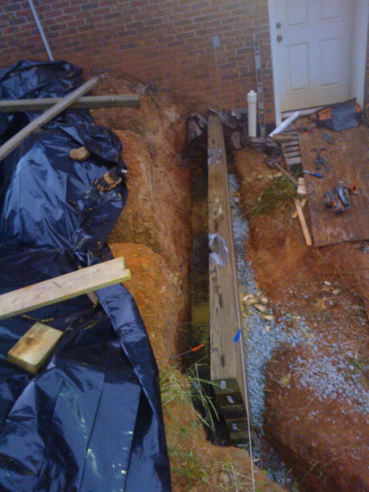

Here is a short one we built out of 6x6s, but I'm hoping to keep the expenses low on this one.

I didn't put my deadmans all on the same level. I put some low, some in the middle and some toward the top.

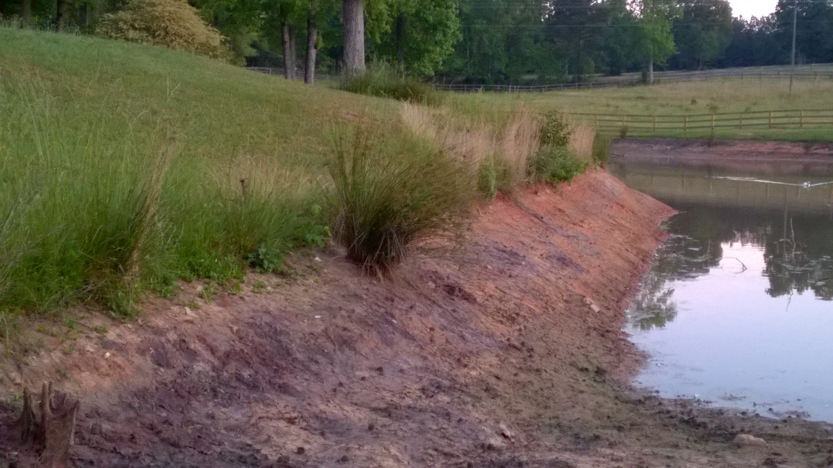

Here is a picture of where the wall will be built.
At 30" high the wall will give us plus 60" of flat space that will make it safer to mow.
The edge of the grass/plants is the normal/high water level.
Marked location.

I don't think the t-posts are even worth considering. The best bet in that moist of environment would be masonry. The wall is low enough that you should be able to just stack the blocks with a slight rearward tilt after you prep the base. Drainage would be a major concern of mine as well.

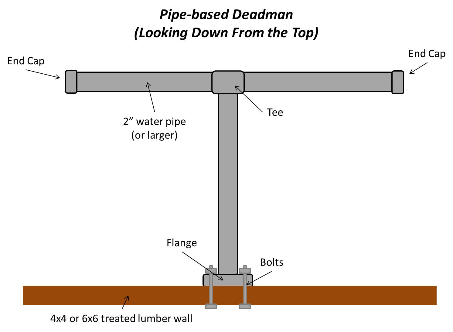

One of the worst things I've had happen is for the deadmen to rot or become loose from decay. That requires an ENTIRE redig and rebuild of the wall. You might want to consider making the deadmen out of pipe instead. If the wall rots, you can replace the pieces without having to dig up and replace the deadmen. If you think you may be consistently wet and that you might have to replace the wall at some point, you might want to consider making the deadmen "permanent" and "re-attachable" to ease future repairs.
I've used a setup like this in wet areas in the past and it worked VERY well. Ultimately, we had to replaced the retaining wall 4x4s due to decay (after about 15 years) but we could just reattach them to the existing deadmen with no new digging.
