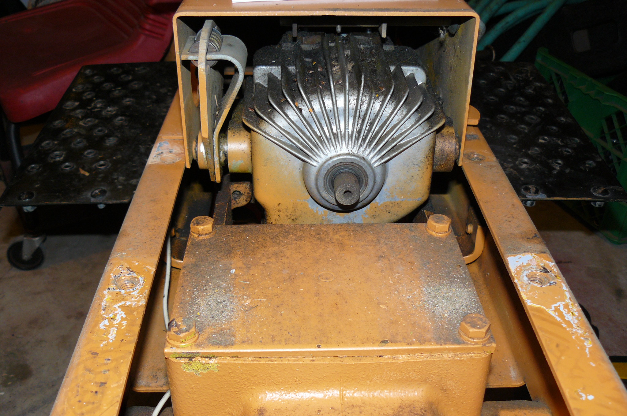

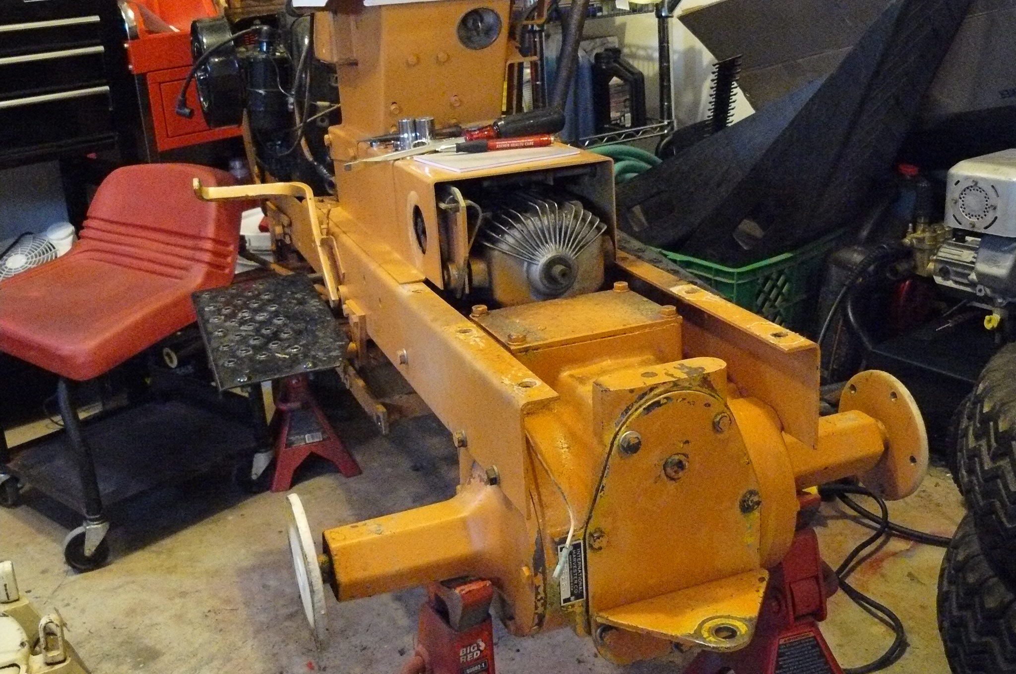

I have been working on/playing with a 1968 CC 125 for several years now, and it's time to get it running.
I bought a beater, but at least one with a fresh engine rebuild, allegedly.
Here's what I need help with. I'm going to change the engine oil, several times..., then drain the hydraulic oil and change the hydro filter. It's the rear end I'm concerned about. Is that a common oil supply with the trans/hydro? Is there a fill plug on top assuming I find a drain plug beneath? Suggestions for replacement lube?
In this picture, there is a rectangular top plate held on with four bolts, that I'm beyond curious to see what's underneath.
Any user serviceable parts in there? Worth looking in and mucking up the gasket?

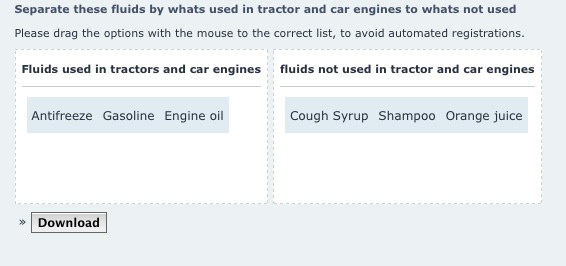

thanks, I'll check it out. Tried to download, screen flashed, no download, no error message. Do I have to be a member of that site?...
I know, read the manual...need another cup of coffee for that.

This is from memory, which isn't always as good as it used to be, but here goes...
Trans and rear axle is same oil supply. Fill plug is on rear plate of axle, above the drawbar. Fill with IH Hytran to level of plug. Drain plug should be toward front of axle. I had a 73 and a 107. Didn't have the space to keep them or the time to restore them, but it is easy to get emotionally attached to these little workhorses.

Download worked for me after sorting the fluids.
It won't download if you use shampoo as an oil additive.
