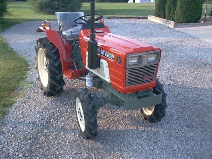

Mark,
It's nice to see someone else who takes the time and effort to put a tractor in as near as origional condition as possible. Here is a picture of one we just got done with and have for sale. The beauty is in the details. This one had all sheetmetal and rims sandblasted inside and out, sealed with self etching primer, primed, blocked sanded, and painted. Is there any other proper way to do them? More pictures of this one at :
http://pages.sssnet.com/rjsmag/1702D/
Great job on your tractor.
Rich

   / RESTORED (not reconditioned) Yanmar #23
Rich,
BEAUTIFUL
Not one "nit' to pick. Even the green makes me want to reconsider. Excellent all the way around.
Preperation same process, except I chemically strip and acid wash sheetmetal.
I see you own a 1610 and that's what I am working on now. I really like this tractor - almost hate to put it up for adoption.
We never let anyone tell us it's not worth the time. Either they understand or they don't, or they buy it or they don't.
Mark

Scott,
2 weeks mechanical & 1 week paint
On average it takes me 14days to test, list all mechnical problems; order parts perform all related repairs (almost always clustch disk /PP/ t-o bearing and breaks).
As I try and buy all 4X4s, we dis-assemble, inspect, Mic' all shafts, gears, spacers and replace axle and knuckle seals and run drive shaft on comparitor for trueness. And then re assemble the skeleton tractor and run/test again.....you know like a cheap rental car.....Man we put it thru the paces, bring it back into the shop, park it on a nice clean floor and leave it there for 24 hours (to look for any leaks).
All steering linkage, pitman arm, box, shaft, hyd lines, brake, clutch pedal assembly and sheetmetal is media blasted and/or chemically stripped and acid washed. Etch primmed and painted with catylized oil or acrylic enamel. Transfers (decals) applied, tractor assembled and gently tested.
My own personal tractor took me 3 days to wash, sand, mask and paint......I have a very expensive Sata paint gun, but almost alway use one of my cheap (79.00) Porter Cable HVLP gravity feet guns ( Home Depot/Lowes )
Sorry, I tried to give you the condenced story. But if it's your tractor (I mean you Know it from headlights to liftarms) it takes about 3 days to clean, prime, blocksand, and paint, and the related chemicals, tape, paper etc. run approx $300.
Regards, Mark
