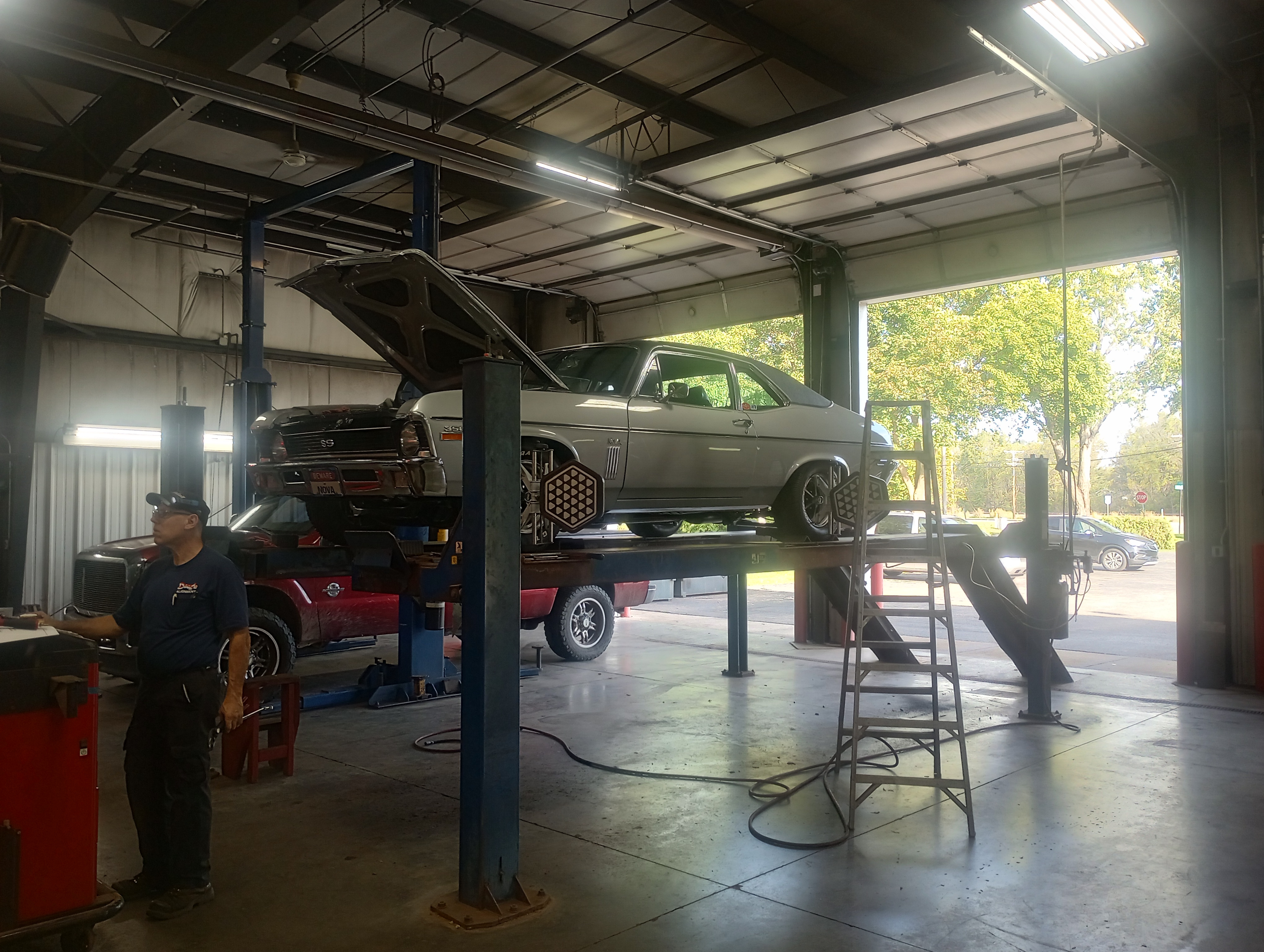

As I posted previously, I finally installed the new RideTech upper A-arms on the Nova, and today finally got it to the shop to get it aligned. I had put almost 100 miles on it after installing them, and the only thing I could notice was a little more pull to the left. I even swapped the front tires side to side, in case that was part or all of the problem, but it made no difference at all. So, I was at the alignment shop at 7:30AM this morning and told them I would wait on it. Initially the caster on the right side was a little better, slightly over 3°, more than the desired 2°. The tech took the A-arm loose and installed the #2 adjuster slugs, which we hoped would bring the caster down closer to 2°. But after they were installed, the caster came out at -3°, 5° more than before. That was the slug with the least offset, so he put the original ones back in and it was back to the starting setting. After some discussion, we decided to that without a slug with only a slight amount of offset would be needed to get to out target, there was nothing more to do. Since the crossbar was bolted to the mount with no shims, which set the camber where it was needed, we couldn't add one at the back and take one out of the front to move the ball joint forward. Finally got out of the shop at 10:30AM and went home. It still has a very slight pull to the left, but it's barely noticeable unless you're on a flat, level road, of which there are few around here.
I took the trim rings off before I went to the shop, and I kind of liked the look of the painted rims, looks a little more retro, I guess, but I put them back on when I got back.
The engine and EFI are still getting along, so it's really nice to be able to drive a well mannered car again. Soon, I want to take it to the shop that did all the metal work on it. It's about 80 miles over to San Pierre, so that will be a nice little road trip for the Nova.
Oops, I forgot to attach the picture of the Nova on the alignment rack.

Well, after the last alignment I initially thought the pull to the left was better, but after 50-60 miles of driving it, it was really no better than before. Looking at the right side upper A-arm, the alignment tech had changed the original slugs with no offset to the slugs with 1/4" offset, moving the A-arm to the rear. Also, looking at the printout with the settings on it, the new caster setting was virtually the same as before, which really isn't possible. Also, the bolts on the left A-arm were loosened and not tightened, and I KNOW they were tight after I installed the new A-arms because I double checked the bolts after I finished the installation.
So, I called another local alignment shop that a couple of other gear heads used and recommended. I explained what was going on, and wanted him to take a look at it. I took it to the shop yesterday and dropped it off and he called around noon today and said it was ready to pick up. Went over and talked to him and looked at the printout with the settings, it showed that the caster on the right side was off by ~3°, over 4°, instead of the desired 1.5° to 2°. The tech said he used the same 1/4" offset slugs but turned them 180° moving the A-arm 1/2" forward. He also had to add a couple of shims to the front bolt on the left A-arm to get the caster and camber within spec on that side. He had test driven it and said it goes straight with no pull now, and I said that sounds great as I was tired of having to hold it to the right all the time to keep it in my lane.
On the drive back, it was like driving a different car, it drives better than it ever did before, finally.
Obviously, the first shop has a problem with either their equipment or the operator, or both, as they couldn't get it right when the second shop had no problem adjusting it to get it in spec. Monday, I'm going to give the first shop a call and talk to the shop foreman and let him know that they have a problem and they might want to look into it.
Took it for a drive this evening to make a weekly check on a friend's house and stop at Arby's for a roast beef sandwich on the way back, and it's amazing how much better it drives now.Even the EFI is still behaving!

I talked to the shop foreman at the first alignment shop today, and told him how the second shop had no problem getting the alignment set to specs. He admitted that they have been having problems with their machine, specifically the right front readings on some vehicles. Also, they have been waiting for a new alignment machine for six months, and it is finally being installed now.
